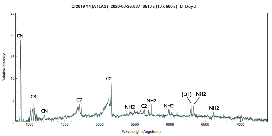

Spectrum taken on March 26 with a LISA spectrograph on a C11 scope. Total exposure 2.2 hrs guiding on the comet. Main emission features identified.

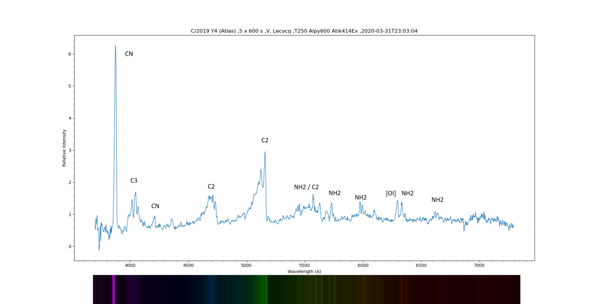

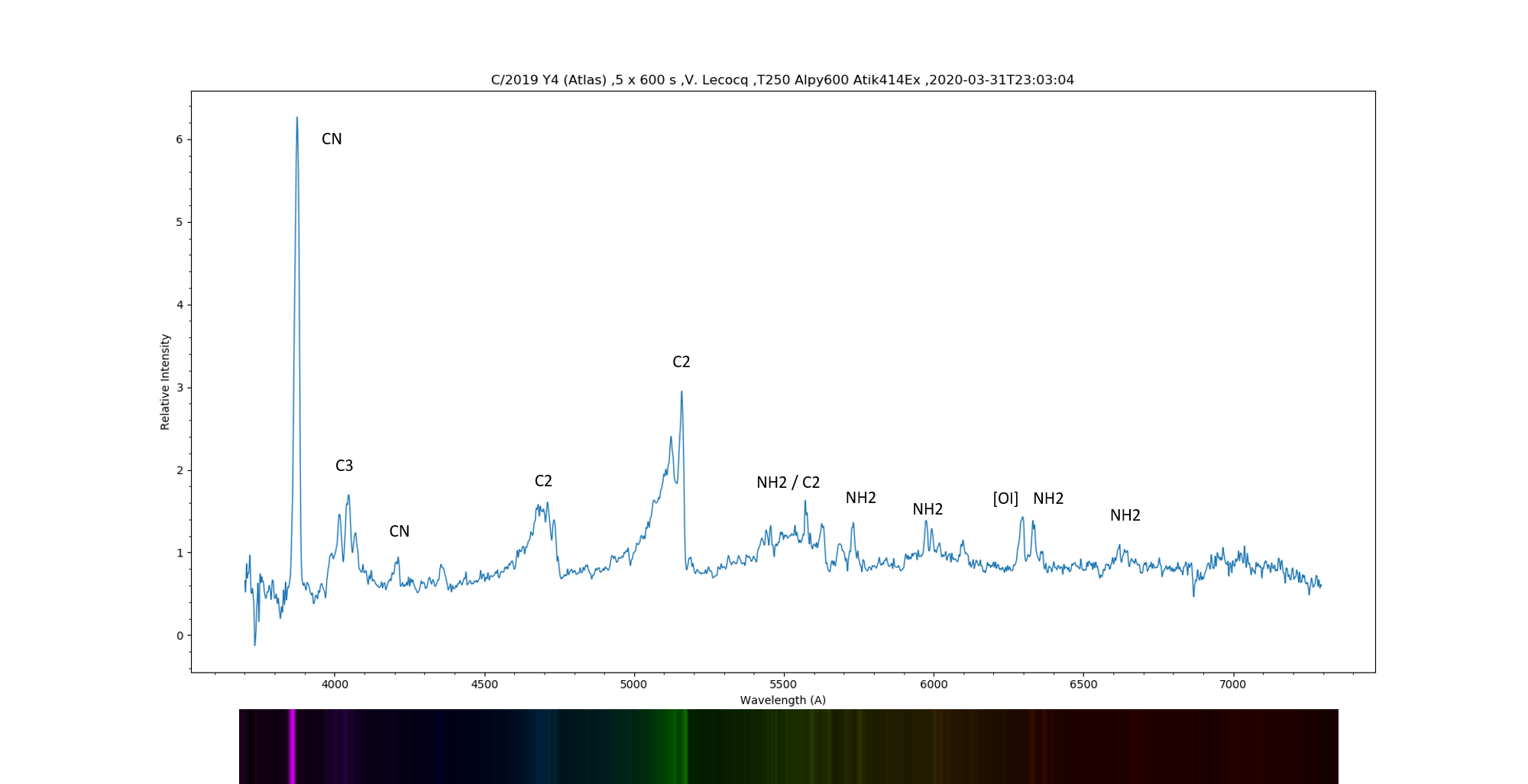

hello,
hereunder a spectrum of this promising comet. Taken with Alpy600 on a T250 Newton telescope, Atik414 as CCD camera. Datas were acquired wtih Prism10, and processed with ISIS, Visual SPec and python scripts.
The emission features are those previously described by David Boyd !
clear skies and take care of you !

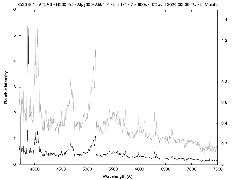

Jolis spectres !
Voici ma contribution.

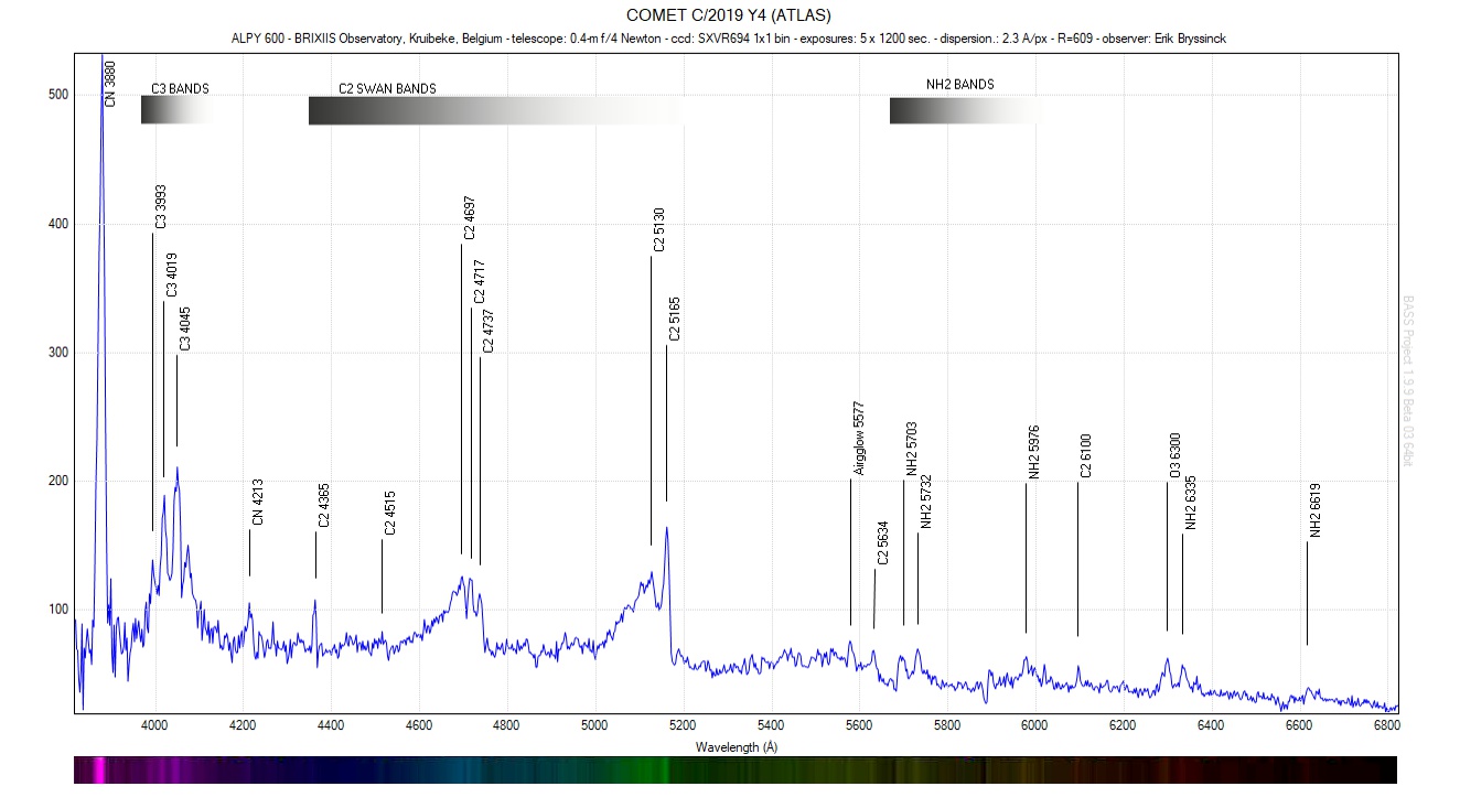

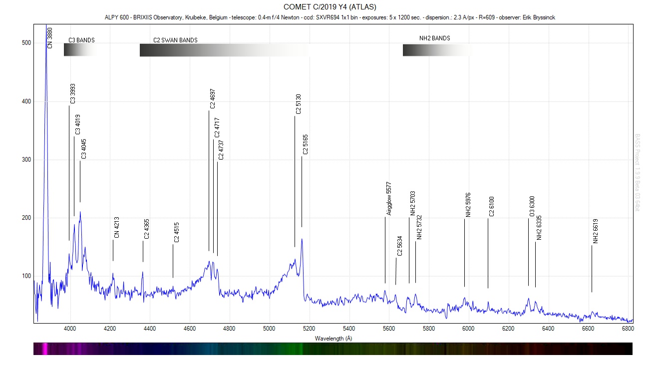

Here my attempt to record the spectrum of comet C/2019 Y4, with an ALPY600. The exposure was 5 x1200 sec. data reduction with BASS software.
