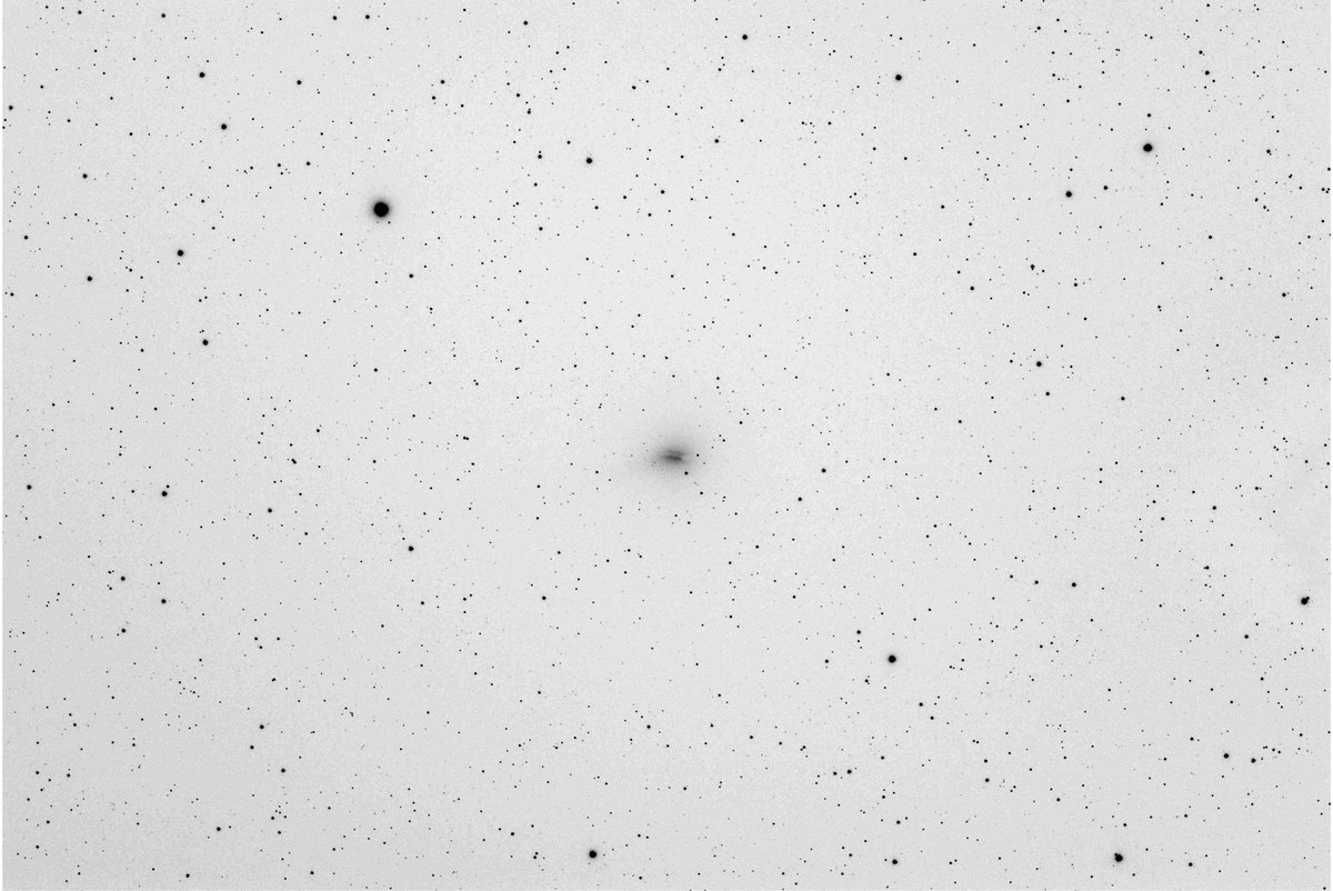

Bonjour à tous

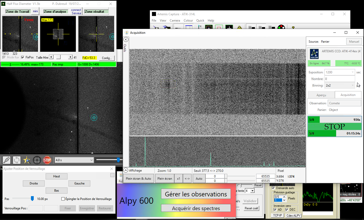

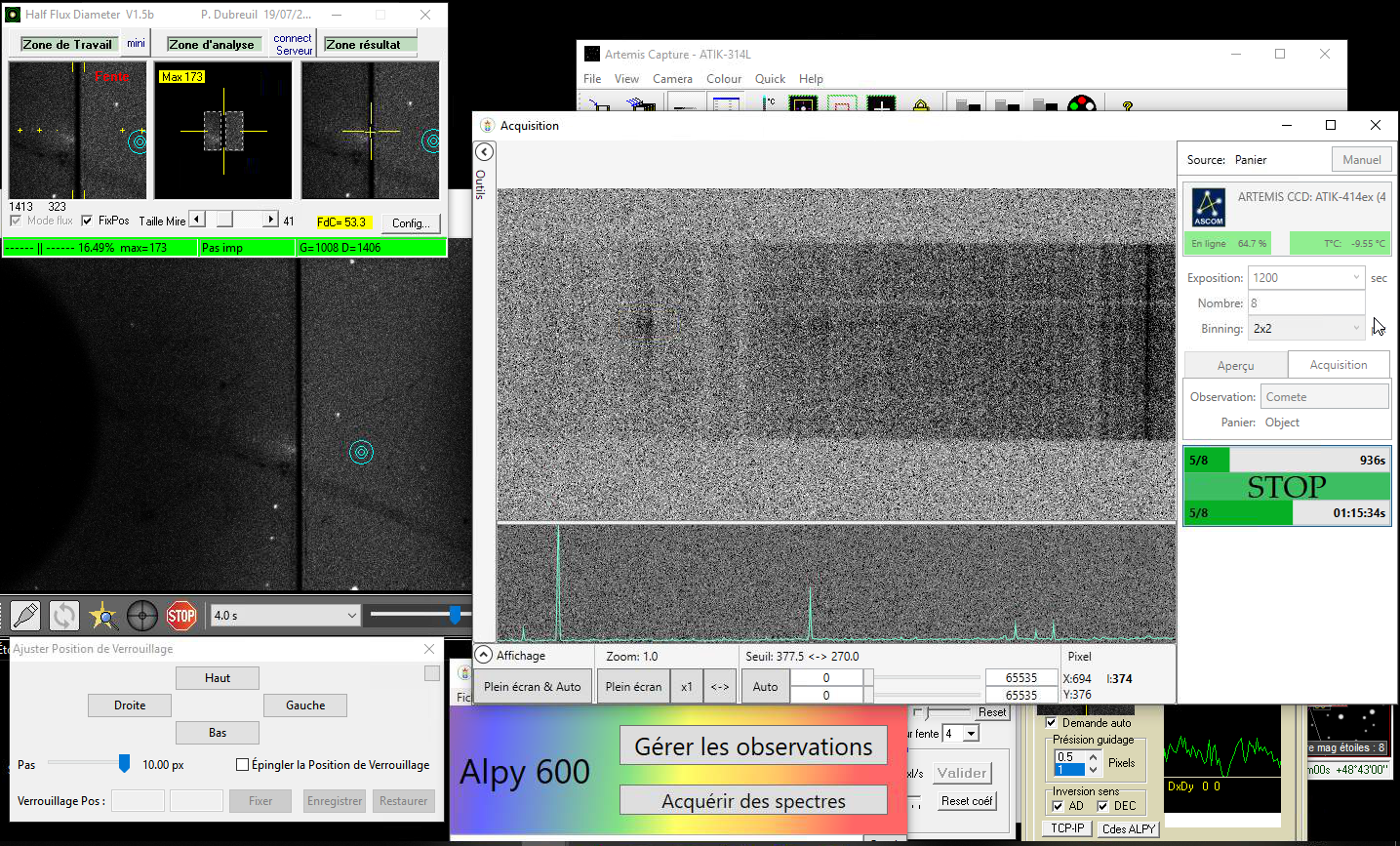

Après une premiere tentative le 4/04 j'ai tenté de nouveau la comète avec aide et remarques de Christian Buil.
Poses de 1200s au lieu de 600s.
Le panneau d'acquisition cette nuit:
acquisitions cette nuit

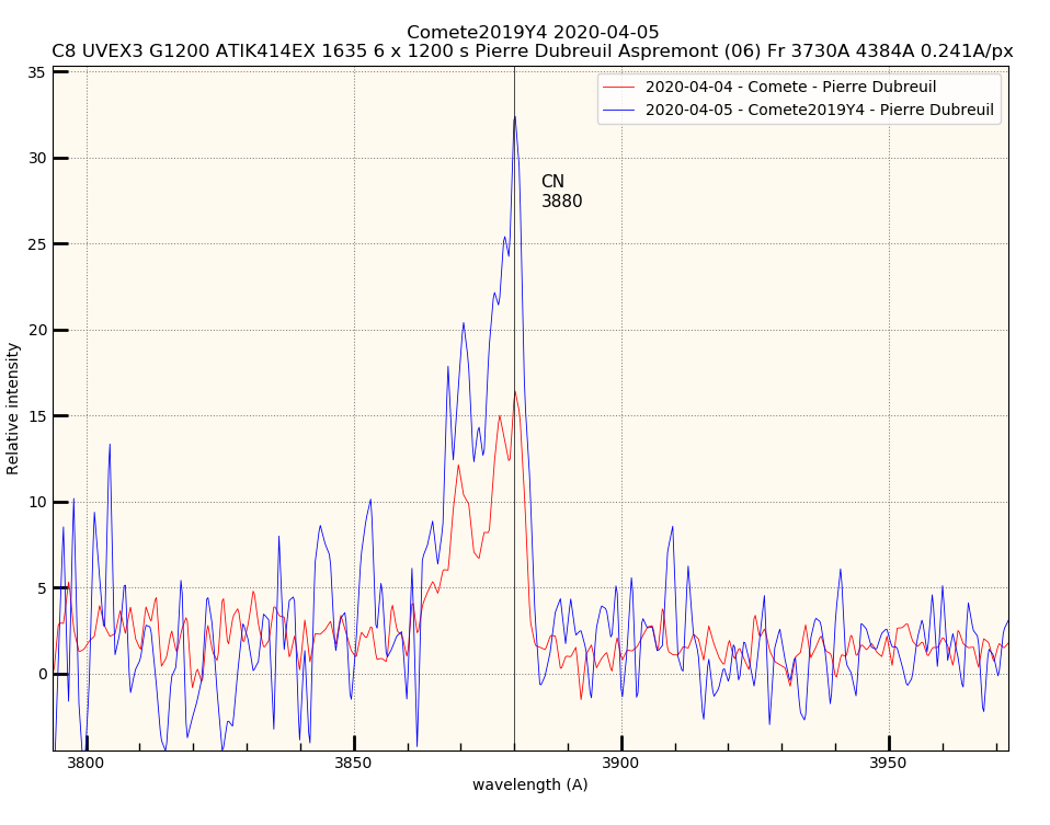

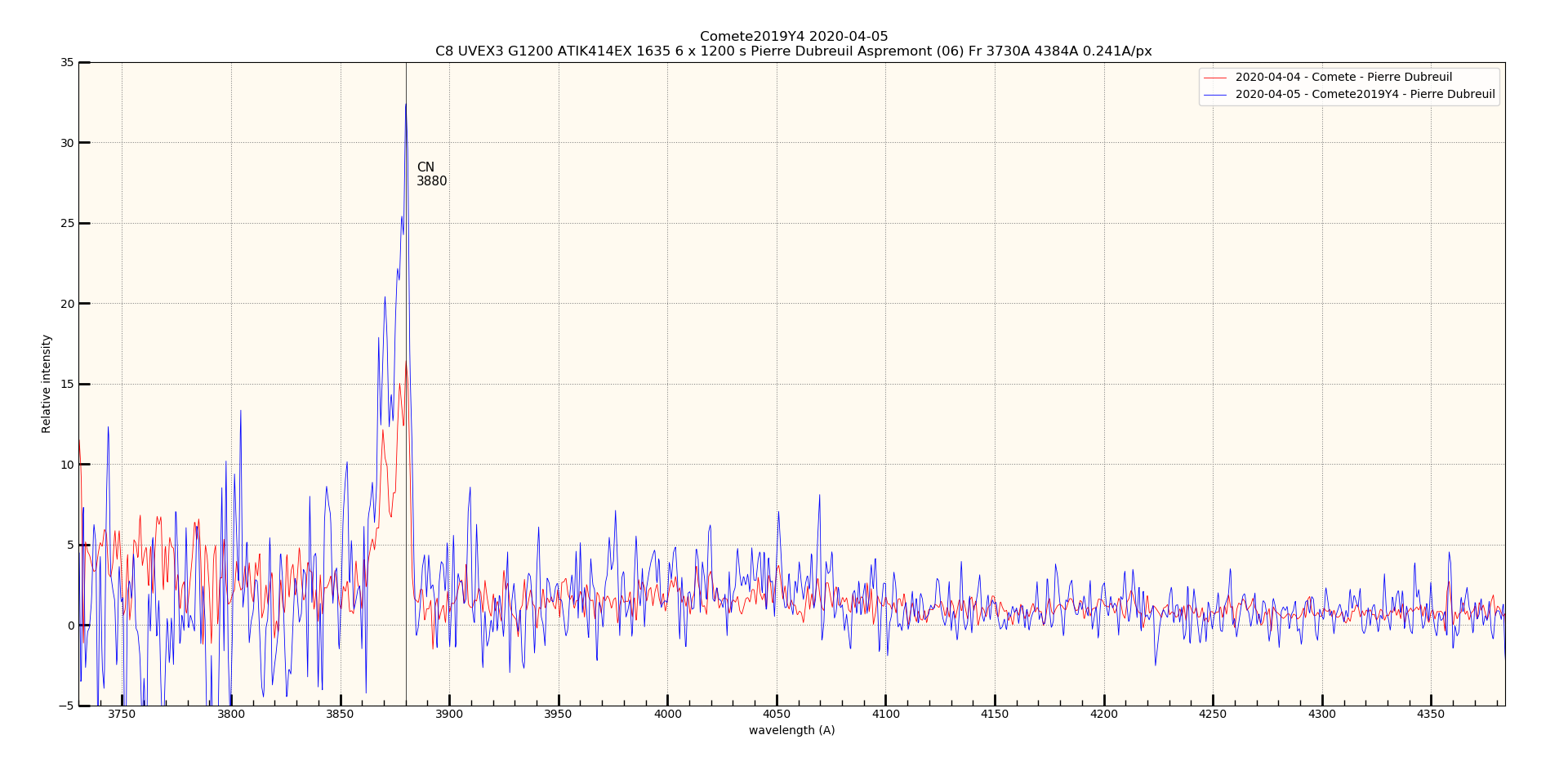

J'ai aussi repris mon soft de guidage sur fente qui m'a enfin permis de guider 2h sans voir la comète sortir de la fente !

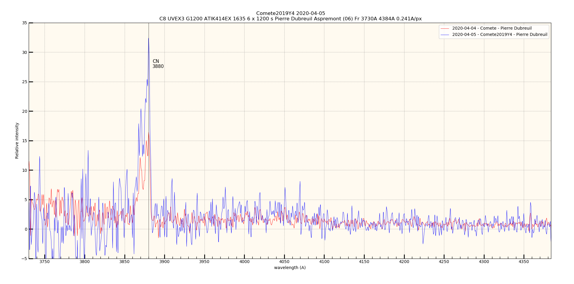

Quelques détails dans la raie 4880 CN mais je n'ai pas les compétences pour l'identification.
La comparaison de deux nuits:
Comete sur 2 nuits
Comete sur 2 nuits
Zoom région Cn 4880:
ZOOM zone CN 4880A
ZOOM zone CN 4880A

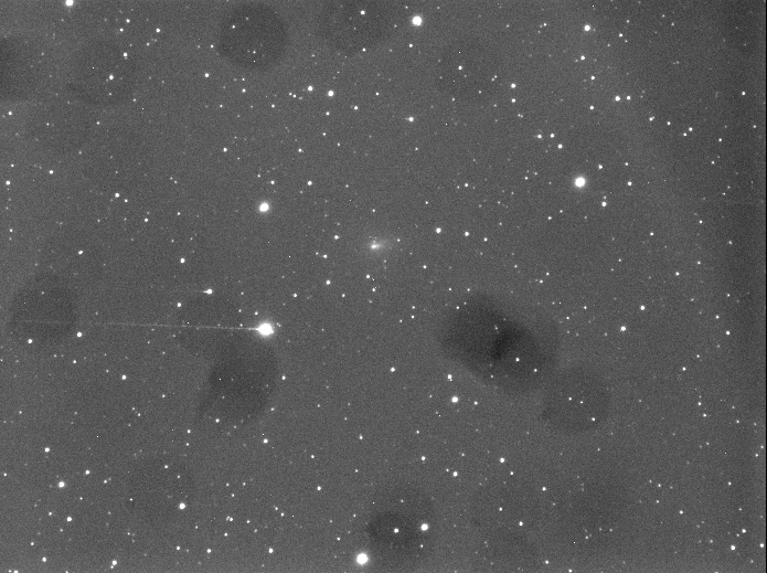

Image 300s avec Lunette chercheur (pour le fun !):
Chercheur
Chercheur
Sacrée comète, très faible pour ma config... !

Pierre, pour t'aider à indentifier les raies, tu as la page de M. Brown:
http://web.gps.caltech.edu/~mbrown/comet/
Using high-resolution spectra obtained with the Hamilton echelle spectrograph at Lick Observatory, we have constructed a catalogue of emission lines observed in comets Swift-Tuttle and Brorsen-Metcalf. The spectra cover the range between 3800 and 9900 A with a spectral resolution of ~ 42000. In the spectra, we catalogue 2997 emission lines of which we identify 2437. We find cometary lines due to H, O, C2, CN, NH2, C3, H2O+, CH, and CH+. We list 559 unidentified lines compiled from the two spectra.
Jean-Pierre

Merci Jean-Pierre pour l'identification. En fait la raie 3880 est large mais que tu CN !

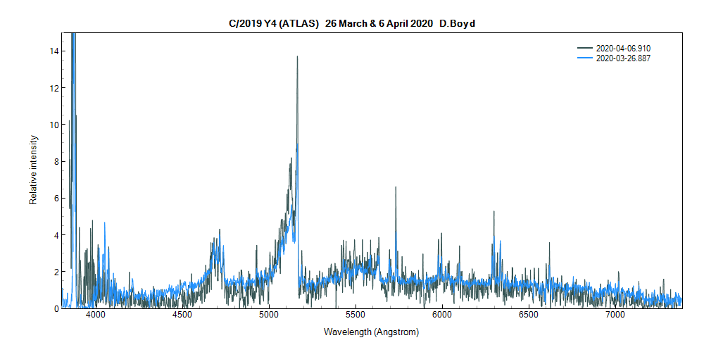

Here is a comparison of two spectra of C/2019 Y4 (ATLAS) taken with a LISA on a C11. These are integrations of 130 and 90 mins respectively. The spectrum on 26 March was taken just before the recent disruption of the comet noted by several observers, the spectrum on 6 April was taken after. Reports indicate that the event has reduced the brightness of the comet by about a magnitude and it has become more diffuse. This was apparent from the increased difficulty in guiding on the comet in the later spectrum. The later spectrum also suffers from greater noise beyond that expected just from the reduced exposure time. However, it appears that the event has not introduced any significant change in the spectral profile of the comet.

Belle comparaison David

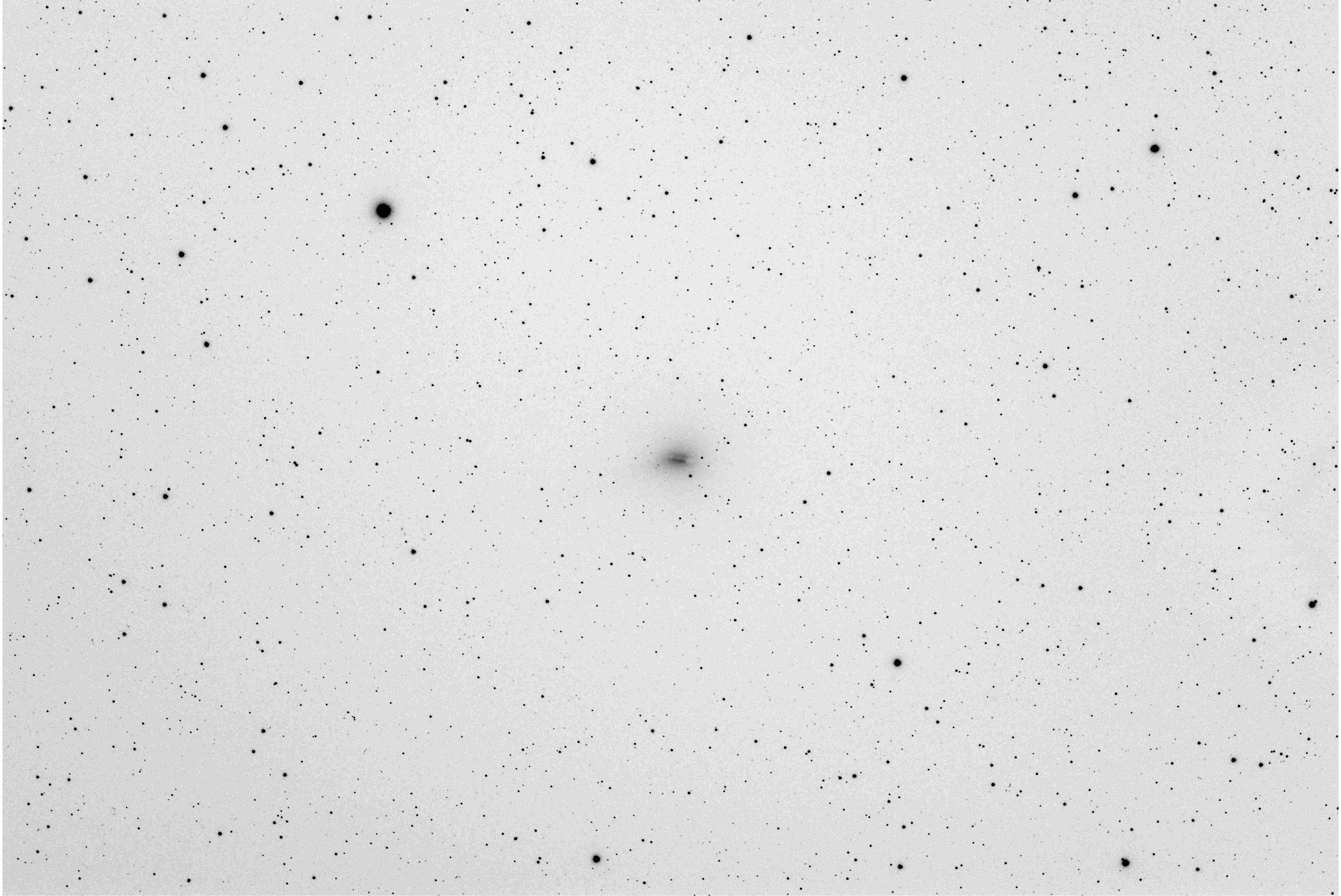

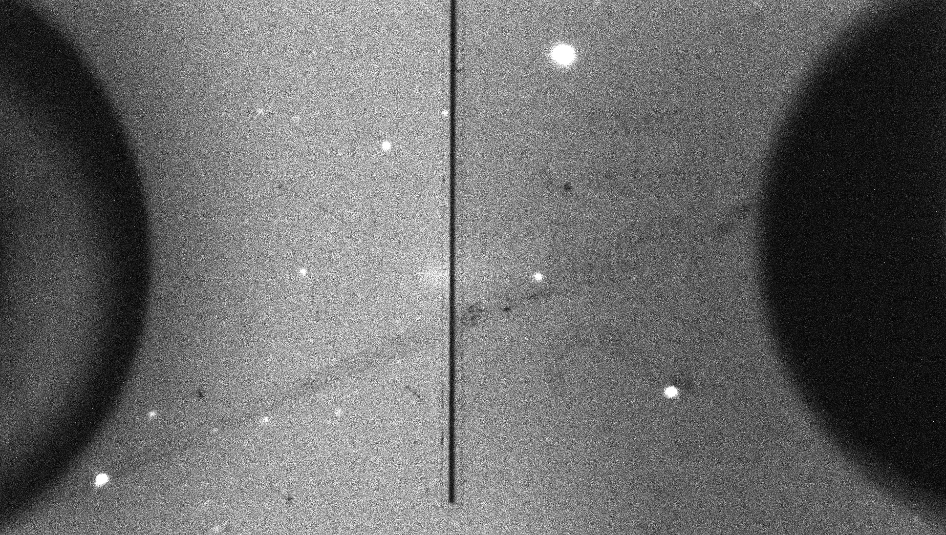

Je confirme que la chute de luminosité est flagrante et il est pratiquement impossible de guider sur le noyau, ce que j'ai essayé de faire à la limite du décrochage, et pas toujours parfaitement ( passage étoiles proches du noyau).

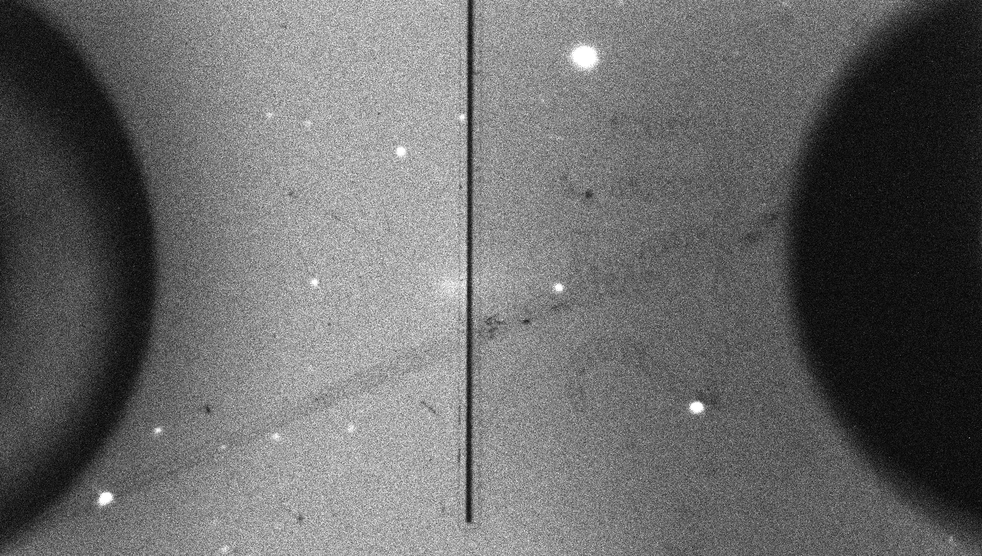

Ci-dessous le champs du capteur de guidage posé 20s gain maxi caméra ZWO290MM. (poses 6s pendant guidage noyau)
champs Guidage 20s
champs Guidage 20s

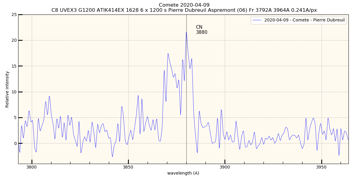

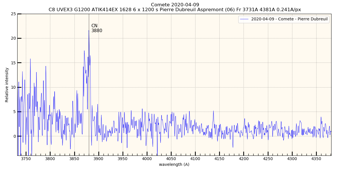

La comète (très bruitée, posée 6x1200s)
comete  6x1200s
comete 6x1200s
Comete_3732 to 4381.png (141.48 KiB) Viewed 9403 times
zoom  3880 A
zoom 3880 A
