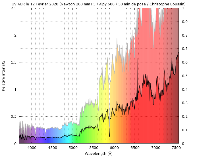

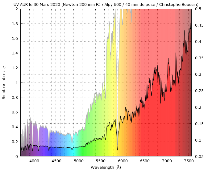

Here is a comparison of two spectra of UV Aur obtained on February 12 (resolution 502, JJ = 2458891.524, 6 exposures of 300 s) and March 30 (resolution 501, JJ = 2458939.3923, 8 exposures of 300 s) with my Alpy 600.
UV Aur on February 12th, 2020
_uvaur_20200212_024_Christophe Boussin_3700_7570.png (92.19 KiB) Viewed 3716 times
UV Aur on March 30th, 2020
_uvaur_20200330_892_Christophe Boussin_3700_7570.png (95.39 KiB) Viewed 3716 times

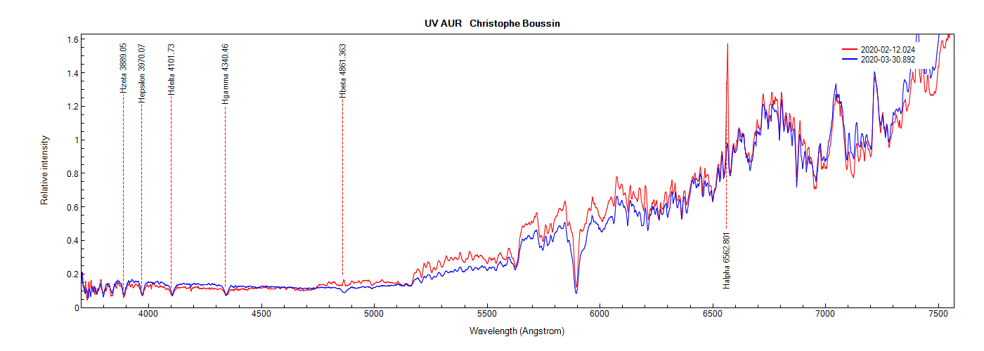

UV Aur on February 12th and March 30th, 2020

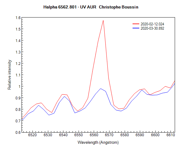

UV Aur on February 12th and March 30th, 2020 (Halpha)
uvaur_20200212_024_Christophe Boussin_Halpha.png (19.34 KiB) Viewed 3719 times

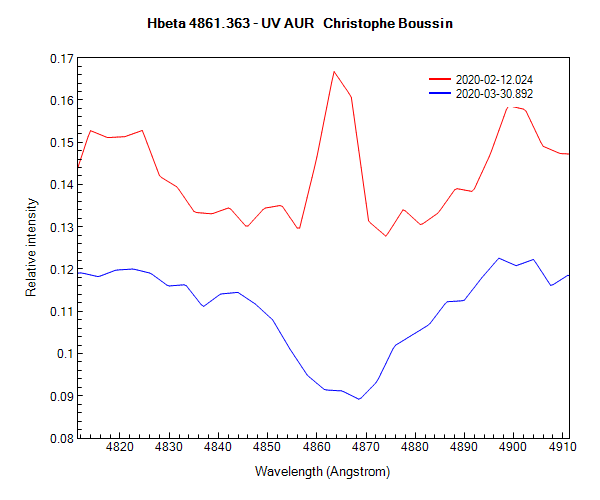

UV Aur on February 12th and March 30th, 2020 (Hbeta)
uvaur_20200212_024_Christophe Boussin_Hbeta.png (18.45 KiB) Viewed 3719 times

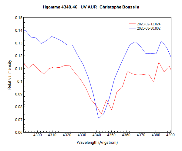

UV Aur on February 12th and March 30th, 2020 (Hgamma)
uvaur_20200212_024_Christophe Boussin_Hgamma.png (19.1 KiB) Viewed 3719 times
We can note the decrease in the relative intensity of the Halpha line as well as the transition to absorption of the Hbeta line and the modification of the Hgamma line.
