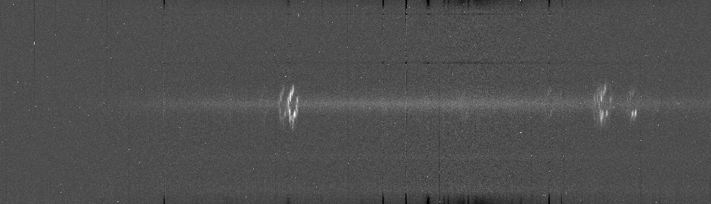

Here SN2012A at V 13.9 :
Also 3C273 (V = 12.5) :

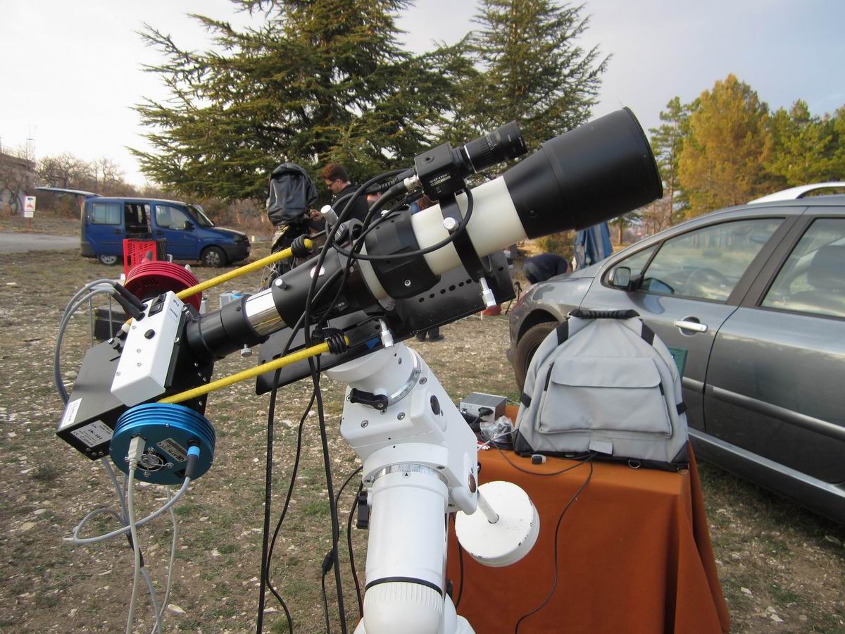

Very similar configuration when traveling: Televue 85mm on a NEQ6 Pro mount with LISA spectrograph. Here is a detailed description of the equipment & software:
* Windows 7 (64bits) computer with ASCOM 6.1 platform and AudeLA 2012.3.12 (two instances run: A1 and A2)
* Mount: NEQ6 Pro with EQ Direct cable controled through EQMOD.Telescope:
-Joystick to move the telescope manually
-Carte du Ciel 3.4.1 for GoTo & star Synchronization (pointing model)
-AudeLA "Autoguiding" module for autoguiding [instance A1]
* electronic Finder:
-75mm F/2 C-mount lens on a Watec 120N+ video camera in parallel to the Televue 85 (alignment made with the mounting ring on a fixed lamp).
-USB2 grabber to digitize the video image on the computer
-AudeLA "Telescope" module to display the image with a cross hair [instance A1]
* Televue85 Optical Tube Assembly with LISA spectrograph:
-Atik Titan guiding camera controled through Atik drivers, ASCOM drivers and then AudeLA "Autoguiding" module [instance A1]
-Atik 314L+ spectra acquisition camera controled through Atik drivers, ASCOM drivers and then AudeLA "Acquisition" module [instance A2]
NEQ6 Pro + TV85 + LISA + Atik
IMG_4277 TV85-LISA-Atik.JPG (205.16 KiB) Viewed 27105 times
I tried a single instance but it was unstable (AudeLA crash) so I switched to two instances of the same software and it seemed to work very well.

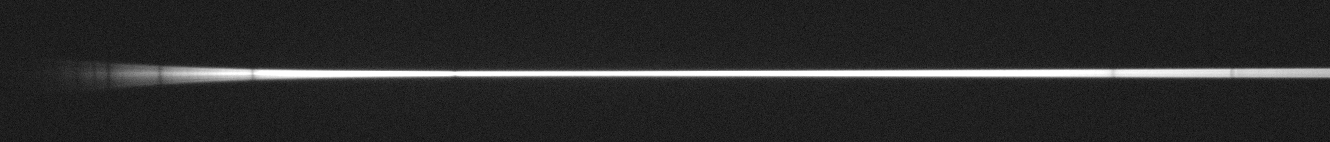

Here is the spectrum of M1:
Spectrum of Messier 1
In summary: excellent 'light' configuration when traveling with some limitation on the magnitude reached out...

Le spectre est très étalé dans le bleu... un peu déçu sur le Televue sur ce coup là... :-)

Here is a picture of my LISA spectrograph with two Atik cameras mounted on a Televue 85mm on a EQ6 mount. An electronic finder look for the field of view.
LISA + TV85 + NEQ6
LISA + TV85 + NEQ6

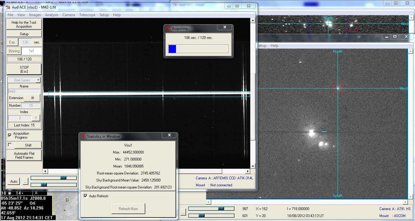

And a screen copy during acquisition of a spectrum of M42. One can see the electronic finder image (top right), the guiding camera field (right) and the spectrum acquisition camera (left)... All is controled in AudeLA open source software.
Screen copy during M42 spectrum acquisition
M42 spectrum is almost saturated in 120sec exposure (85mm refractor)... Note that I have switched to Guide 9 now. Easier for me to GoTo any target; I can add bookmarks (for new nova for exemple); and I can easily point the scope with Guide 9 through ASCOM interface.
