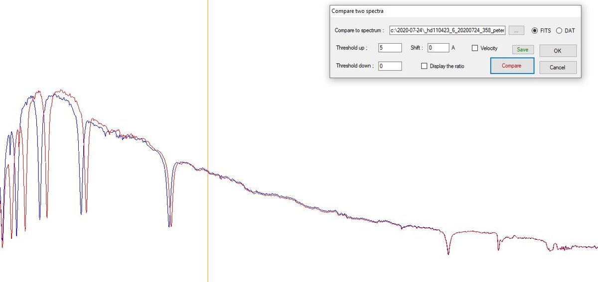

You may have seen my lengthy exchanges on the ISIS subforum about calibration when binning x2. Over the last month I have managed a workaround that provided reasonable calibration results. However I have found that my calibration toward the UV is average at best and generally poor. So I did some experimenting this morning.
A few months back, I realised that ArNe calibration images yielded better results at lower temperatures. So I took some images at an ambient temperature of about 6.5 degrees C and have been using that to calibrate all of my images irrespective of the temp at the time of imaging. I also trimmed my .lst file to the essentials to achieve a reasonable fit. My file reads:
3
3.63
4158.59
4200.67
5849.07
5944.83
6143.06
6266.49
6334.43
6506.53
6965.43
7067.22
7272.93
I achieve an RMS of between 0.12 and 0.25 with this set up. I did this partly because the internet switch I was using to operate the calibration lamp was not working.
This week I managed to get the internet switch working - I have been taking Ar Ne images immediately before taking my reference star and target images. As the LISA is sensitive to temperature, I reasoned that if the focus was out due to the temperature, the effect should be the same for the calibration and reference/target images.
However, comparing spectrum calibrated with Ar Ne images taken at ambient to those using the stock 6.5C frames, I see a big difference in results. At around 3900A, the difference is around 25A. I've attached a screen shot comparing the 2 in ISIS. All reduction and processing steps were identical except for the calibration frames used. Interestingly, the RMS reported for both were broadly consistent - about 0.2. Comparing the images to a synthetic Pickles spectrum, its clear that the spectrum using the 6.5C frame is much better.
I suspect my focus is slightly out. I can adjust that (with the assistance of the on-site observatory technician). And I think I should do that when the temp is cold - to be closer to the ambient temperature when imaging. That said, it seems odd to me to refine my focus to match temp that in fact may be lower than the ambient when I am imaging.
My question is whether it is as simple as this or am I missing something?
Is part of the issue the fact that I have so few lines to calibrate with above 5800A?
If it is, would I be better served by changing back to the old Ne bulb and then using the two step calibration in ISIS using an A0 star?
I accept that the LISA is challenged at the UV end of its range - and the UVEX should be a much better unit at shorter wavelengths. I'm interested in hearing about the experience of other LISA users.
Also, has anyone successfully rigged up a motor to adjust the LISA focus remotely? I see that Shelyak are looking to incorporate this in the commercial UVEX unit. I suspect that there are space constraints.
Pete
