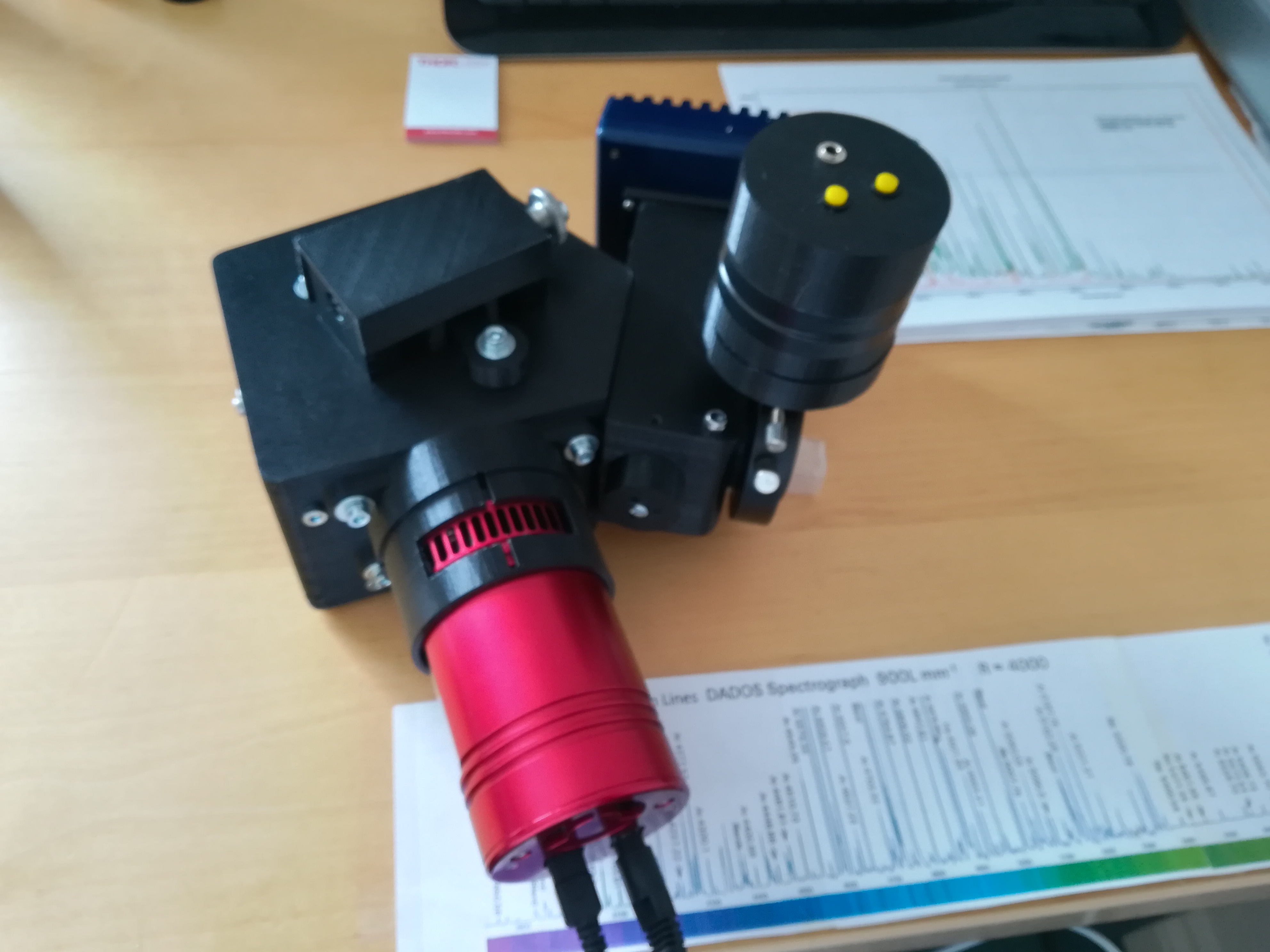

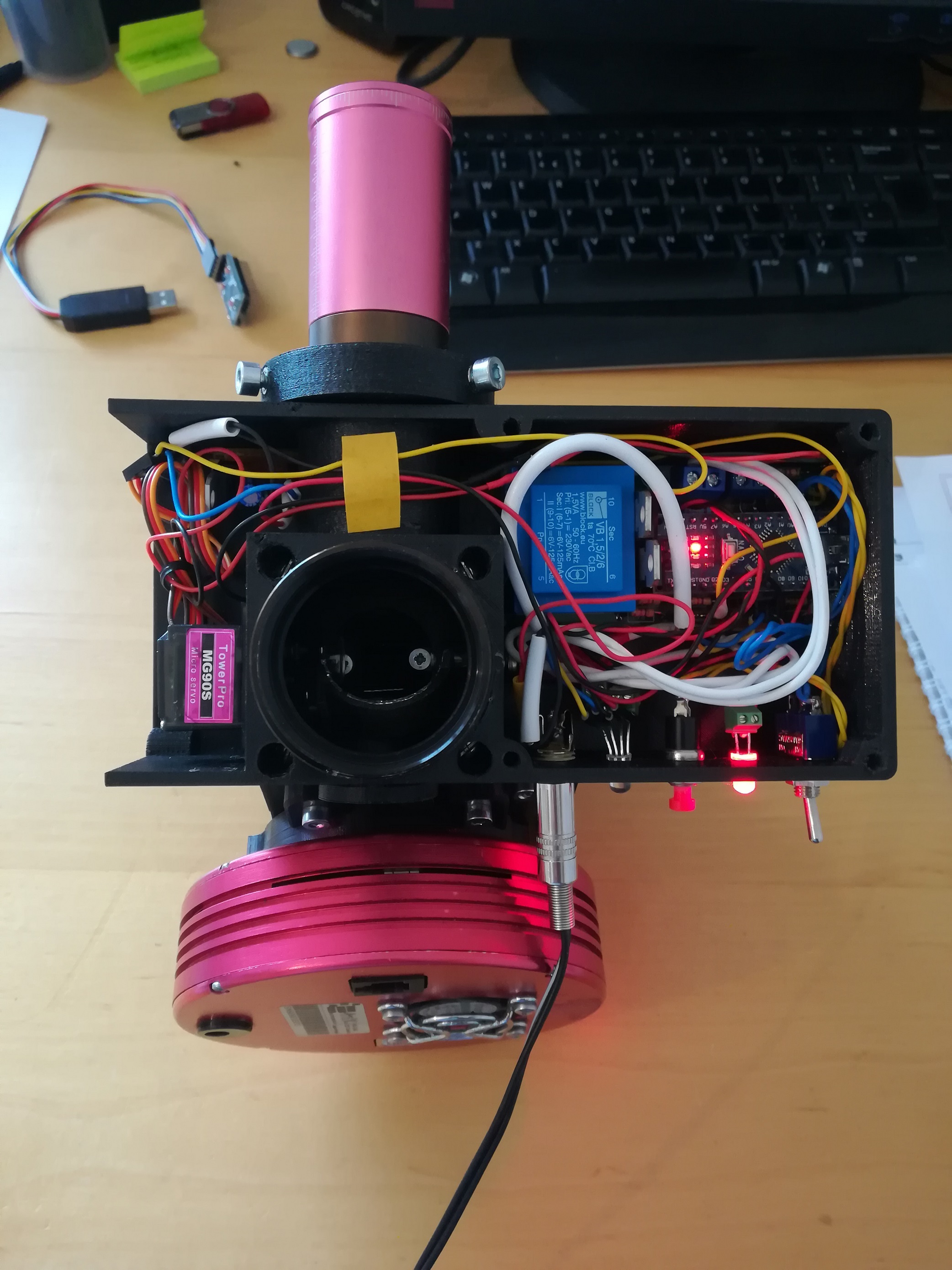

Hi Guys,

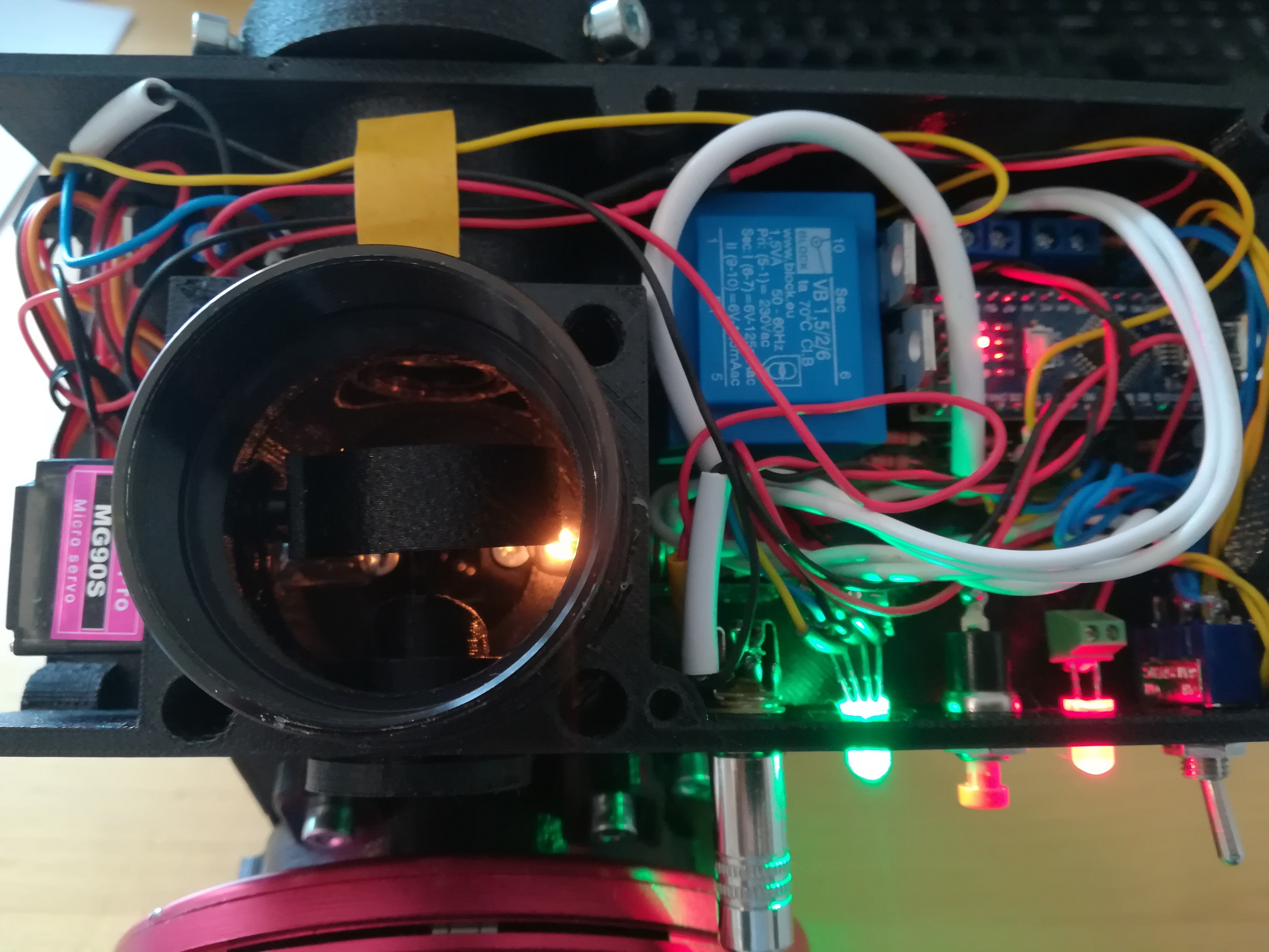

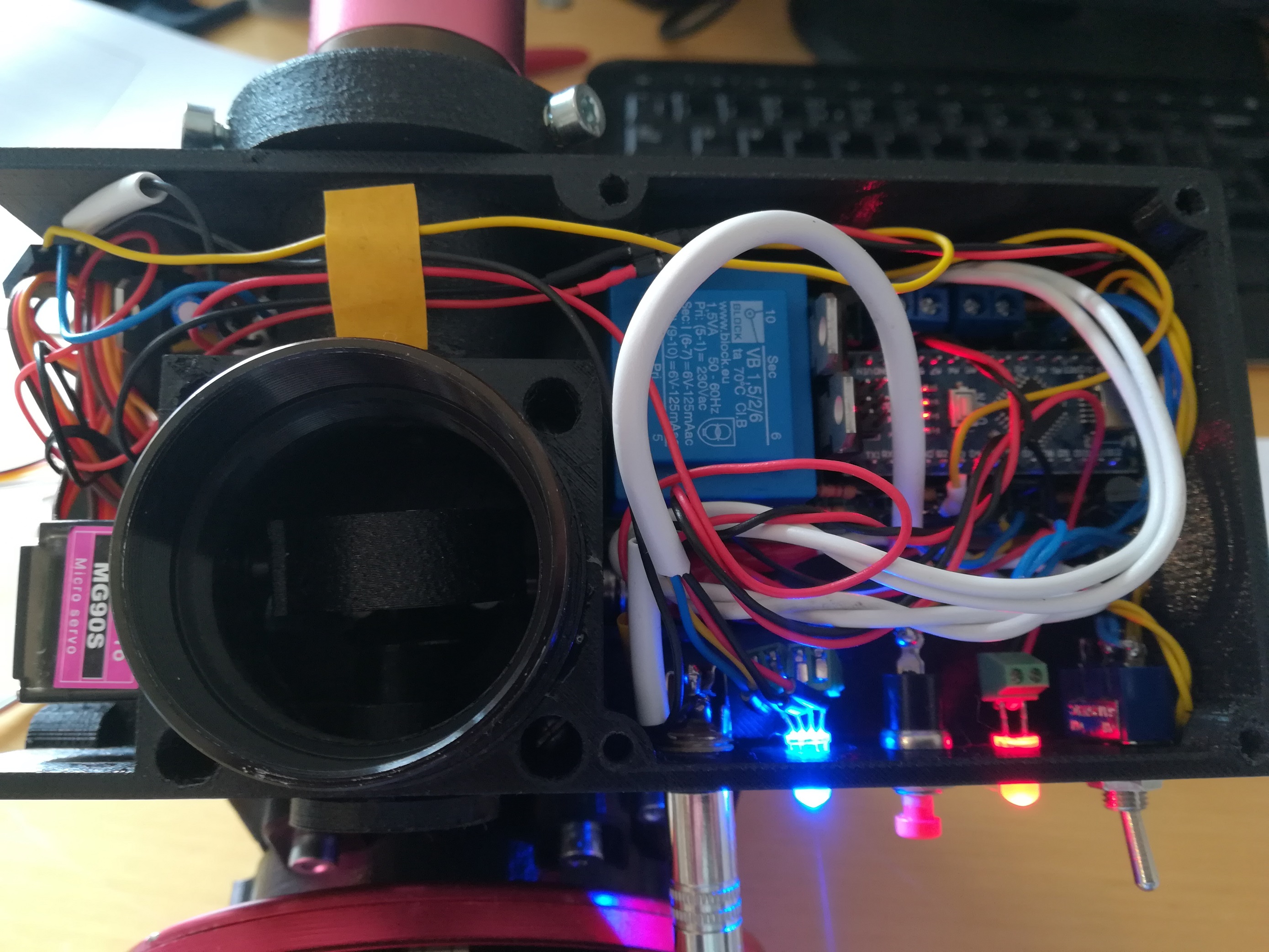

The photos below shows my UVEX3 and Calibrex guiding/calibration unit.
It works astonishingly well.

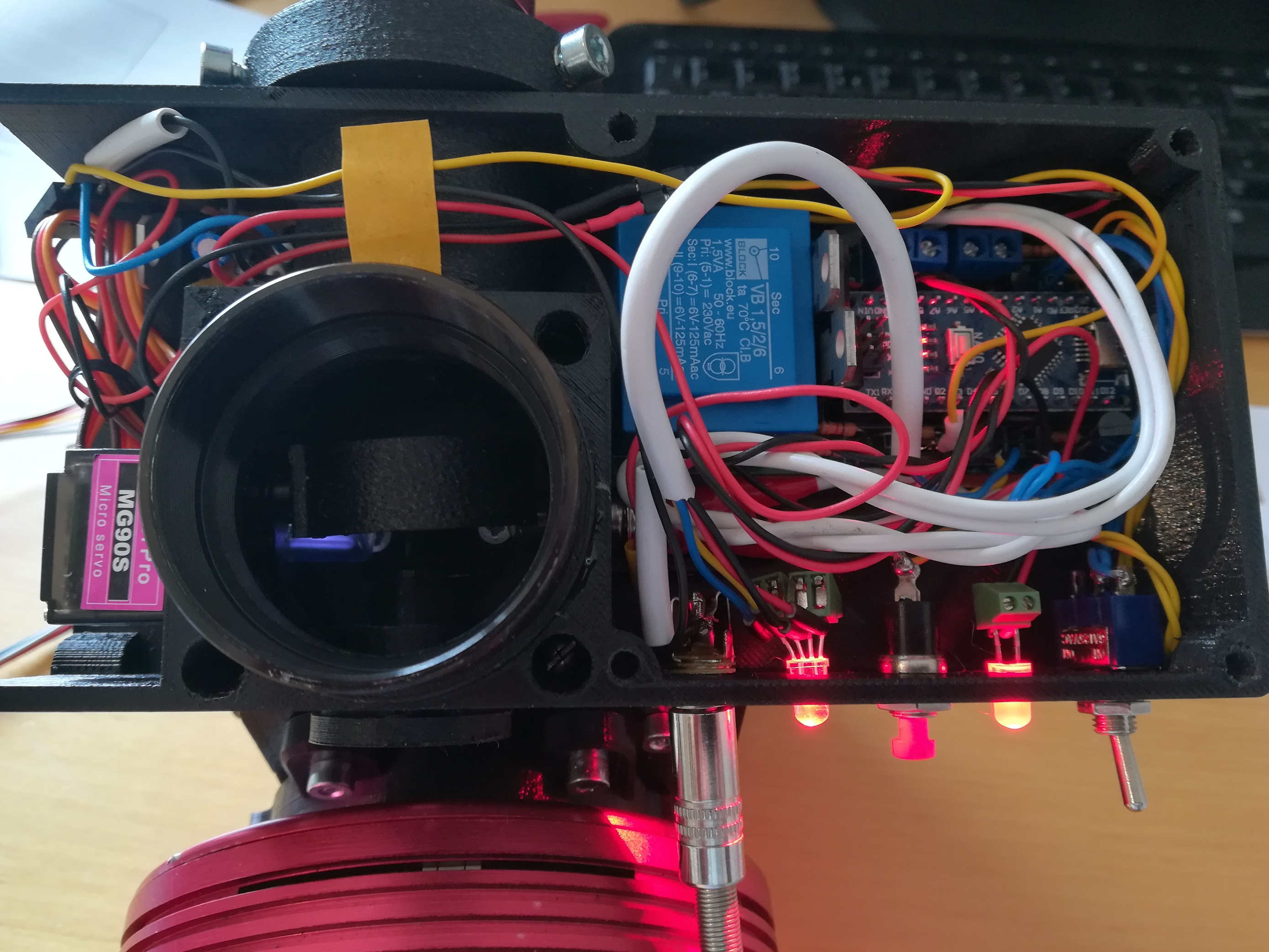

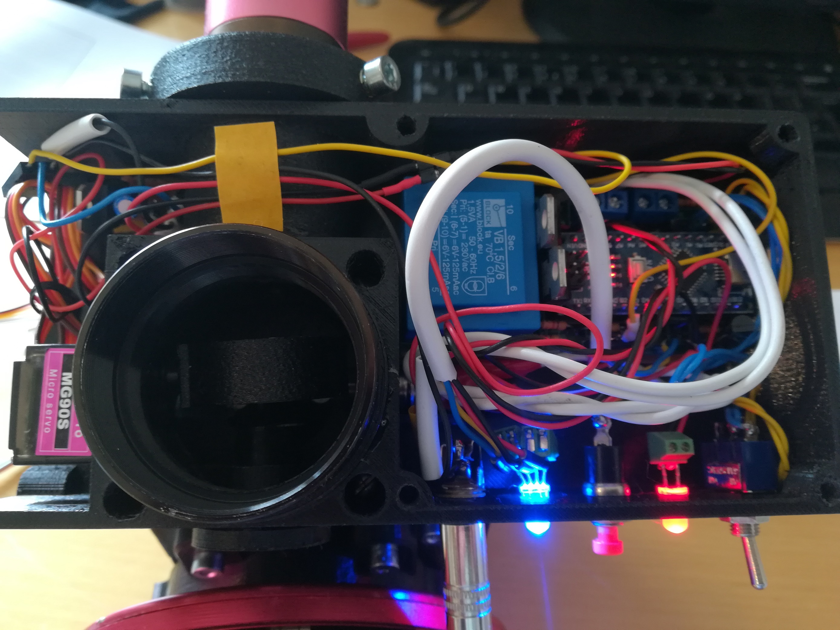

A few mods of course (!). Two x 50mm focal length doublets in the guider for better quality images, a Shelyak photometric slit used instead of the Alpy and a "larger" servo power board for stronger action. Otherwise it's the Nano control board as specified. I've added a 314L camera holder for the UVEX with multiple anchor points.
The photos show the calibration unit with the top removed and running the sequence of Wavelength, Flat and Dark/Bias frames.
I have Nano boards with bluetooth and wifi and paln to operate this wirelessly.
Thanks you for a most interesting project!
Kind Regards
Tony

How did you modify the slit holder to take the photometric slit?
I have a spare LISA slit but it is much larger than the holder. I may make a holder out of aluminium to accommodate the larger slit.
Terry
Terry Bohlsen
Armidale NSW
Australia
Tony Rodda
Posts: 25
Joined: Tue Mar 07, 2017 5:35 pm
Re: UVEX3/CALIBREXV2
Post by Tony Rodda »
Hi Terry,
the photmetric slit is virtually the same mount/position as the Alpy air-spaced 'wheel'. They're interchangeable.
I might be wrong but it'll be very difficult to shoe-horn anything else in there!
The dimensions of slit-mirror-guide lens distances are very tight and you'll be hard pressed to keep collimation tolerances on the other side in the UVEX. The collimation mirror focuses within a millimetre!
I originally built the UVEX2 with the guide unit from the front half of Paul Gerlach's LowSpec last year plus my own designed calibration unit.
It worked well but, again, I was constrained by the UVEX dimensions/optics and not the guider.
Hope this helps.

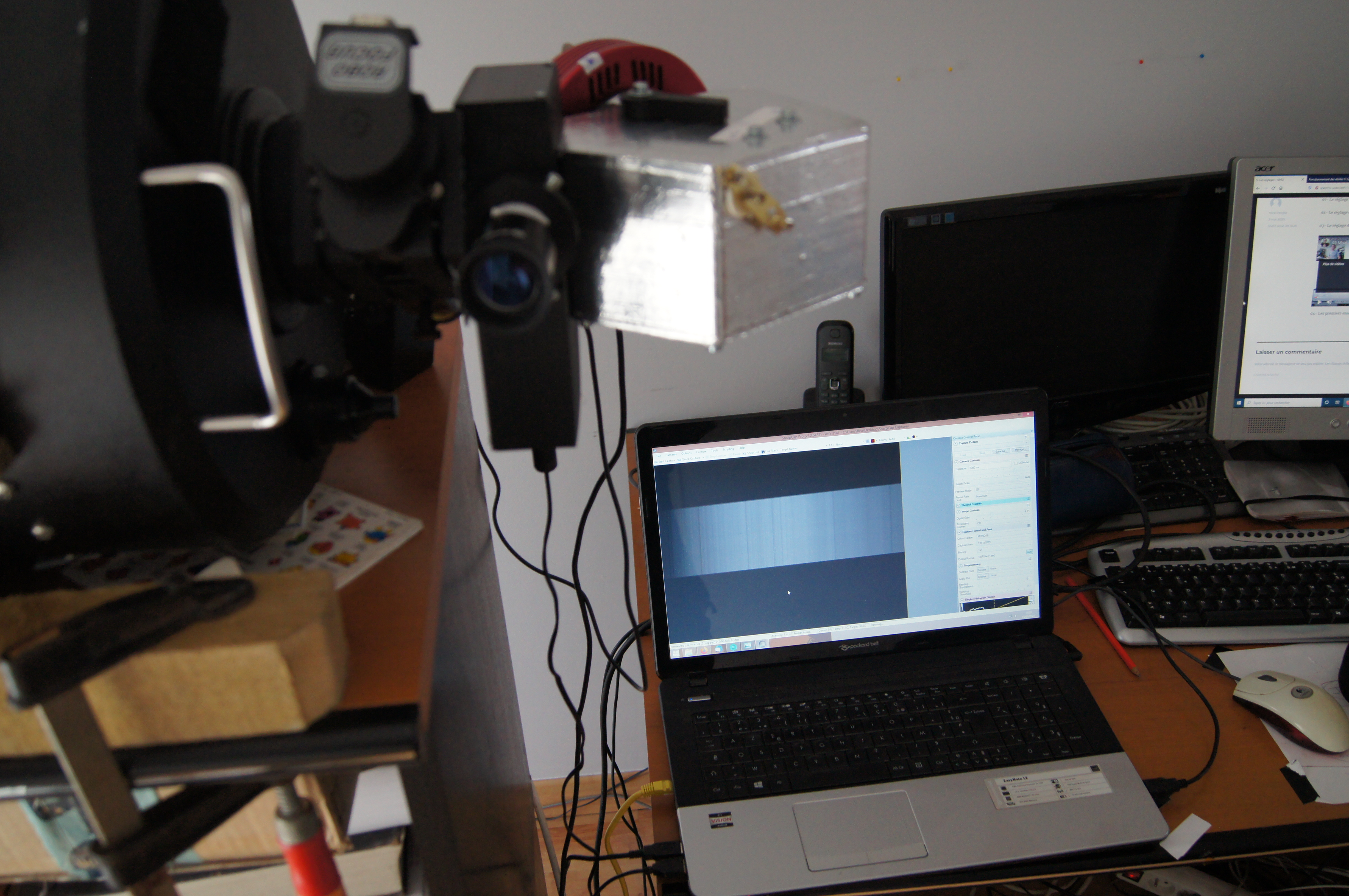

AG Peg with the UVEX3/Calibrex. Not yet quite happy with the screen placement for Flats but I'm close to getting that sorted.
AG Peg.png (61.21 KiB) Viewed 10912 times

PS guys...
The LEDs are very bright! I could read my street's signs when taking dark frames with the blue LED illuminated.
Is this a fault with the LEDs I bought or have you experienced the same thing?
I think they may need to be attenuated.
Regards
Tony

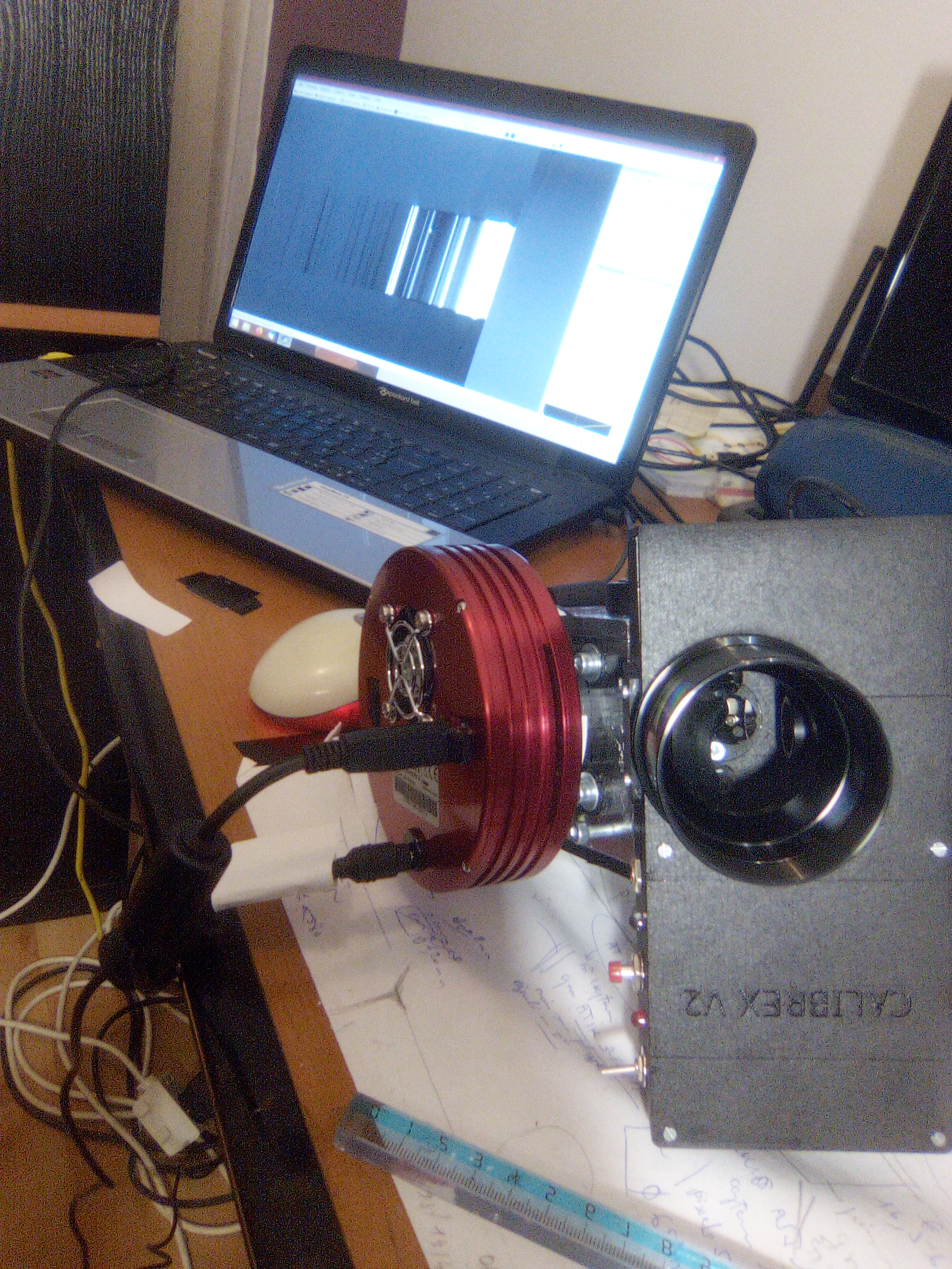

Uvex3/Calibrex sur C11
Bonjour Stéphane,
Après avoir trouvé une ATIK 314L+, j'ai fait (après réglages) quelques premiers essais de spectres de l'UVEX3/Calibrex derrière un C11, sur table sur le soleil, en suivant les conseils de ta vidéo concernant la mise au point de la caméra.
Comme j'ai quelques doutes sur les résultats que j'obtiens après traitement sous ISIS, je voudrais accéder à des spectres de référence et si possible pour un objet donné, à une série d'images (pour vraiment partir sur de bonnes bases pour les traitements sous ISIS).
Pour ces raisons j'ai essayé plusieurs fois de me connecter à la base de données UVEX via l'onglet "traitement" du site UVEX, mais à chaque fois j'ai un refus avec Firefox+Windows8("La connexion a échoué Firefox ne peut établir de connexion avec le serveur à l’adresse uvex30.synology.me:8866."). J'ai essayé aussi avec Chrome et en changeant d'OS (Windows10 et Xubuntu), mais le résultat est le même....
Pourrais-tu m'aider ?
En te remerciant par avance.
Michel TASSE
