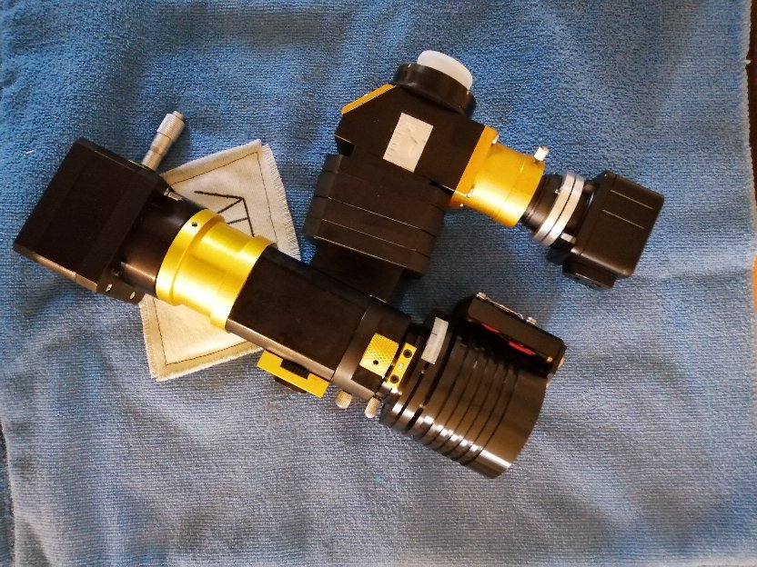

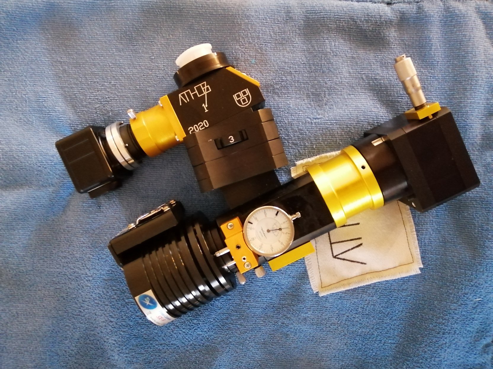

Bonjour a tous,

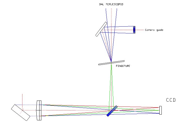

nous avons enfin terminé la construction de notre spectrographe. Je joins quelques photos du projet et de l'instrument. Ses caractéristiques sont:
Type Littrow
reseau 2400 lignes/mm
Distance focale de l'objectif 185 mm
fentes jeton de Jeulin.
Merci pour votre attention cordialement.

Many thanks, I am honored for this appreciation from You,
yes, some blocks are made on a CNC milling machine (even the homemade one), others are made on traditional machines in my hobbyist workshop.
Even the anodizing and coloring was done in-house with simple equipment.

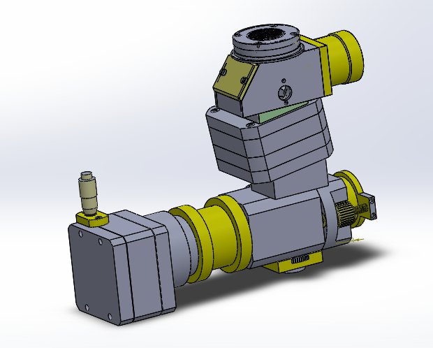

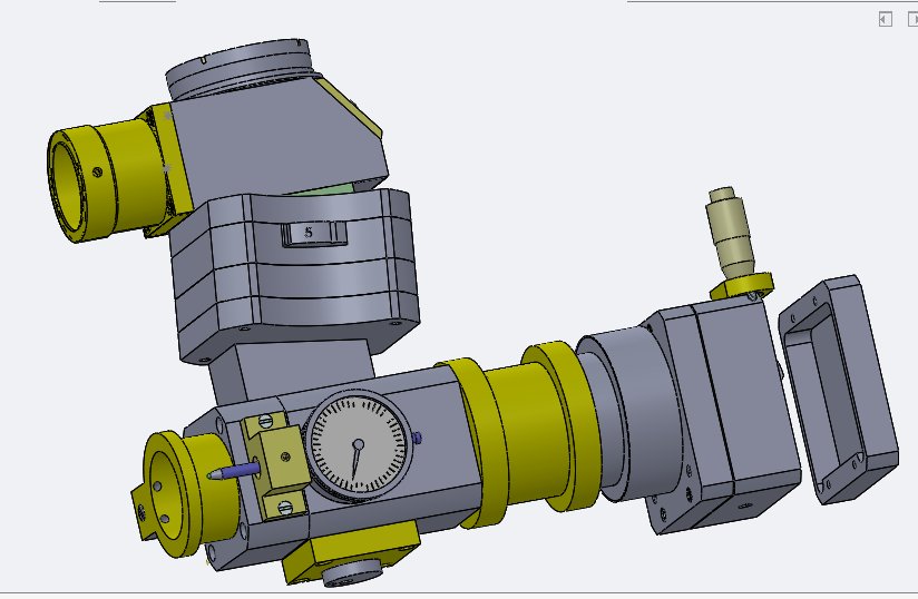

I have prepared a special seat for the reference neon: it is the hole that can be seen in the second image of the project.
We hope for good results.
