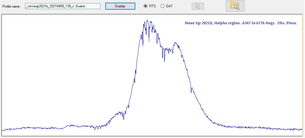

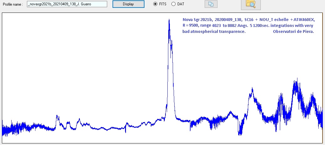

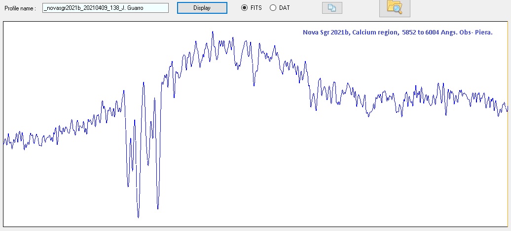

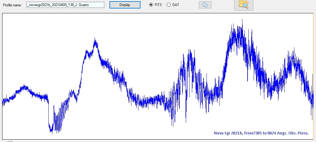

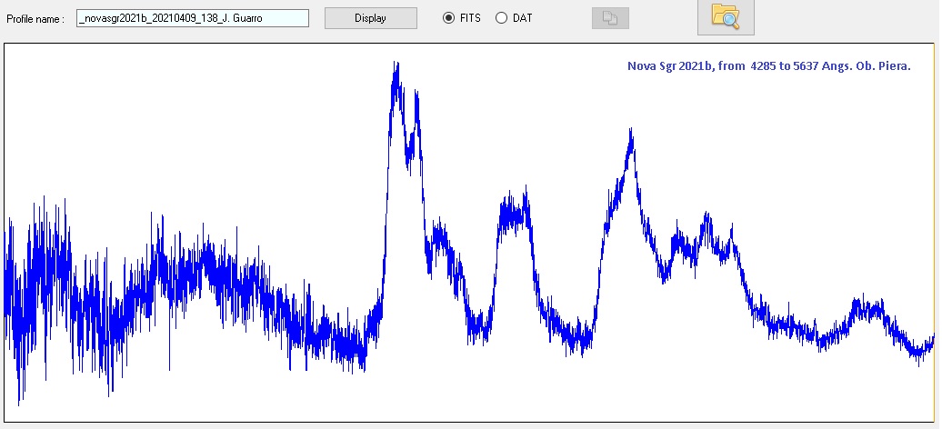

With not more good conditions I I have observer Nova Sgr 2021b this last morning.
Those are the results, it seems this spectra show an evolution from the first that we can see in the François' message.
Cheers, J.Guarro.
Cheers, J.Guarro.

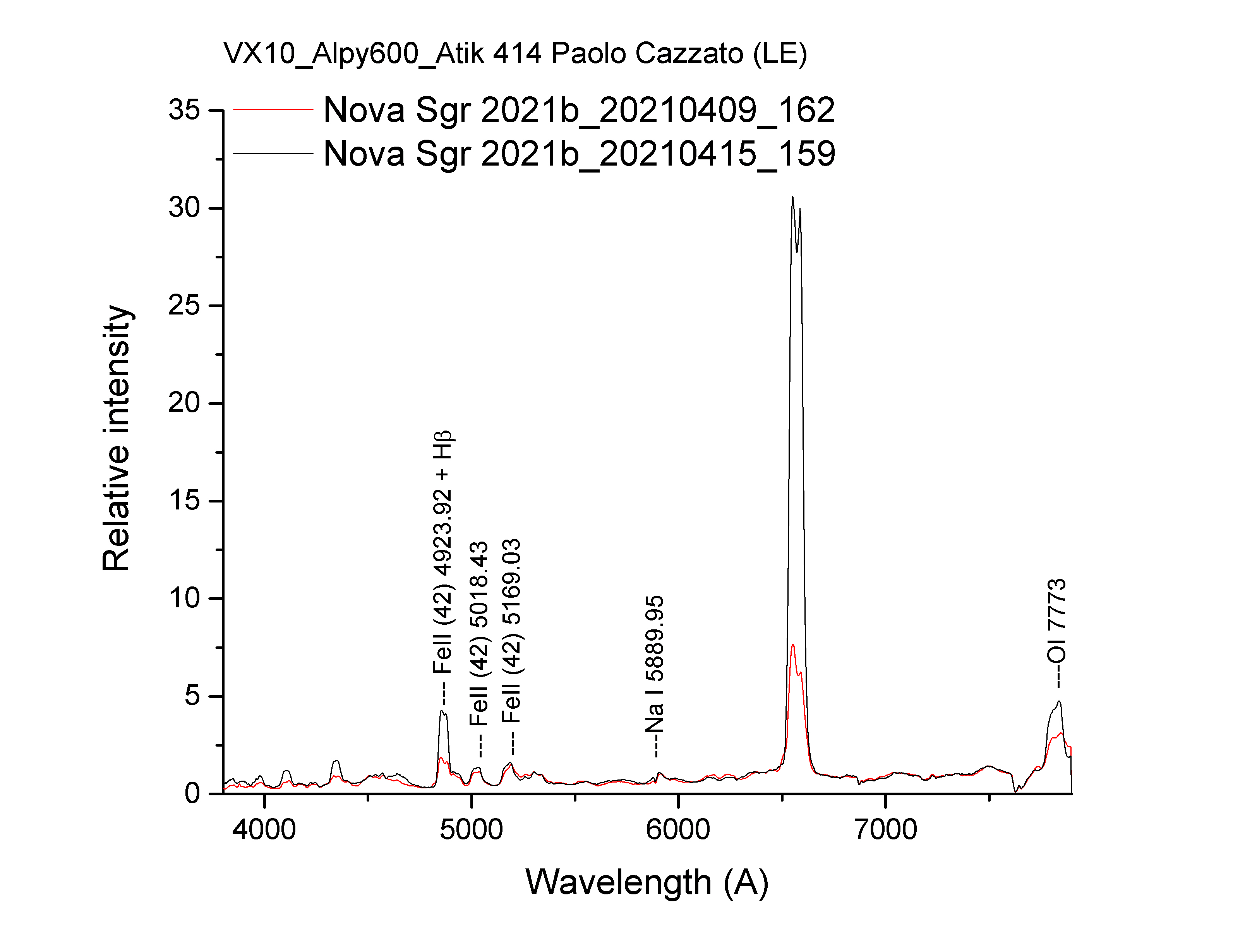

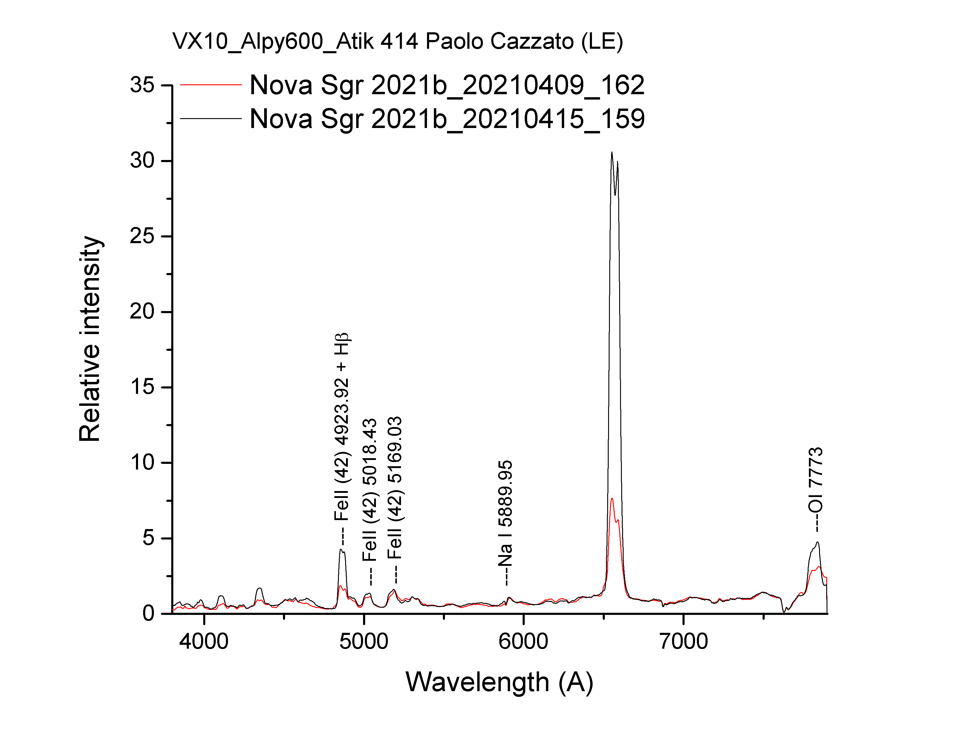

Paolo Cazzato
- Posts: 7
- Joined: Sat Nov 14, 2015 10:58 am
Re: Nova Sgr 2021b - Second nova of the year in Sgr

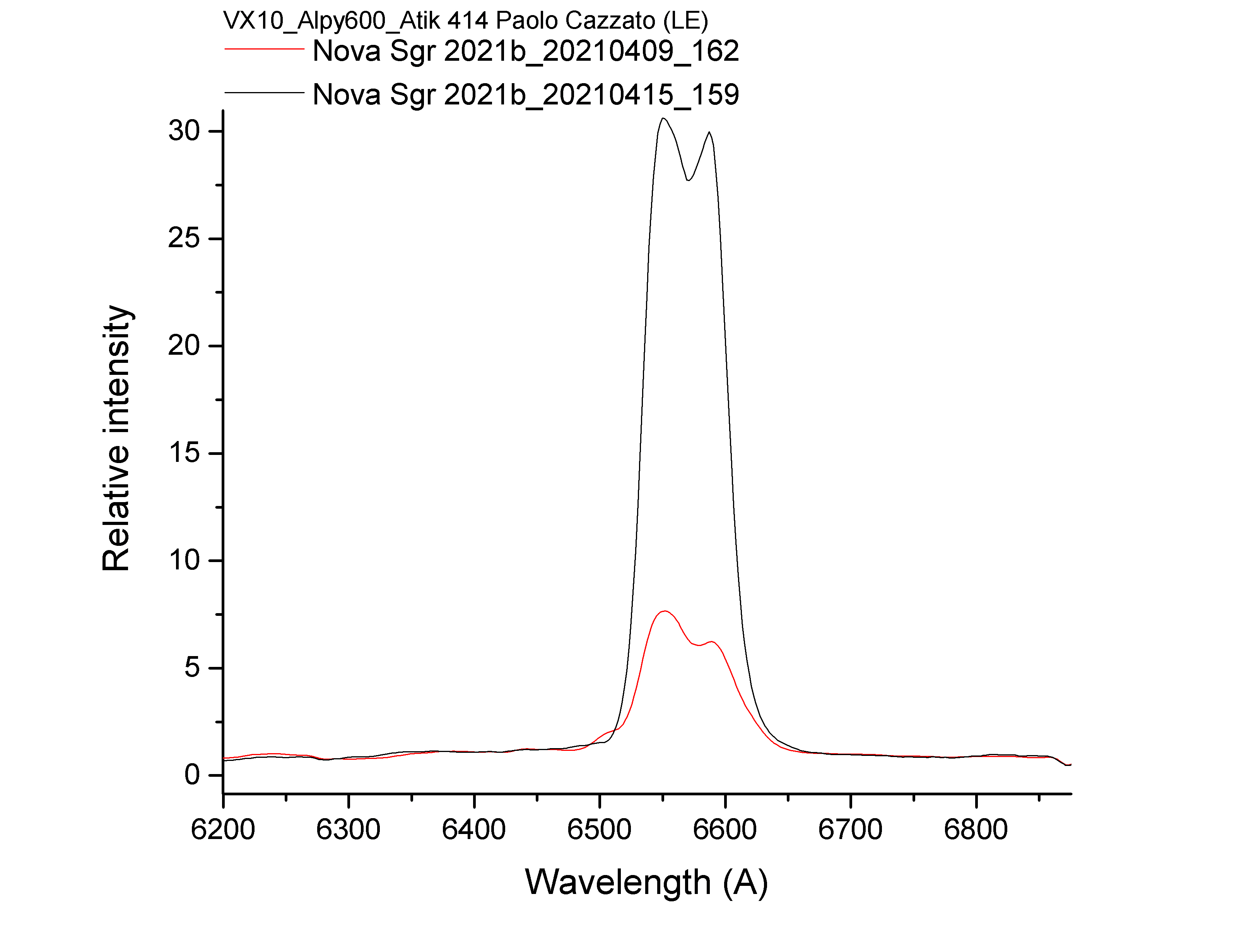

Hallo everybody,
here my comparison at low resolution of this Nova taken from 3800A to 7900A. At low resolution I noticed an incrase of the basic lines and a splitting of the h alpha line. I also noticed an incrise of the OI (?) line at the extreme end of the spectrum. Would it be possible an overlap of the Mg line at 7890A in your opinion?
