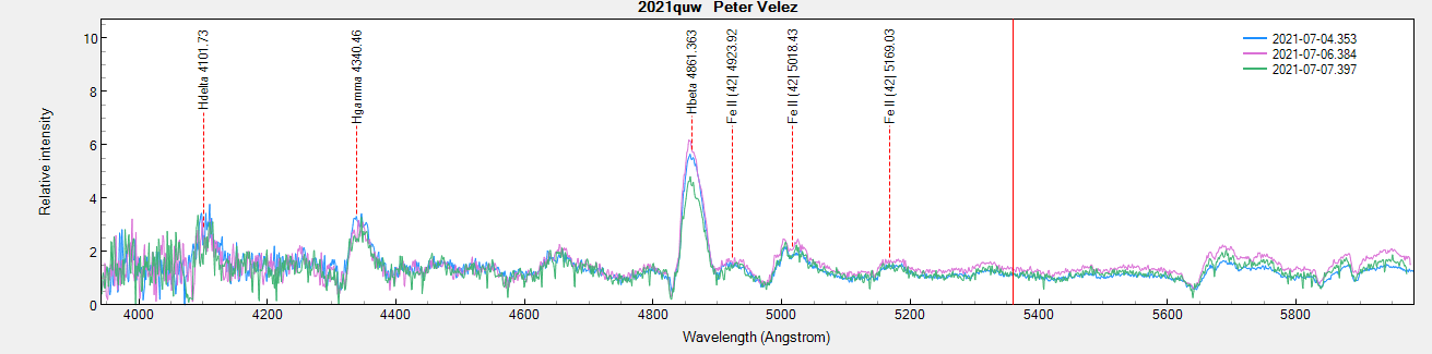

I attach a plot of my data from 4, 6 and 7 July. All spectra were taken with UVEX 600 lines/mm grating on PW CDK 12.5 with an Atik 460EX camera. Imaged from the iTelescope facility at Siding Springs Observatory Australia. Total integrations times varied from 4.5 hours (4 July) to 3 hours (7 July). I've had a stab at identifying a few of the more prominent lines but would welcome any suggestions/comments.
I plan to adjust the grating to access H alpha early next week - once the clouds leave!
Pete

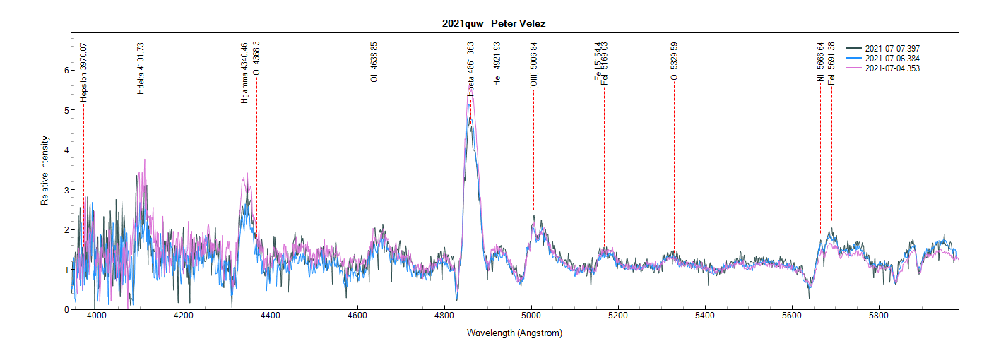

1. OI 4368
1.1. If a line exists at this wavelength, it should be [OIII] 4363. But [OIII] requires an ionizing source > 30 000 K (to produce O2+ ions) and low density ("forbidden" transition from metastable level). Conclusion: it cannot be [OIII] at this stage of development.
Note: the bright OI lines in the first stages of nova are 7773 (clearly seen in the spectra secured by Terry) and 8446.

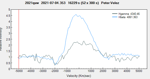

1.2. More over. Yes, there's a shoulder in the red part of H gamma. But is it a line?
This method is comparison with other lines of the same ion or atom. Here, recombination line of HI. We compare the profile with H beta.
The profiles (at least in the red part) are similar. We deduce that there's no emission line. So the identification is simply H gamma. OI 4368 should be removed.
Note: as the ejecta are optically very thick at this stage, the blue edge of Balmer lines can differ significantly due to self absorption (the physical level of the pseudo-photosphere is strongly dependent of the wavelength)

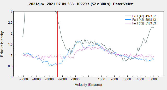

2. The series HeI 4922 [OIII]5007 Fe II 5154 Fe II 5169
2.1. The series is not homogeneous both in ionization level (He I, [OIII] in comparison to Fe II and density ([OIII] according to "permitted" lines).
Thus very improbable at this stage + see above for a) forbidden lines b) high ionized lines.[OIII] will appear later in the so called "nebular stage" when the expending ejecta will becam optically thin in the optical range.
2.2. If we have HeI 4922, we should have also He I 5016 AND He I 5876 (most often the brightest of He I lines). And He I lines requires an excitation energy > 20 eV.
2.3. When we have a series of 3 lines in the range 4900-5200, the most probable identification is the mutiplet Fe II (42) which is the strongest (or at least one the strongest) of Fe II multiplets. The nova is still in the thick Iron Curtain stage.
Thus the id. is Fe II 4922, 5016 and 5169 - Wavelength which must be known "par coeur" for Novae Studies near maximum luminosity
The identification is confirmed by a comparison of the three lines:
An interesting emission feature appears in the blue part of Fe II 5016 line, correlated with a stronger absorption of this line in comparison to Fe II 5169 (Fe 4922 is usefulness due to its proximity with H beta).
It is consistent from the time-series and also appears in Terry's spectra. When a "special" feature appears, it is important -if possible- to assure its reality by a comparison with other spectra and - if possible- acquired with other setups and observers. French: "une hirondelle ne fait pas le printemps".
It is need further investigation.
Well at this state, one can consider that the spectrum is dominated by Balmer and single ionized metals. This assumption will be a guide line for further identification: a. "permitted" lines only b. excitation level ~ 10 000 K.
My id. at this step:
