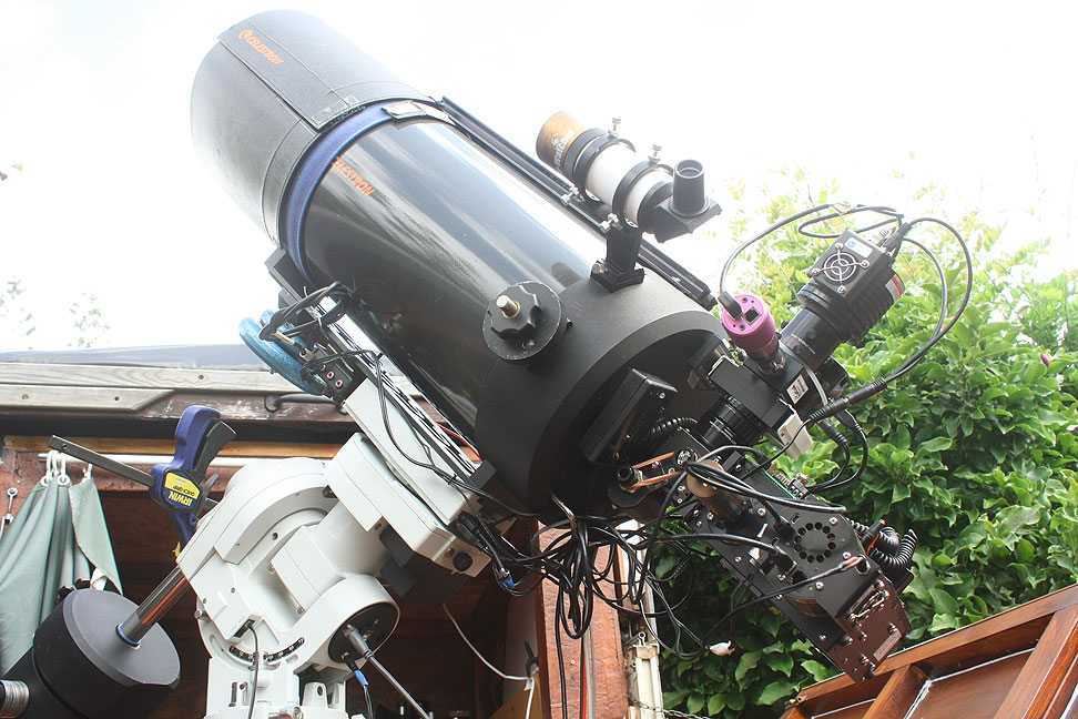

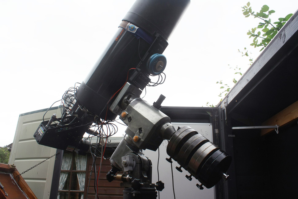

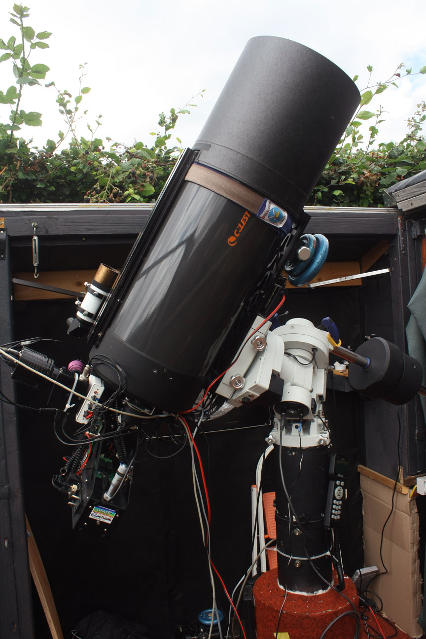

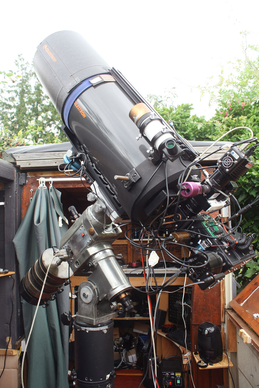

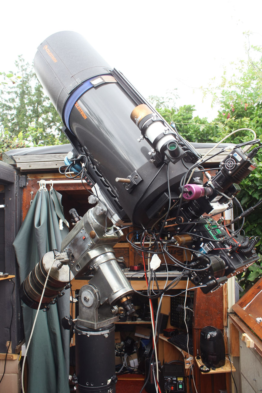

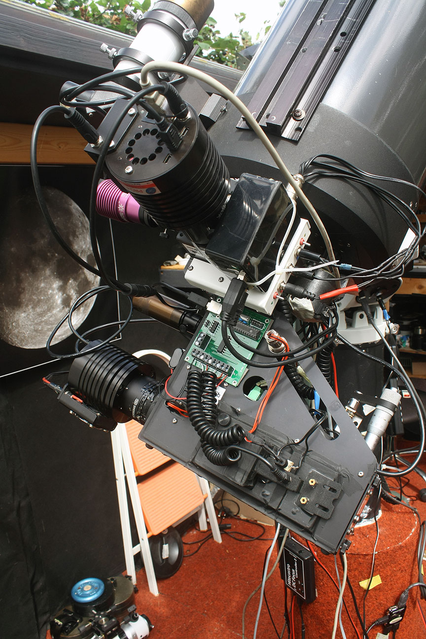

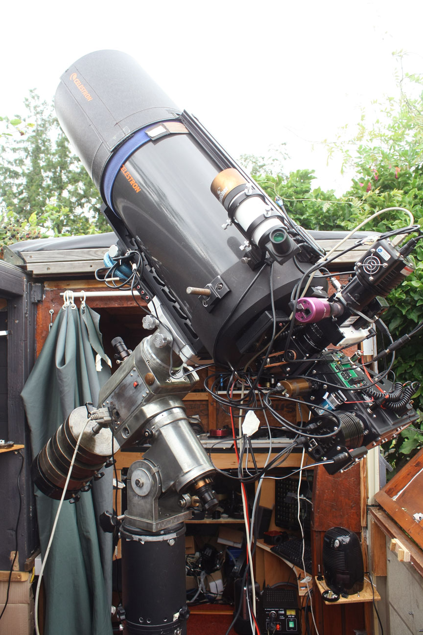

Here are a few photos showing my rig consisting of a C9.25 SCT and its payload of an Alpy 600 and Lhires III. To attach both spectroscopes together I have used a Baader flip mirror which is more than capable of bearing the weight of both instruments,the Lhires is equipped with the faceplate with the M42 threaded hole from Shelyak and the screw in adapter from the flip mirror has been bonded using Loctite.no fear of any slippage and grubb screws lock down to ensure everything is tight as well. Skywatcher focus motor has been attached to flip mirror so as to aid remote operation (apologise for the rubber bands,still awaiting toothed belt) The Alpy works at f/6 with the aid of a reducer and this results in having to refocus between instruments as to be expected and a shift of the target star due to different positions of the slits. Flexure wise,as I stated the flip mirror is more than capable and there is no movement in that regard :)

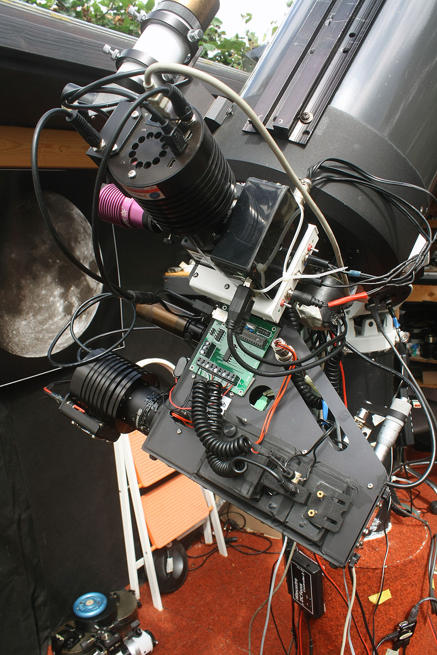

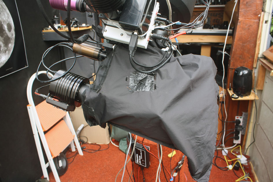

PCB board on the Lhires operates a focus motor attached to the collimation lens and another motor attached to grating micrometer and there is also a relay board in the well of the instrument which operates the calibration/flat lamp module,same goes for the Alpy,the black box attached to the calibration module contains a relay board and operates its calibration module. So as to block light getting into Lhires and protect electrics from damp I modified an old film changing bag which I cut and stitched so as to aid removal with instrument insitu.
Ioptron CEM60 carries the weight with no problems,everything is balanced to the point that if magnetic clutches are released the scope stays where it is pointed and on this mount that can be an hair pulling experience reaching that goal,hence the use of fender washers and the woodworkers clamp :)
Alun

That looks like a comprehensive and perhaps fully remote operated instrument suite!
How do you find your targets if they are faint? Do you use another camera and telescope (eg. a 50mm finder with camera) to platesolve? Or is the image in the alpy or LHires guide camera good enough to platesolve?
I use a flip mirror upstream of my L200 to send the light to a DSLR for platesolving. But I don't have an observatory, so that is a big help, as I then don't need to care about making a good two /three star alignment. My mount stays put in the yard and gets covered with a tarp when not in use, while the optical tube (f6 200mm newtonian) and permanently mounted spectrograph, flip mirror etc goes into the garage.

Thanks for this report. You use Lhires with reducer on SCT ? Normally this spectrograph work at F/10 or minimum F/8 C. Buil say ?

Hi Hamish,
I polar align using Ioptron Ipolar (same as polemaster) and Sharpcap and I tend to stay on one side of the meridian (I mainly observe Be stars) and the goto on the CEM60 is pretty good enough
to put the target star on or near the slit,if I struggle to find a faint target I will slew and sync to a nearby bright star. Have tried plate solving again with Sharpcap whilst deep sky imaging and have found it to either take too long or totally fail,but that could possibly be more down to user error :oops: Apart from opening and closing the observatory roof everything else is remotely operated via Windows Remote Desktop and ethernet using the house electrical wiring.

You are welcome,no the Lhires works at f/10 as it should,the reducer is attached between the calibration module of the Alpy and the flip mirror hence having to refocus between the two instruments.

I guess you could add spacers and shims between the Lhires and flip mirror making it focus at the same (or nearly same) point as the alpy and its reduced optical path, reducing the amount of refocussing.

Keeping the Lhires close to the flip mirror causes less strain on the connection to the scopes visual back,but if a suitable plate were to be machined and placed between the two,mirror casing and plate would have to be bonded together for added strength,then I suppose it could be done. The other option though is to do away with the reducer and then run the Alpy at f/10 :)
