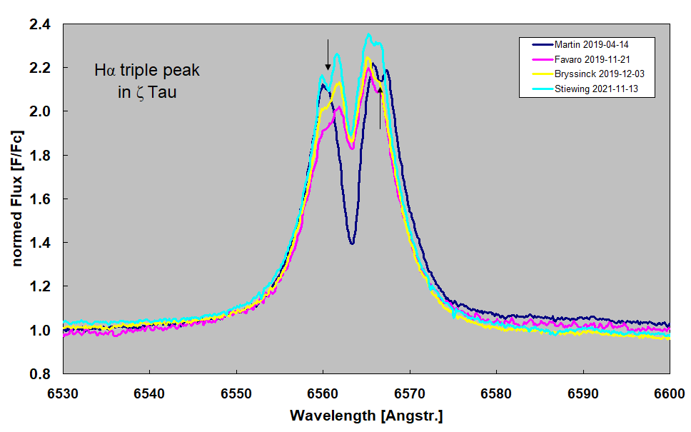

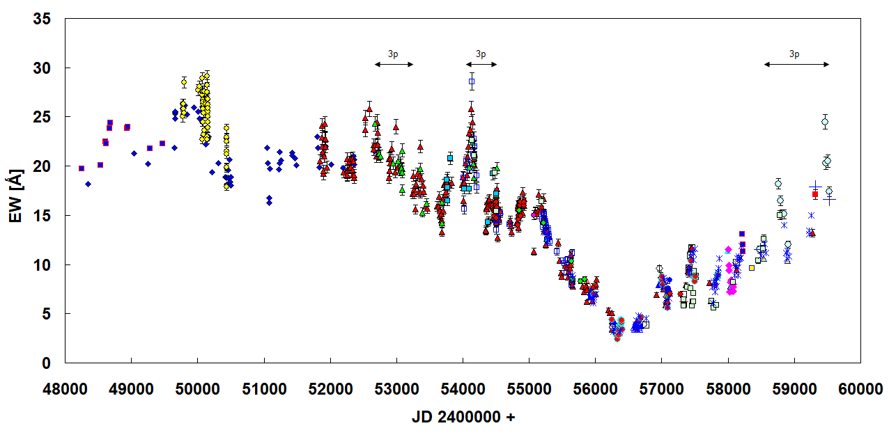

Since the Be-star is at present again (still) in its Be phase, there is the chance to observe the so-called "triple peak" in Halpha. This "triple-peak-phase" has been observable in the past twice (see: EW-Monitoring_triple-peak.png).
At present spectra of A. Stiewing, J. Martin, A. Favaro and E. Bryssinck show this since November 2019 to now (see: Triple peak spectra.png).
It seems, that this "triple-peak-phase" occures only at times, when the circum stellar disk does have a certain level in mass and/or volume. The physicall causes seems to be unclear. That´s why our professionall colleague Thomas Rivinius (ESO Chile) does have a high interest in monitoring spectra of zeta Tau. Because of that it would be importand to take spectra during the next months.
Triple peak spectra.png (43.34 KiB) Viewed 5555 times

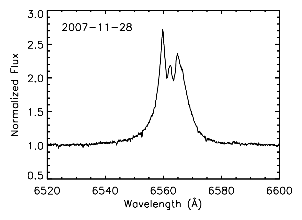

For comparison, a triple-peak spectrum from 2007-11-28 in:
CHARA Collaboration Year-Five Science Review by Gail Schaefer (CHARA / GSU)
