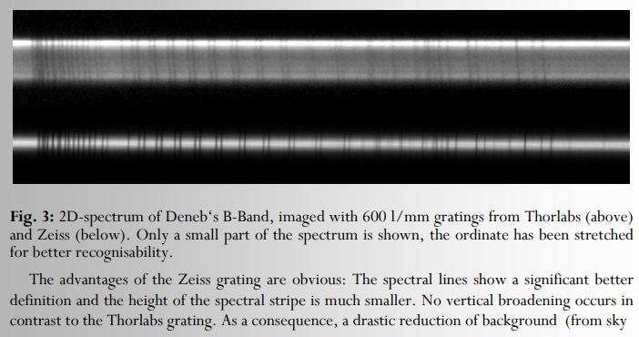

What I have found surprising and very interesting in Uwe Zurmuhl's "Spectroscopy with Medium-sized Objective Gratings" article in the latest BAV Magazine Spectroscopy is Fig.3 (below) comparing the Zeiss versus Thorlabs transmission gratings.
The very obvious superior Zeiss performance makes me wonder how much our slit spectrographs, that mostly use Optometrics/Thorlabs reflective gratings, would benefit with Zeiss gratings (not cheap), assuming the superior performance also applies to their reflective gratings.
Can anyone confirm this Zeiss improvement with slit spectrographs?
Bernard
Bernard
- Zeiss vs Thorlabs.jpg (41.72 KiB) Viewed 8130 times

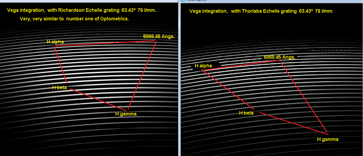

Hi Stu,
It seems that we're a bit confused, Uwe Zurmühl, -- you can see here from page 25, https://bav-astro.eu/images/Issue_12_21.pdf --,
talks about a comparison transmission gratings, and has used them in different design that we use. That last isn't important because
with efficiency and a lot of evidence, Uwe shows us that Zeiss gratings are well done and Thorlabs ones are defectuous.
Really exist three grating manufacturers of the first line, Richardson, Toshiba and Zeiss. There's another old manufacturer, Optometrics,
but that company changed ownership many years ago, although I bought them an echelle grating 63.43º 79 l/mm. 9 month ago, when I read
and realized this report in the VdS, https://forum.vdsastro.de/viewtopic.php?f=2&t=4371. I tested the Optometrics one and it has double the efficiency than the Thorlabs, it's the same that made the x2 de surface of my telescope !!. I put it in a NOU_T that I sent to an observer.
I bought a second echelle grating from Optometrics, it was of another manufacturing series and unfortunately, in the test I got the same result
as the Thorlabs one.
Currently, the closest company to us is Richarson ( by ED ), I have been using their echelle gratings in my NOU_T echelles with similar results as the first Optometrics one.

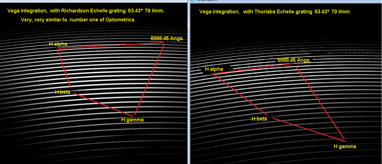

You can see in this picture the same points there are in different places, it passed when I'd changed the echelle grating. With the Richardson
one I've noted a remarkable resolution improvement and reduced the integrations half time. The Thorlabs one, spreads and loses a lot of light
out and erases fine details in the final graphic, but it's very good at making tungstene images, ( just ).
Have a Good New Year ! Cheers, Joan.
