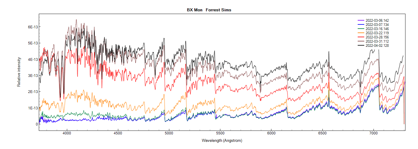

The low excitation BX Mon is emerging from deep eclipse.
With spectra gathered by Franck Boubault and Woody Sims, we have a good mapping of the egress.
The evolution of the continuum is impressive.
Flux calibrated spectra of the event secured by Woody
Daily spectroscopic and photometric (BVR) coverage until the solar conjunction is recommended.
Flux calibrated spectra will be a must
Last luminosity measured by Woody : V = 10.0
BX Mon: egress of eclipse and peculiar continuum

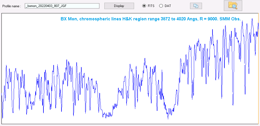

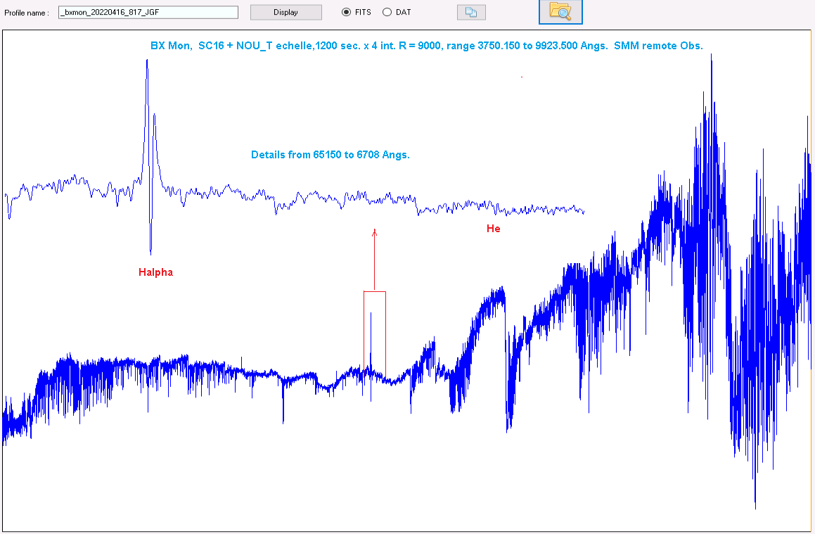

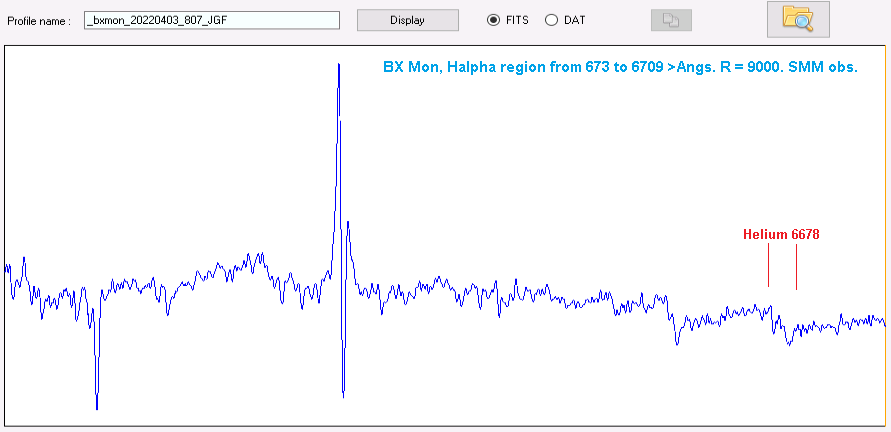

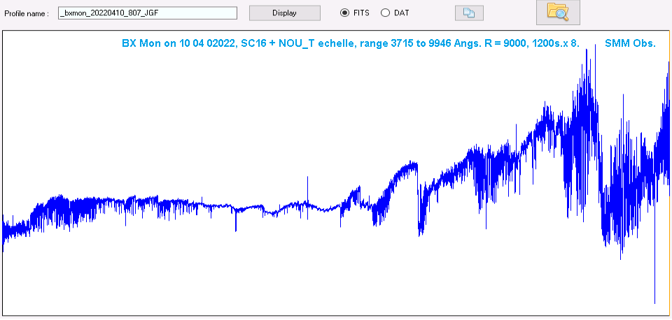

After some weeks of bad weather, yesterday night I rehearsed a BX Mon observation with not much good seeing, you can see the results here.
Regards, J.Guarro.

Great spectrum, Joan, Thanks!
Very impressive range and SNR at this luminosity.
The shape of H alpha is very interesting: this is uncommon is symbiotics that the absorption is displaced towards the red edge.

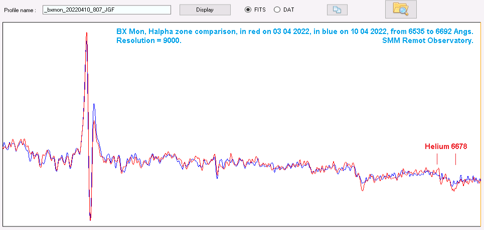

Hello at all, et merci François,
That was BX Mon from yesterday night between cirrus and Hapha and Helium with 03 04 2022 comparison.
Cheers, J.Guarro.
Cheers, J.Guarro.

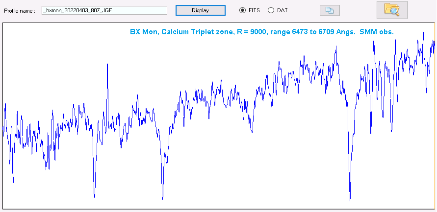

Re: BX Mon: egress of eclipse and peculiar continuum
You can seethat the particular shape BX Mon H alpha it's still present.
Regards, J. Guarro.
Regards, J. Guarro.
