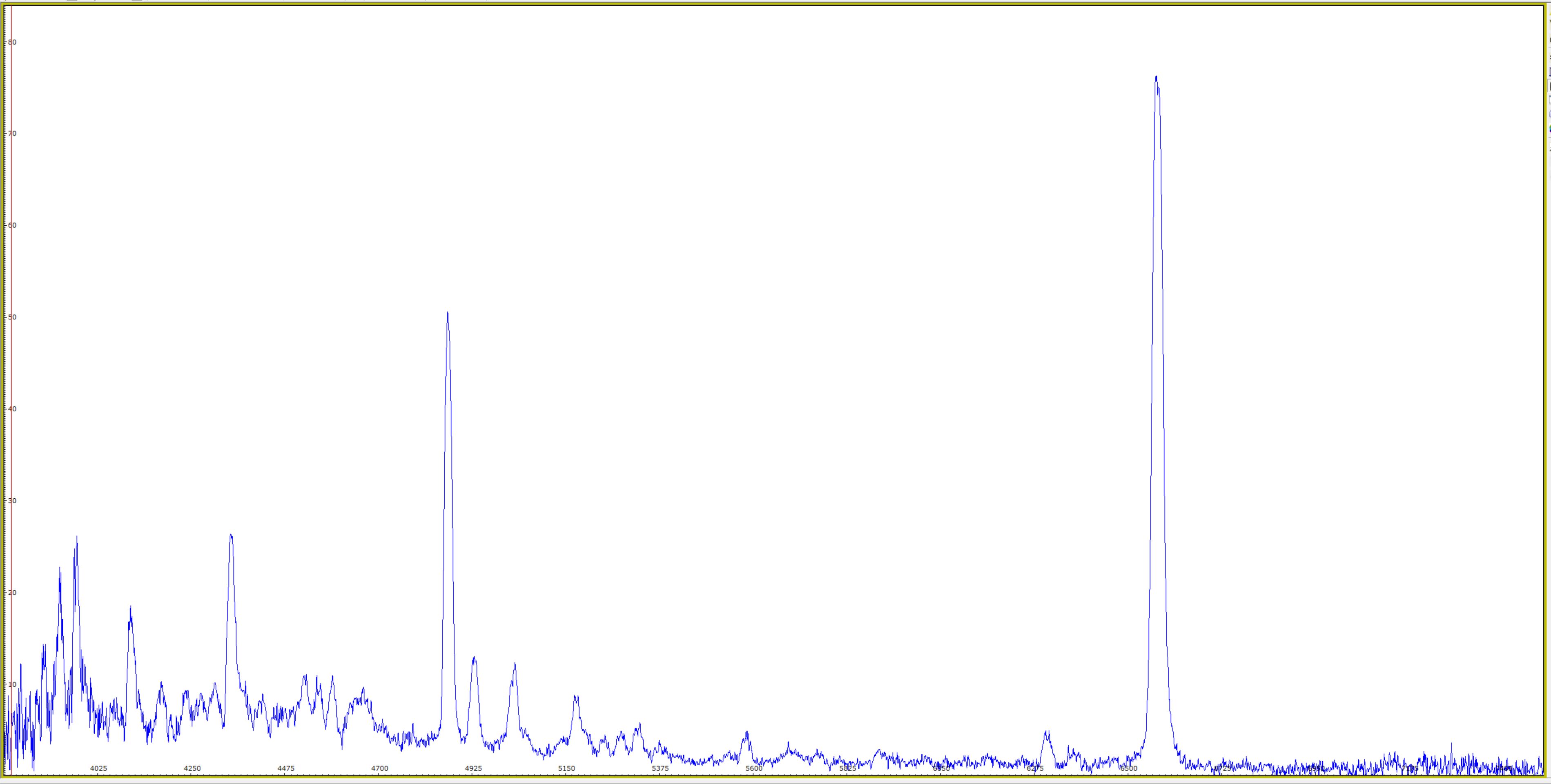

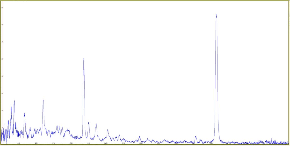

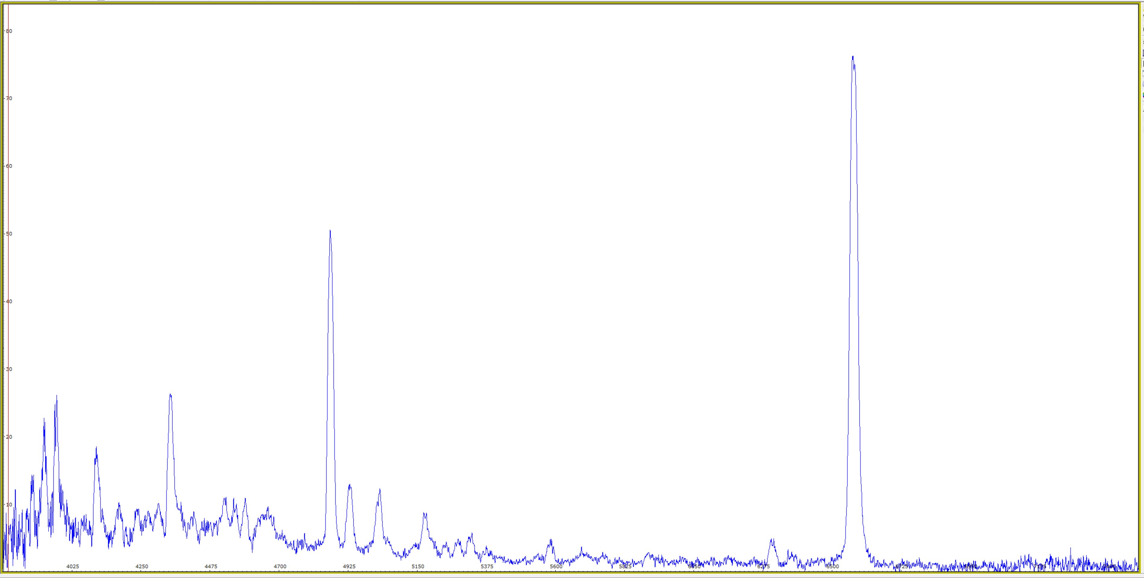

Kia ora koutou, as they say in these parts. I managed to get a shot of this object this evening from New Zealand. 120 min in 4x30min exposures, although some occulting from the observatory walls in the last exposure.
Re: PNV J05222788-6936333 possible nova in LMC mag 12.5
And here is the fits file. The response star was HD42525.
#Curses. FIT file not allowed on the forum. Let me know contact details, and I'll send you the fits spectrum.
Looks like a nova to me. You could formally classify it on TNS
https://www.wis-tns.org/object/2022khw

*****************************Robin Leadbeater wrote:zip it or change the extension eg to .txt ?Tom Love wrote:
and on TOCP
http://www.cbat.eps.harvard.edu/unconf/ ... 36333.html
Yes, Robin, it has been confirmed as a nova by the SOAR staff (pls see https://www.astronomerstelegram.org/?read=15392)
Tasso

*************************Tom Love wrote:Kia ora koutou, as they say in these parts. I managed to get a shot of this object this evening from New Zealand. 120 min in 4x30min exposures, although some occulting from the observatory walls in the last exposure.
This is great, Tom, thanks! Excellent spectrum!
It looks clearly as a FeII nova. Unfortunately, we are already too far from the probable explosion data (April 30th) so I think we are heading to the nebular phase.
Tom, maybe you would like to submit your fit file in this TNS page as a classification report: https://www.wis-tns.org/object/2022khw
