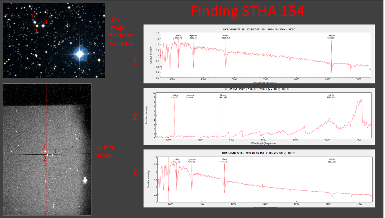

Our colleague Keith Shank got a spectrum of StHA 154 and put the finger on an interesting behavior.
StHA 154 = 2MASS J18432793+1930053 in SIMBAD is a poorly studied symbiotic star with 4 references in Simbad.
Keith obtained a spectrum of a red giant, spectral type M7-8 (from TiO1 index) with no emission.
He confirmed the identification taking spectra of the two brightest neighbors of the target. The early type of these two stars excludes that they can be StHa 154.
(Keith Shank)
Woody Sims and Bob Buchheim confirmed the identification.

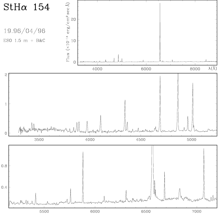

StHA 154 was discovered as en emission line star by Stephenson (1986)
Munari & Zwitter (2002) published a spectrum showing a typical symbiotic (nuclear powered) with notably He II, Raman OVI , [OIII]

I have checked all the available information and observational data on this object. First, let me summarize the limited information in the literature. The first mention of the star is indeed in the list of Halpha emitter of Stephenson (1986). Coordinates point to the object now known as StHa 154. The star is classified there as M2 and neither any information is given about the strength of the Halpha line, nor any comment about other features in the spectrum (it is definitely not mentioned as a possible symbiotic star in the paper). In my opinion, that is strange, given that symbiotics typically have very strong emission lines. For StHa 190, another confirmed symbiotic star Stephenson commented on the other emission lines in the spectrum, for StHa 149 he mentioned 'very strong' Halpha. One should also mention, that the star is just at the magnitude limit of the survey. Therefore I suppose that the spectrum could have a low S/N and maybe even the estimate of the spectral type could be unprecise.
Most of the objects from Stephenson (1986) which are now known as symbiotic stars were confirmed in the scope of the work of Downes and Keyes (1988). The object StHa 154 was unfortunately not observed by them. The star was also not included in the catalog of Belczyński et al. (2000) as at that time there was no suggestion in the literature about the possible symbiotic nature of the star.
There is only one spectrum of StHa 154 suggesting the symbiotic nature presented in the literature. It is in the atlas of Munari and Zwitter (2002). It is a bit intriguing, because they claim in the paper, that they observed the known symbiotic stars from the list of Allen (1984), Belczyński et al. (2000), and SMC objects from Meyssonnier & Azzopardi (1993). In none of these, StHa 154 is listed. The coordinates and cross identification of the star are that of StHa 154, but I am unsure, that the object observed was StHa 154. First, I see no reason why they would observe StHa 154 as it was not suggested as a symbiotic star anywhere in the literature. Secondly, in the paper, it is written that the object was observed on 19.96/04/95. In the figure, it is written that the object was observed on 19.96/04/96. Aside from the uncertain year of observation, the observation took place around midnight (unclear if UT or local, but I assume UT). On April 20, the object rises around 5 AM UT (or 1 AM local), so I don't think it could have been observed. Interestingly, StHa 164, an object classified as a symbiotic star before, was not in the atlas of Munari and Zwitter. This could not be used as final evidence as not all known symbiotic stars were observed for the atlas, but still, I don't see the reason why they would omit StHa 164 and observe StHa 154 instead. After 2002, the object was not analyzed and is included in the list of confirmed symbiotic stars (in Akras et al. catalog and mine Database) only based on the Munari and Zwitter (2002) work.

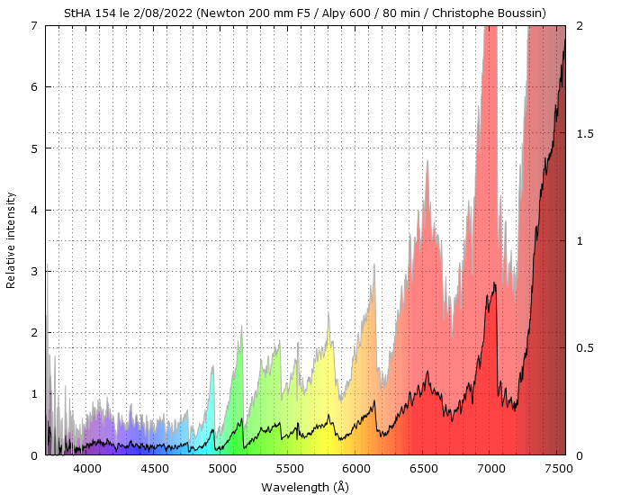

Here is my contribution to the monitoring of StHa 154.
I obtained the following spectrum of StHa 154 with a spectral range from 3700 to 7565 A the 2nd of August at 22 h 47 TU with my Alpy 600 (resolution of 536, JJ = 2459794.4494) and an acquisition time of 80 min (8 x 600 s) :
StHa 154 on August 2nd, 2022 (3700-7565 A)
