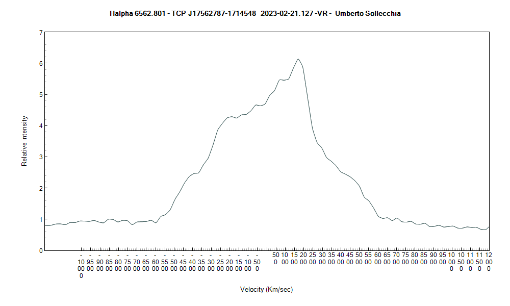

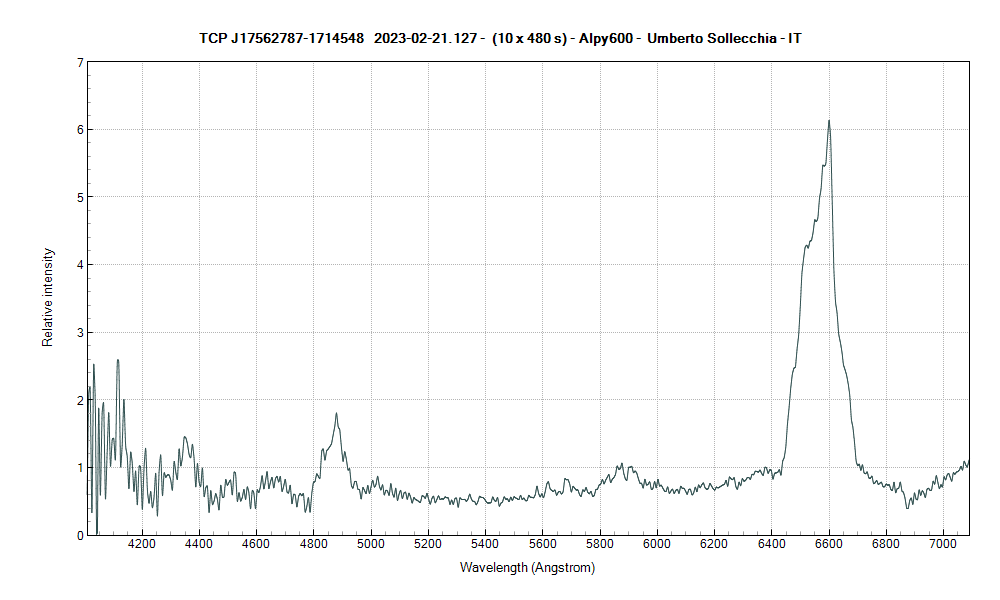

Hi all, I post the spectral profile of the transient in question.
TCP J17562787-1714548
- Posts: 247
- tcpj17562787-171454820230219,8234_20230221_127_ VR-Umberto Sollecchia.png (23.54 KiB) Viewed 14998 times
Last edited by umberto sollecchia on Fri Feb 24, 2023 4:29 pm, edited 5 times in total.

Re: TCP J17562787-1714548 2023 02 19,8234
was this taken on Feb 18.759? Wow, this is definitely the first spectrum! Such a huge change to today's spectra!
- Posts: 247
Forgive me Hamish, I was wrong to attach the file. Now that's right.
Hamish Barker
- Posts: 227
the spectrum looks great. I hope you are able to collect some more. with the northern and southern observers all able to observe it, it might be possible for us collectively to collect a good time series to study the evolution of this quite fast nova.

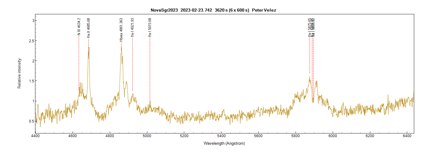

I've been following this nova this week. It rises quite late in the morning so I have limited time to collect data. Its also fading quite rapidly so the SNR is falling away as well.
The best quality spectrum I have is for 23 February 2023. I've marked the most prominent lines. Resolution is around 1200. Taken with a UVEX mounted on a Planewave CDK 12.5. I'm surprised at the strength of the He II line - perhaps I have misidentified it so corrections and comments are welcome.
Also attached are spectra taken on 3 consecutive days.
I have some NIR data from 22 February 2023 but I have no reference star spectrum to apply to it and I'm not confident with the result using another IR curve. If I manage to process it with SpecInti I'll post that too.
Pete
Pete
