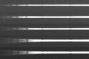

Spectre de alpha leo. Les images sont issues d'une séance d'acquisition de 16 poses, d'un seconde chacune, sur une durée totale d'environ 1 minute.
Voici le résultat sur 5 images prises parmi les 16.
Quelques spectres très bons tel celui du haut, le reste dégradé à très dégradé.
Sur l'apparition de la "queue de poisson", j'ai également noté que la distance de la CCD est un facteur essentiel.
a+

Hello Francois,
maybe it is my poor french but I do not quite see what the fishtails have to do with the turbulence of the air, which in my humble opinion should widen the whole spectrum (movement of star image alonfg slit. My explanation would rather be a defocusing of the spectrograph (between slit and CCD), maybe by a shaking of the spectrograph or attached CCD in the wind? Or you have defocused the spectrograph permanently and move a defocused star image perpendicular to the slit. By selecting only the center portion of the defocused star image (in a moment of little turbulence) you would increase the appparent f-ratio and reduce as a consequence the fish tails. With turbulence you would average over the full aperture of the telescope and work at design f-ratio. What is the normal appearance with little turbulence and good focusing? I hope you understand what I mean.
Regards, Martin

Hi Martin,
I understand what you mean, but there's the whole spectrum
almost well focused on all the spectral range
All the images are taken in only 1 minute duration.
The fish tail aspect appears randomly
There's no significant variation on the mean intensity of the spectrum from an image to another.

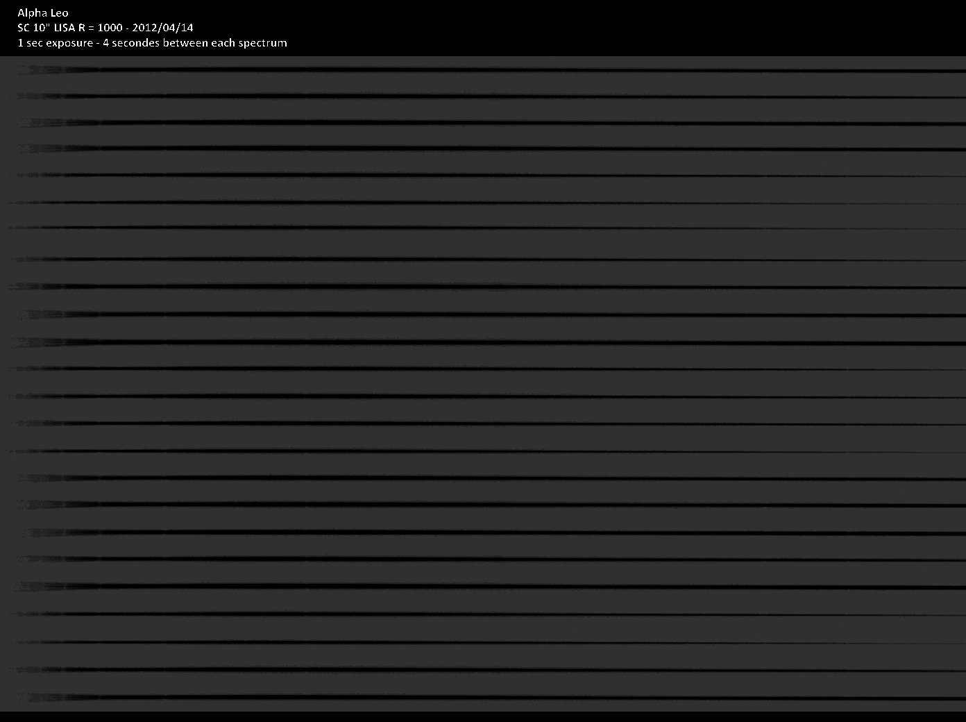

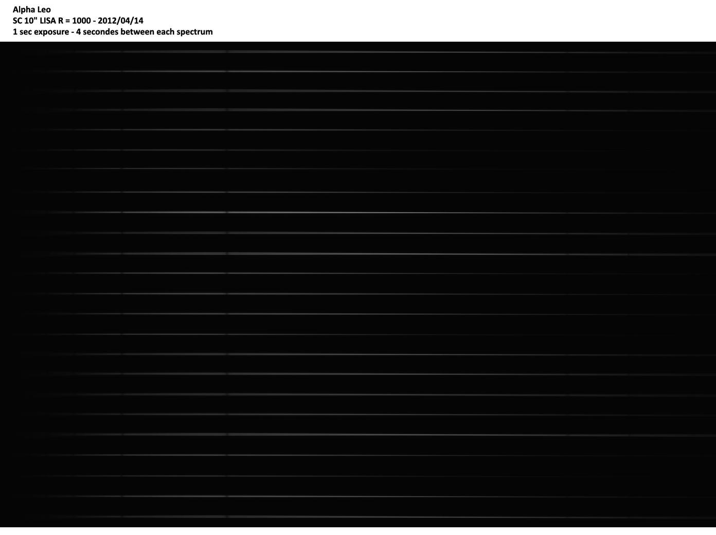

I come back on this subject after a discussion with Bernard Tregon (La Rochelle 2012)
Here's the 24 spectra (1 second exposure, every 4 seconds). The sequence duration is only 1,5 minutes.
One can see the strong defocalisation which appears randomly
According to Bernard Tregon, this could result of a phenomenon of 'focus/defocus' : the wavefront of the turbulence should be (at observation time) of the dimension of the pupil ("pupille" in french, i'm not sure of the translation)
So in that case, turbulence acts as an external lens, whose focal lenght would change with very short time scale.
More, on the following picture, one can see that "fish tail" appears when the spectrum is out focus.
Waiting for your comments
Best regards

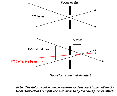

I have a possible geometric interpretation linked to the slit width and seeing (tilt-tilp + possible piston or natural defocussed star because presence of focal reduced and its associated optical chromatism). Look the attached drawing.
At f/10 (for example !) the LISA aberrations are significantly reduced (an also, the aberration associated to focal reducer - an important point).
