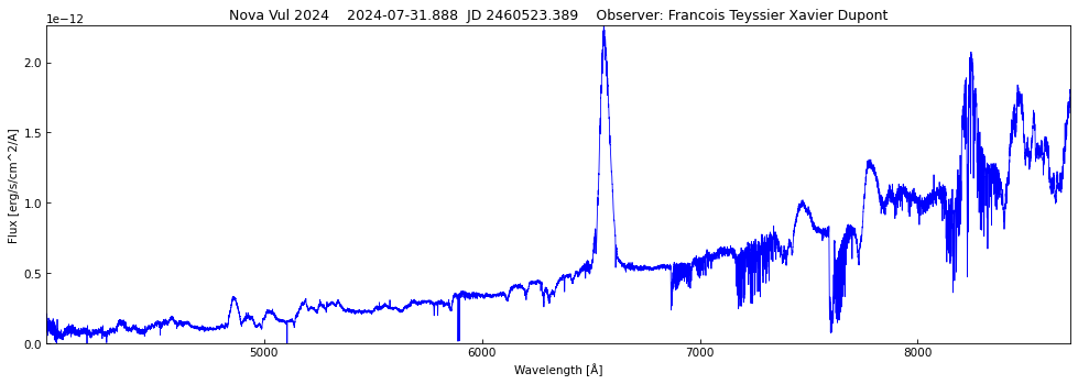

Re: Nova Vul 2024 July, 2024
Spectrum secured at SMM Joan Guarro remte station with an echelle NOU-T R =9000
Flux calibration using V Band magnitude.
The spectrum is strongly reddened (see the shape of the continuum and the strength of interstellar Na I).
Fe II (42) mutliplet appears clearly.
OI lines (7776, 8446) in the near UV are very strong.

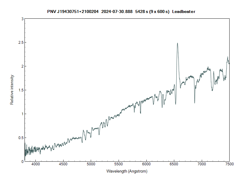

R 900 spectrum (ALPY 600 10um slit) 20240830.888 taken 10 hours after classifying spectrum

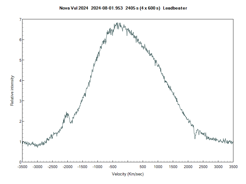

H alpha line profile 20240801.953 LHIRES 2400 R=15000

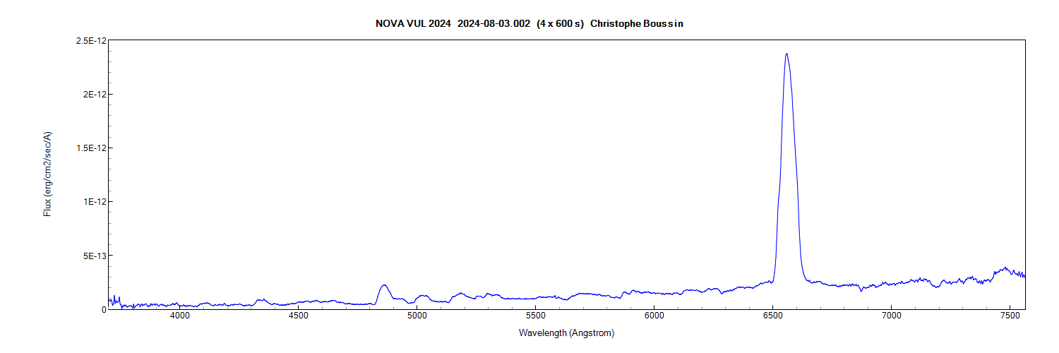

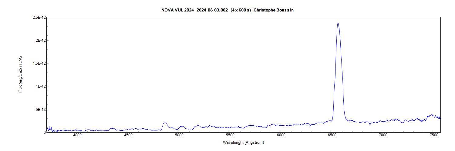

Here is my contribution to the monitoring of Nova Vul 2024.
I obtained the following spectrum calibrated in flux (magnitude measured V = 11.12) with a spectral range from 3700 to 7565 A the 3th of August at 0 h 02 UT with my Alpy 600 (resolution of 543, JJ = 2460525.5016) and an acquisition time of 40 min (4 x 600 s) :
Nova Vul 2024 on August 3th, 2024 (flux calibrated, 3700-7565 A)

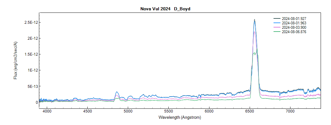

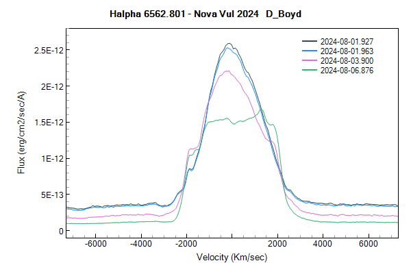

Post by David Boyd »

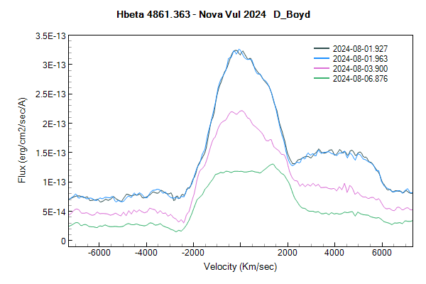

Recent evolution of Nova Vul 2024 at low resolution. C-11 + LISA, R~1100, flux-calibrated with concurrent V-band photometry.
novavul2024_20240801_927_D_Boyd H-beta.png (27.64 KiB) Viewed 33482 times
novavul2024_20240801_927_D_Boyd H-alpha.png (26.94 KiB) Viewed 33482 times

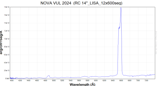

Post by David Cejudo »

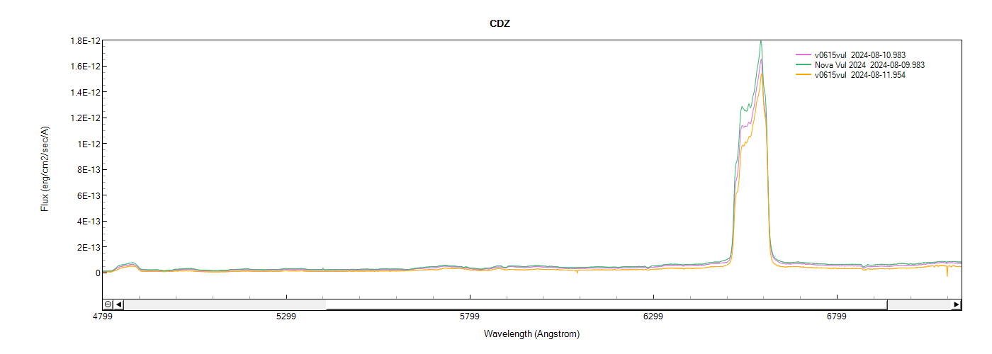

Nova Vul_2.png (20.04 KiB) Viewed 33422 times
Last night´s. Resolution around 720. Flux calibrated
David Cejudo.
Observatorio El gallinero.
El berrueco, Madrid.

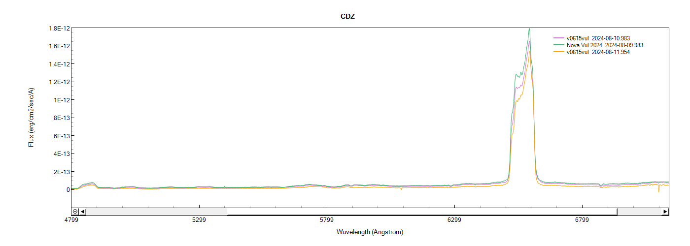

Posts: 458
Here is some Photometric/Spectra I did on Nova V0515 Vulpecula:
LhiresIII (2400 ln/mm grat) with the CDK17 at F/10.5(barlow) for 03-13Aug24:
C-14 at F/7 with ST-8xme & Astrodon IVB filtered, fully transformed photometric data for 03-12Aug24:
(Purple-Red dots, brightest mag, are IR, then green for V and blue for photometric B)
LhiresIII (2400 ln/mm grat) with the CDK17 at F/10.5(barlow) for 03-13Aug24(animation-about 4 sec per frame...slow):
Still need to process Alpy600 data for 03-08Aug24. Will do some LISA-IR data on it as well.
