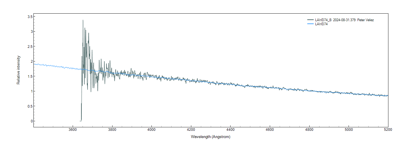

So I took a spectrum of LAWD74, a white dwarf with a very smooth spectrum that increases in the UV. As it is featured in the Calspec database (accessed via ISIS), it would provide a reliable IR curve.
Sadly it doesn't. I attach the spectrum compared to the Calspec spectrum. The divergence in the UV is very clear.

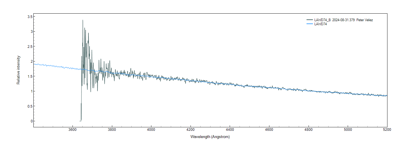

J'ai donc pris un spectre de LAWD74, une naine blanche avec un spectre très lisse qui augmente dans l'UV. Comme elle est présentée dans la base de données Calspec (accessible via ISIS), elle fournirait une courbe IR fiable.
Malheureusement, ce n'est pas le cas. Je joins le spectre comparé au spectre Calspec. La divergence dans l'UV est très claire.

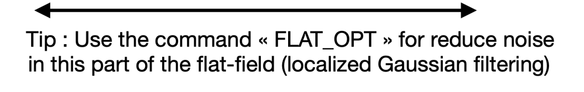

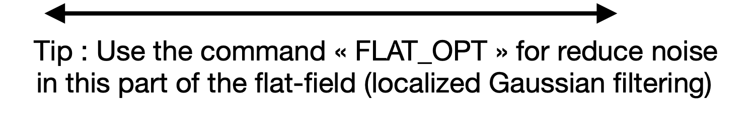

Researching online, I encountered (again!) the excellent. presentation that Christian Buil and Valerie Desnoux gave at ASW2020. It refers to the challenges of obtaining a suitable flat frame in the UV.
It refers to a command tool - I assume in ISIS - to reduce noise in the flat. However, I can't find any other reference to the command FLAT_OPT. Can anyone shed any light on this? And my version of ISIS does not recognise the command
I attach a screenshot of the relevant page.
