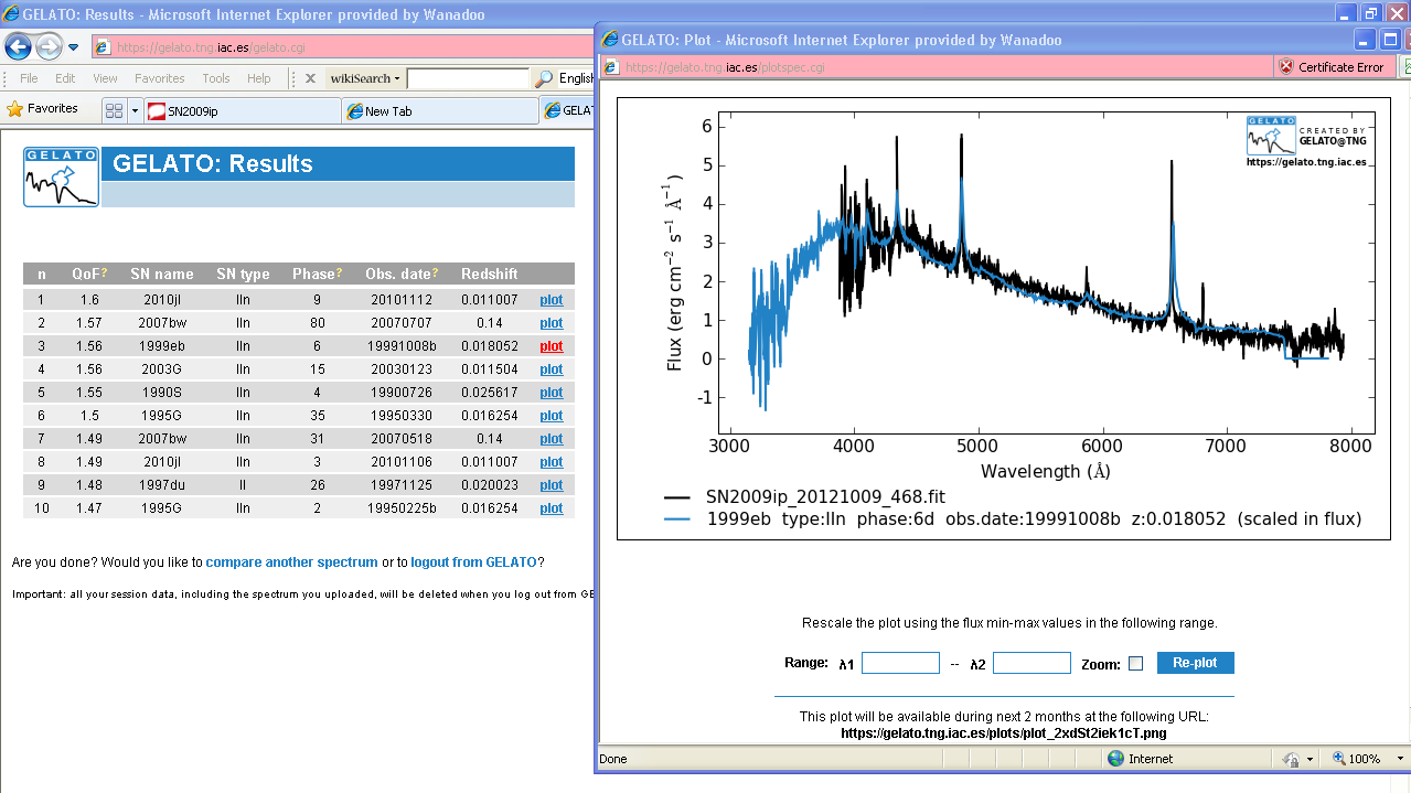

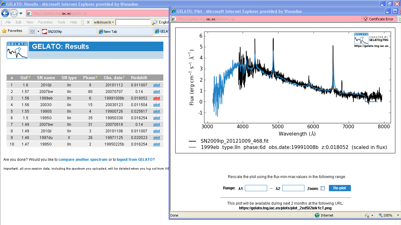

Hi Terry,
Nice result
I have been playing with GELATO which is an automated supernova classification system. I tried it with your spectrum and it confirms it as type IIn (see attached screen shot) The comparison spectra do not show the emission line seenin your spectrum at 6855 though
Nice result

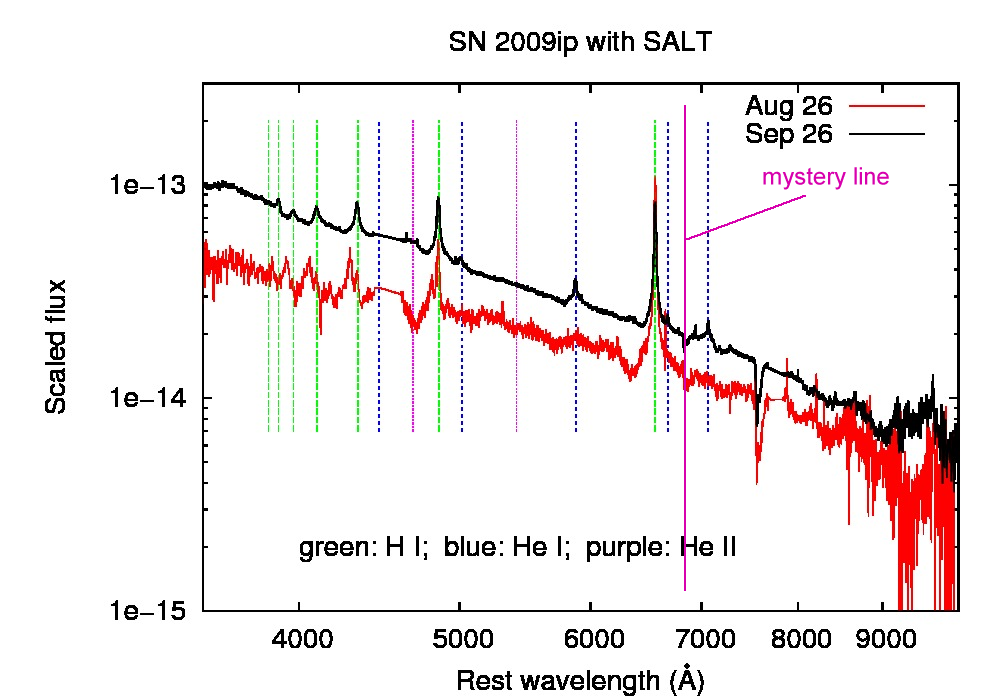

Re: SN 2009ip
Hi Terry,
Yes I can see signs of He, particularly at 5908A for example but the line I am talking about seems to be absent in the SALT spectrum too, though possibly buried in the Telluric band there, see attached

Re: SN 2009ip
Dear Robin
I looked into the line you mentioned. It is an artifact. It was a CRH on my last subexposure and I have edited it out and corrected the fit file on my webpage.
