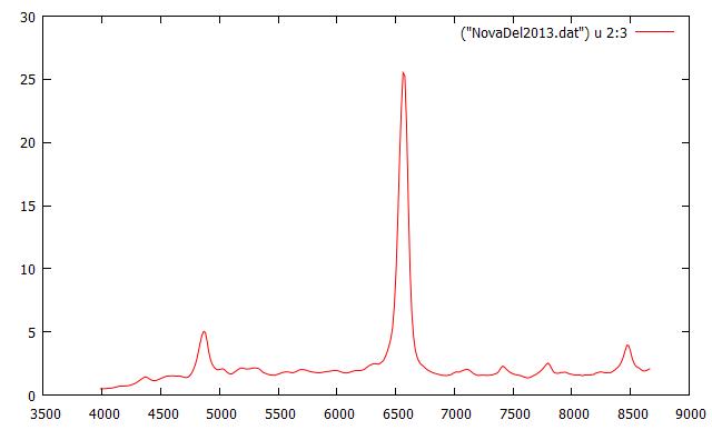

hi,
your links (I thank you for them) have not removed my doubts about the identification of 8500 lines in infrared. Is it CaII or H I? We, Section of Spectroscopy members of Unione Astrofili Napoletani, guests of Osservatorio Astronomico di Capodimonte in Napoli, have shot the Nova Del 2013 on 3 september and a discussion is opened among us and also a debate in Spectroring UAI (Unione Astrofili Italiani) Forum. I ask you for an opinion.
I seize opportunity and send you our spectrum.
Elio Ricciardiello (Sezione di Spettroscopia dell'UAN)

Authors: Elio Ricciardiello, Antonio Porcelli, Dario Castellano, Antonio Marino, Carmen Perrella]

Nice spectrum with a SA, Elio.
In fact the highest line in that region is OI 8446 - Near 8500, there's Ca II 8498, but too faint for a SA.
These lines are in Williams' list
See tomorow morning in the report spectrum of Paolo

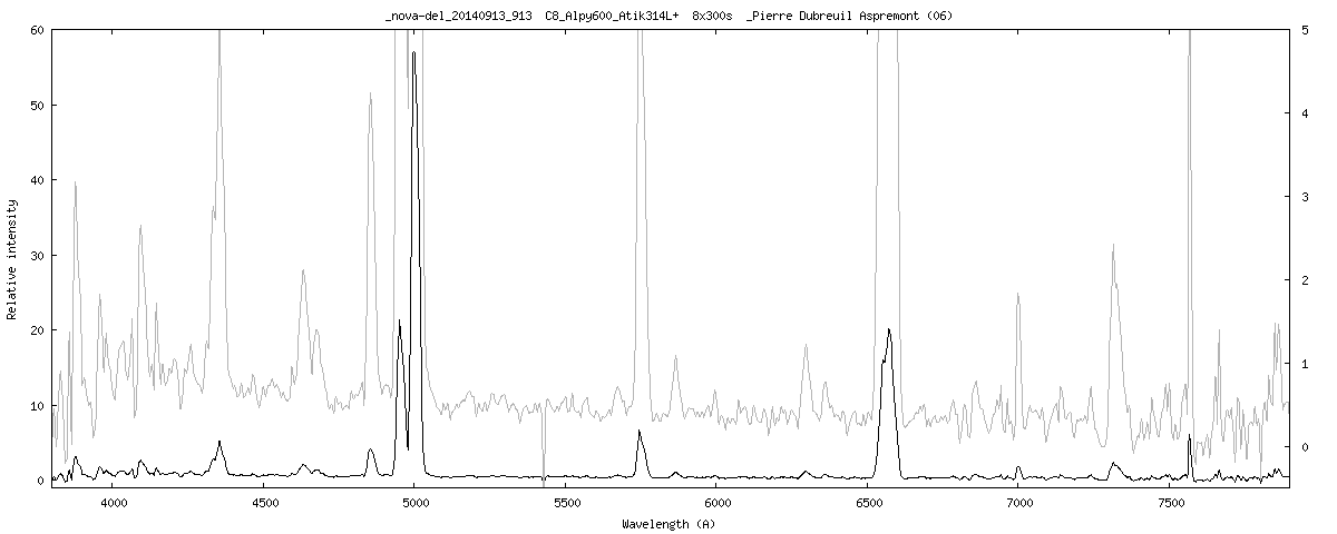

Bonjour à tous
Hier soir nuit sympa mais très humide sur Aspremont 06 Fr (le séchoir a bien chauffé ! ).
Yesterday night fun but very wet in Aspremont 06 Fr (the hairdryer was used a lot).
Quelques cibles Be et Nova Del 2013 qui reste encore bien active.
Some targets Be and Nova Del 2013 which is still very active.
_nova-del_20140913_913 C8_Alpy600_Atik314L+ 8x300s _Pierre Dubreuil
Cordialement
Cordialement
- Posts: 1562
Re: Nova Del 2013
Beau spectre d'une nova qui commence à devenir difficile à mag ~ 12,7
A poursuivre aussi loin que nous pourrons
Plus d'un an maintenant !
