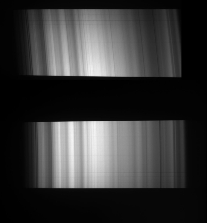

Re: Alpy600 Focus and slit orientation
Here are the before and after adjustment images on my ALPY (daylight spectra, spectrograph on the bench, click on the embedded image to view before and after spectra) Note how the dark lines from dust on the slit are exactly horizontal in each case (Dust specs can be useful to align the spectrum horizontal
- alpy_grism_realignment.jpg (53.75 KiB) Viewed 7722 times

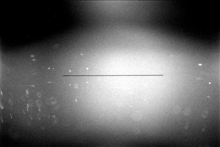

Thanks to Robin for the tip on rotating the camera. I now have a rotator and can produce a horizontal spectrum. I have two questions.
(1) Slit focus with the guide camera. Does the attached image look good for focusing the slit? (It is a bit of an angle.)
(2) Slit focus versus spectrum focus: If the star is focused in the guide camera (using a mask), will the spectrum also be critically focused? Or do I need to do some additional focusing by paying closer attention to the Ha or Ca lines of my reference star?
Hi Ed,
The orientation of the whole spectrograph relative to the sky is an interesting subject. Some run the slit in the RA direction and in the days before autoguiding this was the preferred option as it meant the PE moved the star up and down the slit, not on and off it. What works best depends on your mount and guider. (Or to really show off and provided your guide program can cope with odd angles, you can even orientate it at the paralactic angle to minimise atmospheric dispersion effects)
It is important to focus the star on the slit though to get as small star image as possible to maximise throughput.
First make sure the image of your slit (at the point where you are going to place the star) is exactly in focus in the guide camera. Then with the star image just off the slit, focus the scope to give the tightest star image. This will get you close to optimum but if you want to get the maximum out of the starlight there are various other tricks, for example
With the star on the slit, readjust the focus to minimise the overspill (reduce the exposure to the minimum to best see this effect)
Watch the spectrum image, focussing to minimise the vertical thickness of the spectrum (useful for minimising any chromatic aberration effects in the scope too which "fishtail" the spectrum, particularly at the blue end. This is my favourite technique with ALPY when using the C11 with a focal reducer. I usually tune for most even width of spectrum over the full range)
Ultimately tune for maximum counts in the spectrum.
That looks fine to me. The angle does not matter. I actually run the slit vertically in my guide camera as I run with the slit in the Dec direction so it seems more natural.EdWiley wrote: (1) Slit focus with the guide camera. Does the attached image look good for focusing the slit? (It is a bit of an angle.)
The focus of the spectrum is independent of the focus of the star on the slit as the spectrum is effectively a multitude of images of the slit.(2) Slit focus versus spectrum focus: If the star is focused in the guide camera (using a mask), will the spectrum also be critically focused? Or do I need to do some additional focusing by paying closer attention to the Ha or Ca lines of my reference star?
Thanks, Robin, excellent feedback. BTW, the reason the illumination looks so strange is that I managed to invert the pickoff mirror. Naturally this produced some strange effects at the scope until I figured out the problem.
