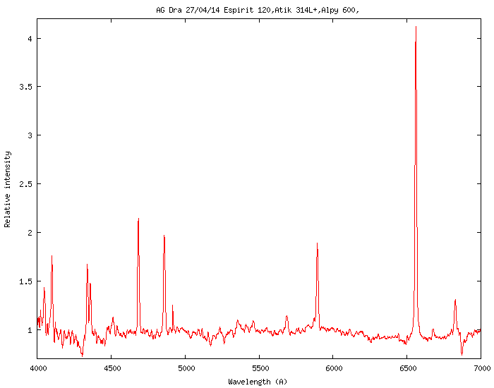

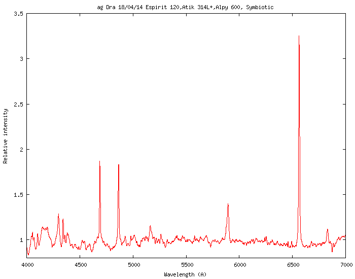

Hi
Only managed one 600sec shot at ag Dra last night until my powered usb hub stopped working, hopefully I managed it ok!
regards
Steve

Dear Steve,
The lines are correct, but the continuum is still wrong (it is smoother and redder)
Not easy to say weither acquisition or treatment has to be improved
You could
1. describe your procedure
2. send us the fits of the target, reference, neon and flat

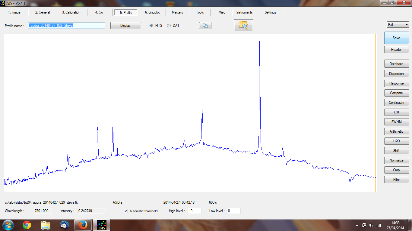

Hi Francois

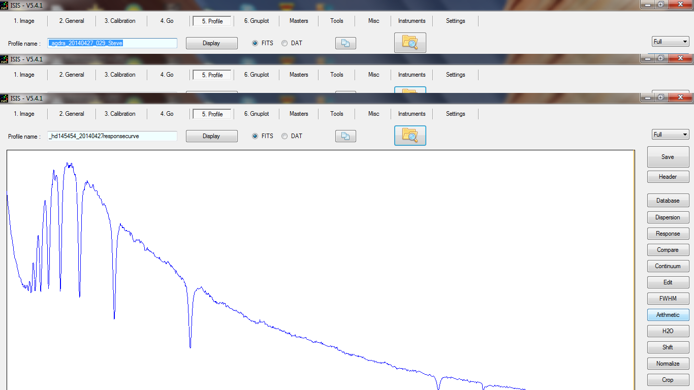

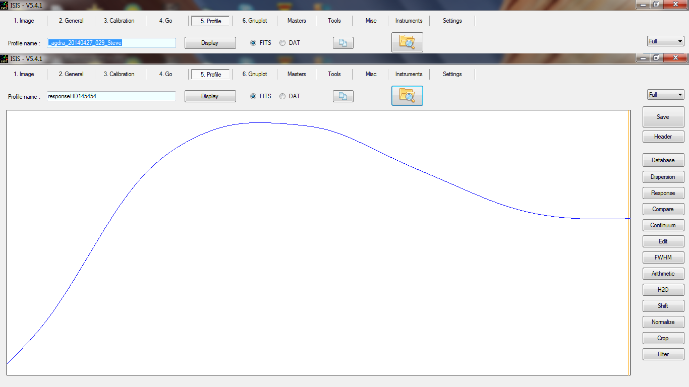

I took an image last night of AG Dra again and used for response calculation a nearby B type star HD 145454 and get a reasonable response curve for the Alpy600 thus -
which I use to correct the HD145454 profile thus -

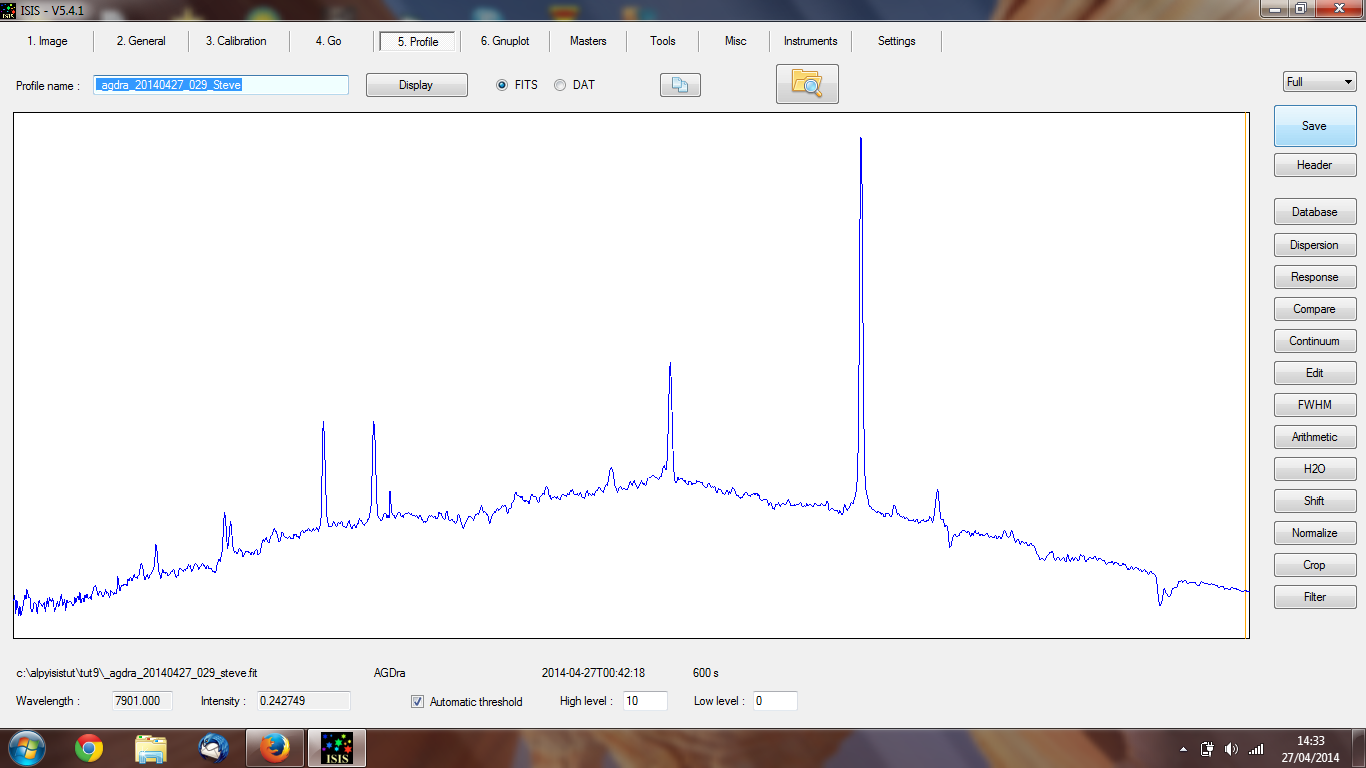

I then process AG Dra using a 600sec exposure plus a 600sec dark plus a cosmetic and also using the above response curve and get this profile
This is then smoothed out to give this final curve -
AG Dra.png (5.51 KiB) Viewed 12582 times
which strangely enough looks a lot like my original and does not have the shape I`ve seen of other profiles of AG Dra?? More practice maybe ?
Regards
Steve
Re: second try at AG Dra
Hi Steve,
No need to do the final step. The result after dividing by the instrument response is the one you want. Your IR looks reasonable, except perhaps it is over smoothed at the extreme blue end and therefore does not quite fit the continuum and is probably causing the flick up in your ref star spectrum compared with the true library version. I am not familiar with AG Dra though so I cannot say if this is correct. Over to you Francois :)
