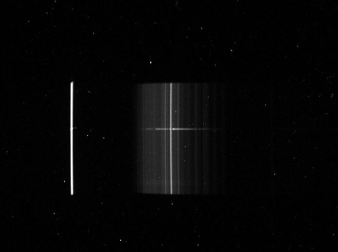

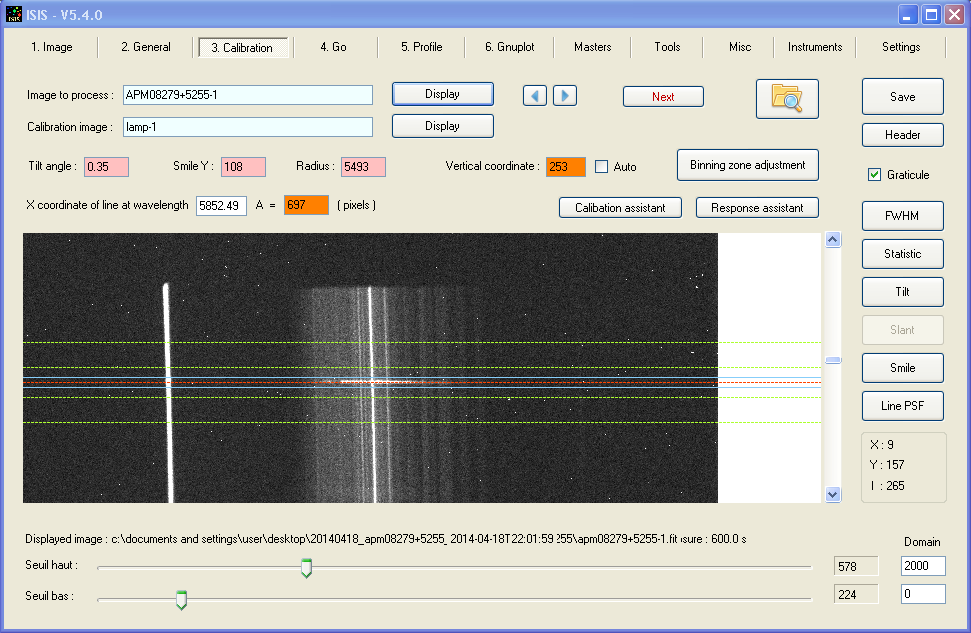

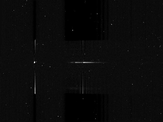

Provided you get your geometric corrections right, particularly smile/slant, the background lines should cancel independent of where you set the skybackground zones. Attached is an extreme example from my recent QSO measurement showing the ISIS binning zones and geometric correction settings used and the resulting processed spectrum images with and without sky background subtraction
- skyremovaltest.jpg (22.88 KiB) Viewed 5308 times
- skyremovaltest_notremoved.jpg (14.86 KiB) Viewed 5308 times
- binning_zones.png (245.65 KiB) Viewed 5308 times

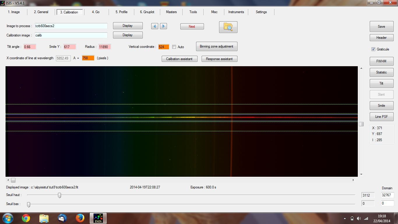

I wasn`t aware that a bright line above and below would cancel each other out!. I did notice I used a 400sec light but with a 300sec dark which might make a difference.
I also notice that since updating ISIS to 5.4.1 my spectra is now in colour?? This is one of TCrb! regards

Molecular lines showing nicely there in T CrBSteveCuthbert wrote: I also notice that since updating ISIS to 5.4.1 my spectra is now in colour?? This is one of TCrb!
The colour comes from "settings" "rainbow". I've not used it myself but I presume you have to enter the extreme left and right wavelengths in the image to get the colours approx right (eg is the bright sky line in the red actually the Na D line?)

I didn`t even notice there was a `rainbow` setting in ISIS
, it must default to `rainbow` in 5.4.1.as I didn`t select it! Not sure if the colouring is correct when ISIS finishes its calibrating?.

See "Settings" tab and left lower corner. Note "Display" area and unselect Rainbow option.
