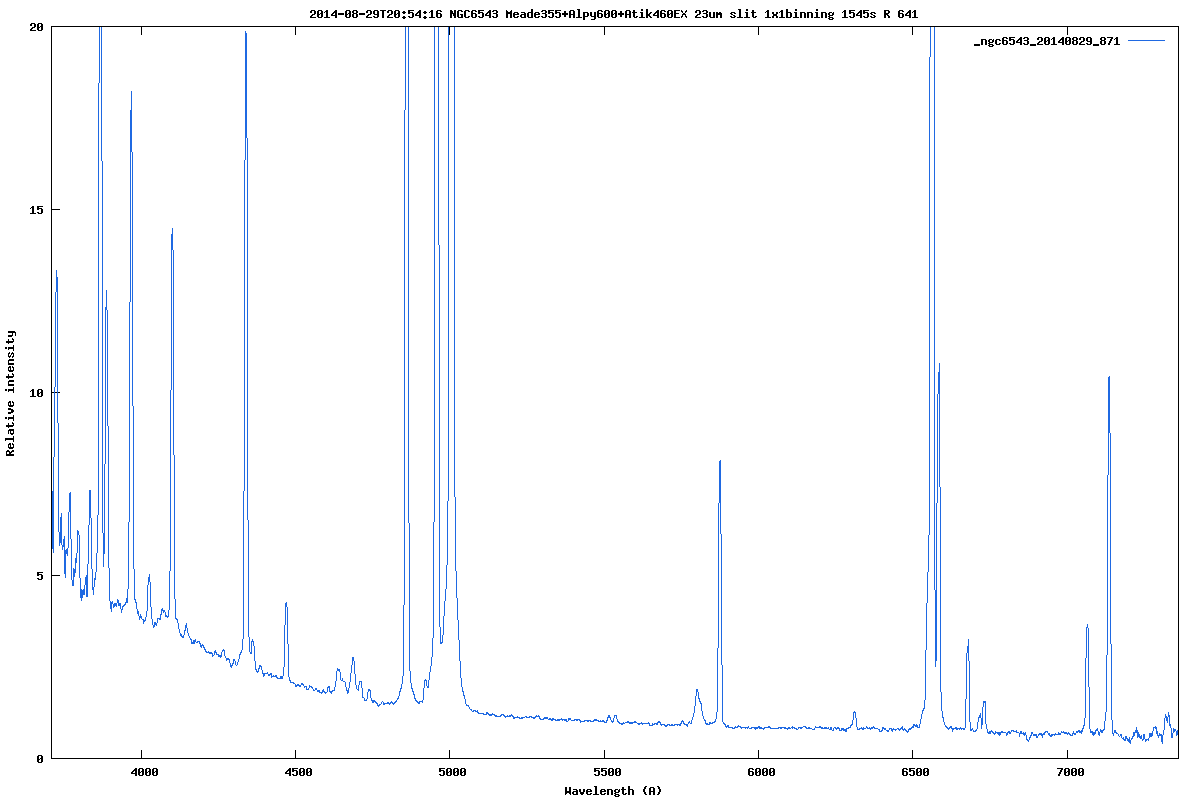

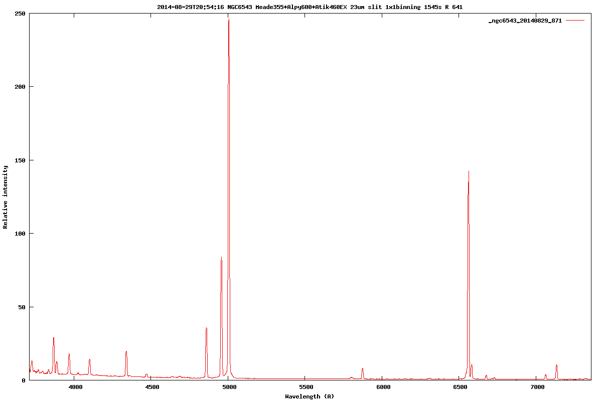

Re: 150 years after... observe a planetary nebula spectrum !
There were some stars between the clouds in the Brittany sky last night.
So it was the moment to honor Sir William Huggins !
NGC 6543
PS : I think Sir William would have been glad to work with an Alpy600
NGC 6543
Well done ! I was completely clouded out last night.
I did not expect emission lines in the central star too. Interesting

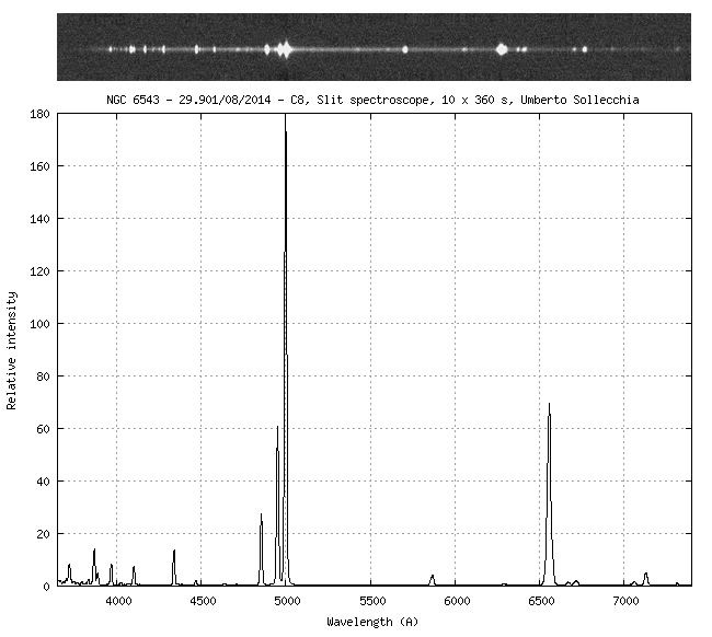

A spectrum from Italy! Waiting Umberto sign up to ARAS forum, I show his spectrum of NGC6543 taken on 29.901 august 2014 using a homemade low-res spectroscope (R~500):
Very nice initiative, thanks Filipe and Olivier!

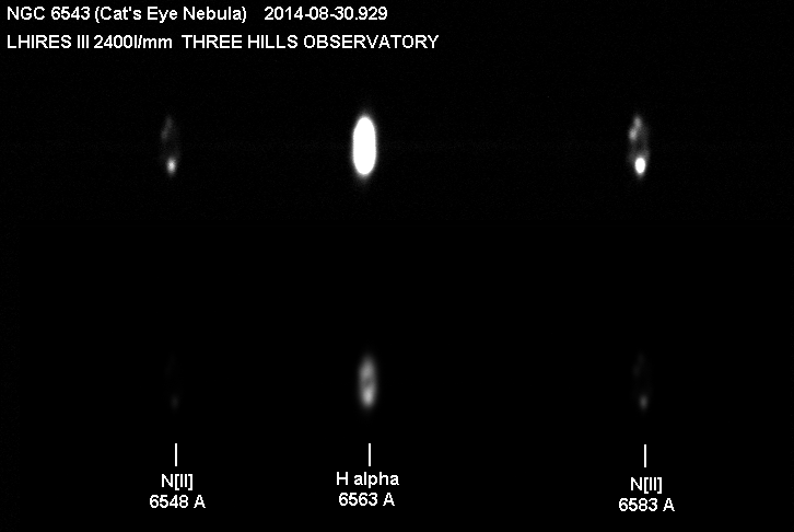

A day late but here are the H alpha/N[II] lines at high resolution with the LHIRES III
Some interesting structure due to various regions moving at different velocities

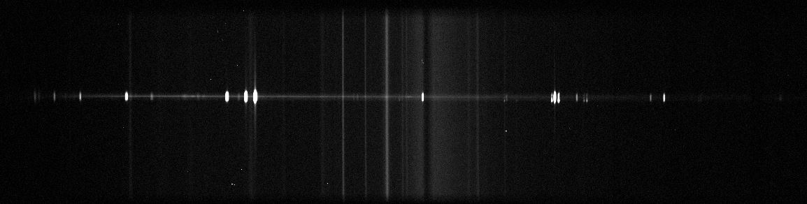

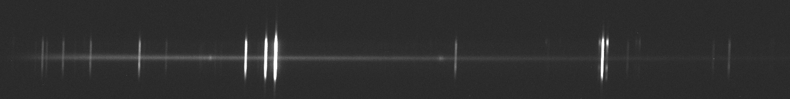

Here is my quick raw spectrum (sum of 30 60s exposures, dark/offset removed) taken tonight:
C11 (1600mm focal length), Losmandy Titan mount, LISA spectograph with Atik 460EX in binning 2x2, large 35µm slit.
A really nice planetary nebula with several structures visible in the spectrum!
http://www.shelyak.com/en/

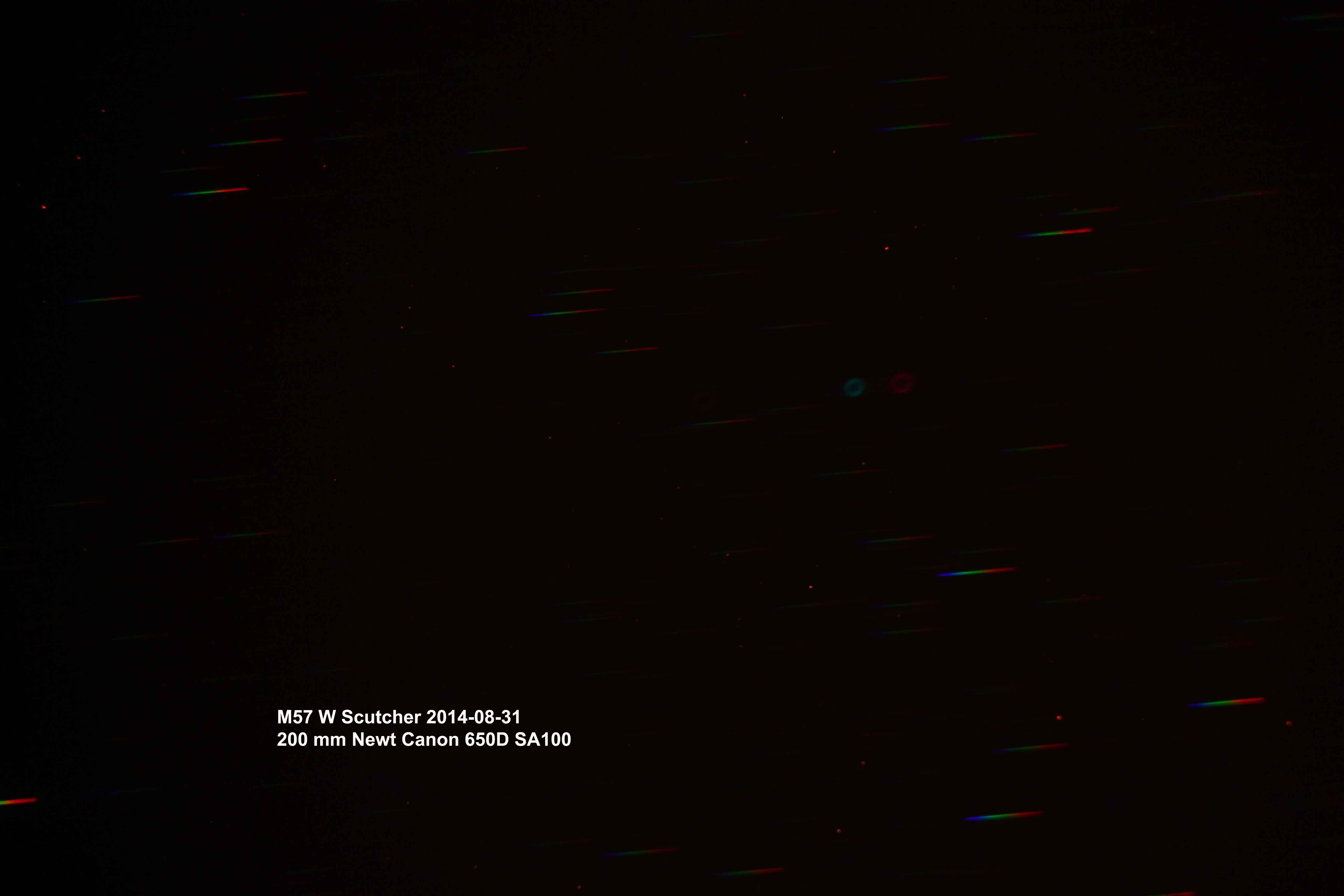

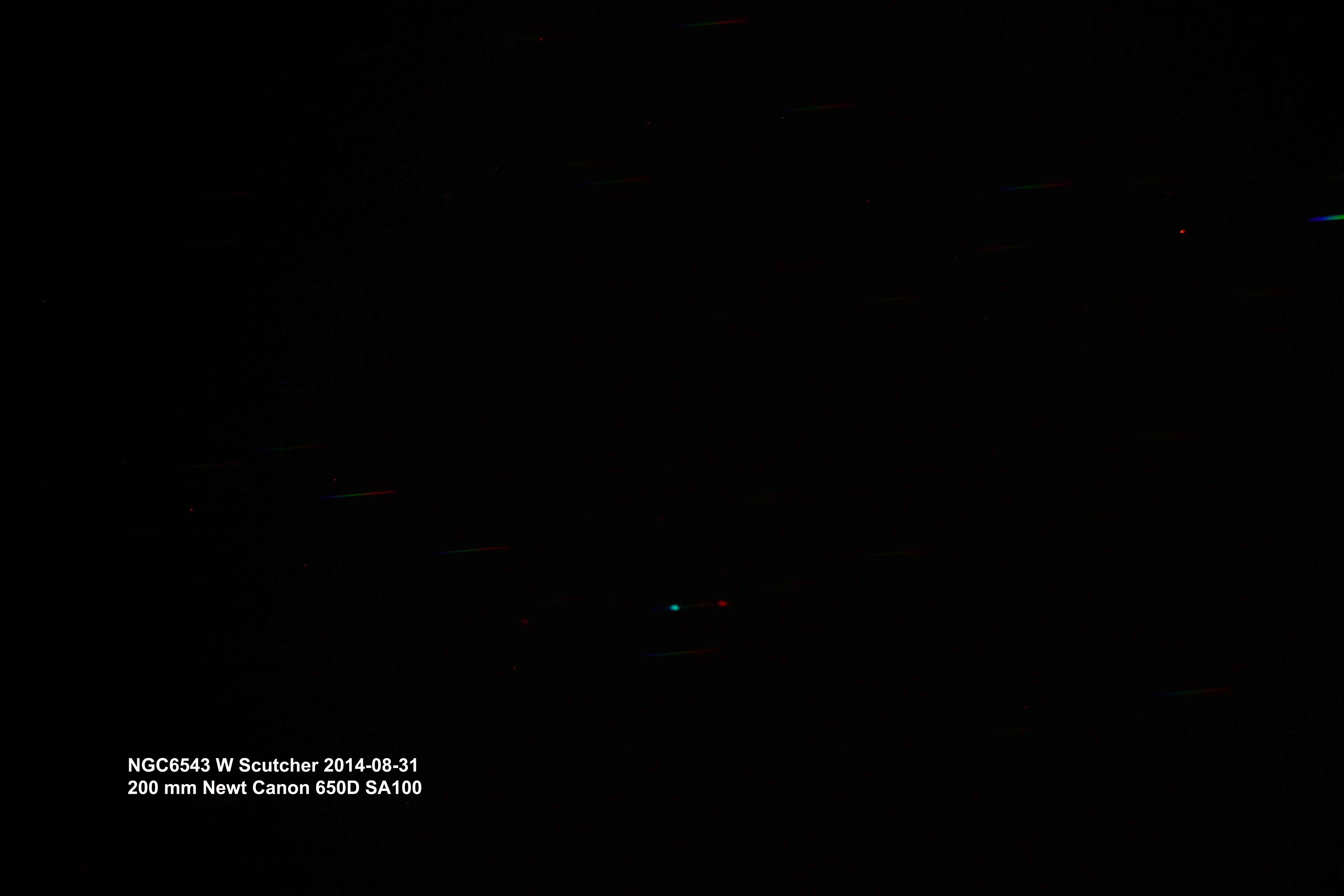

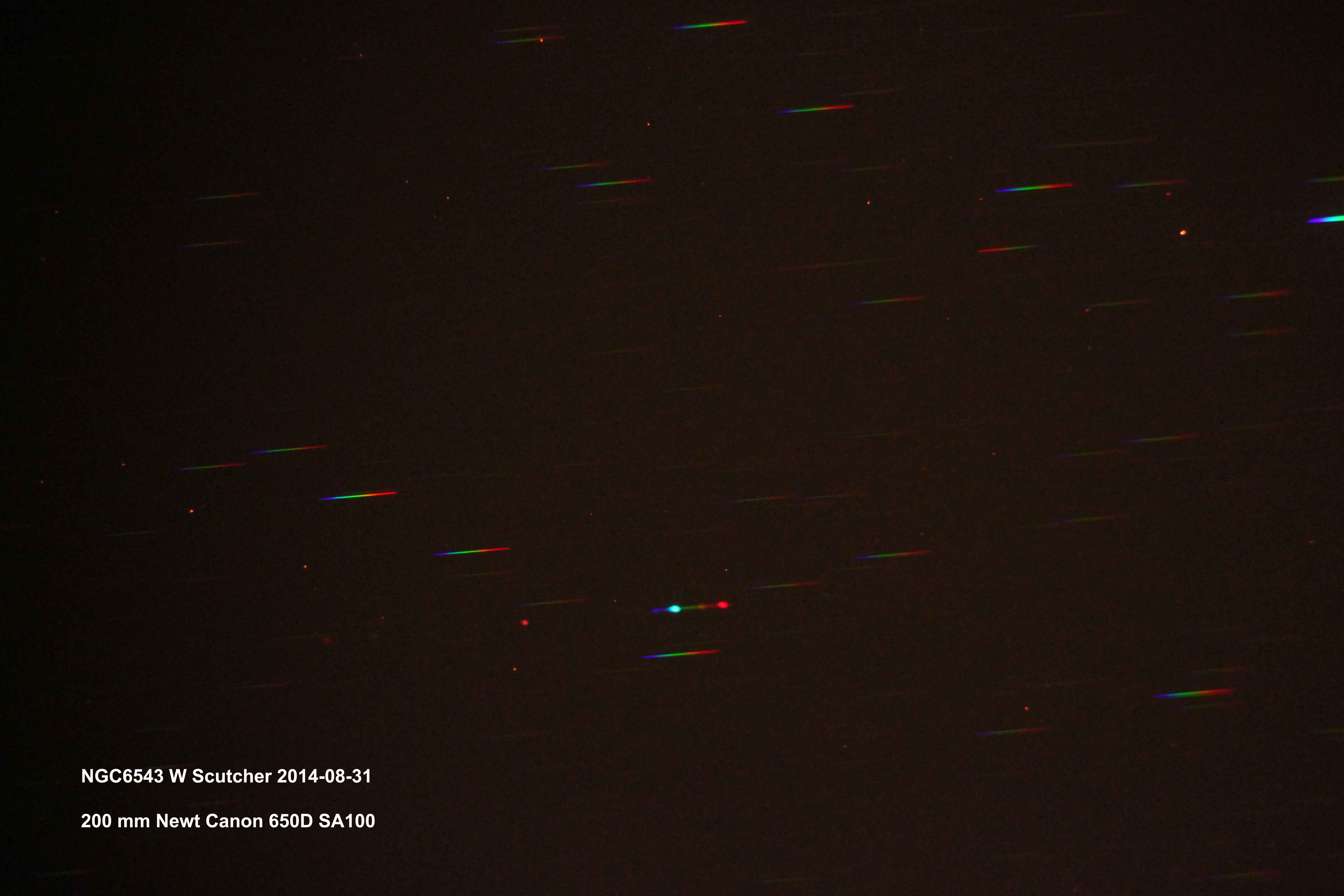

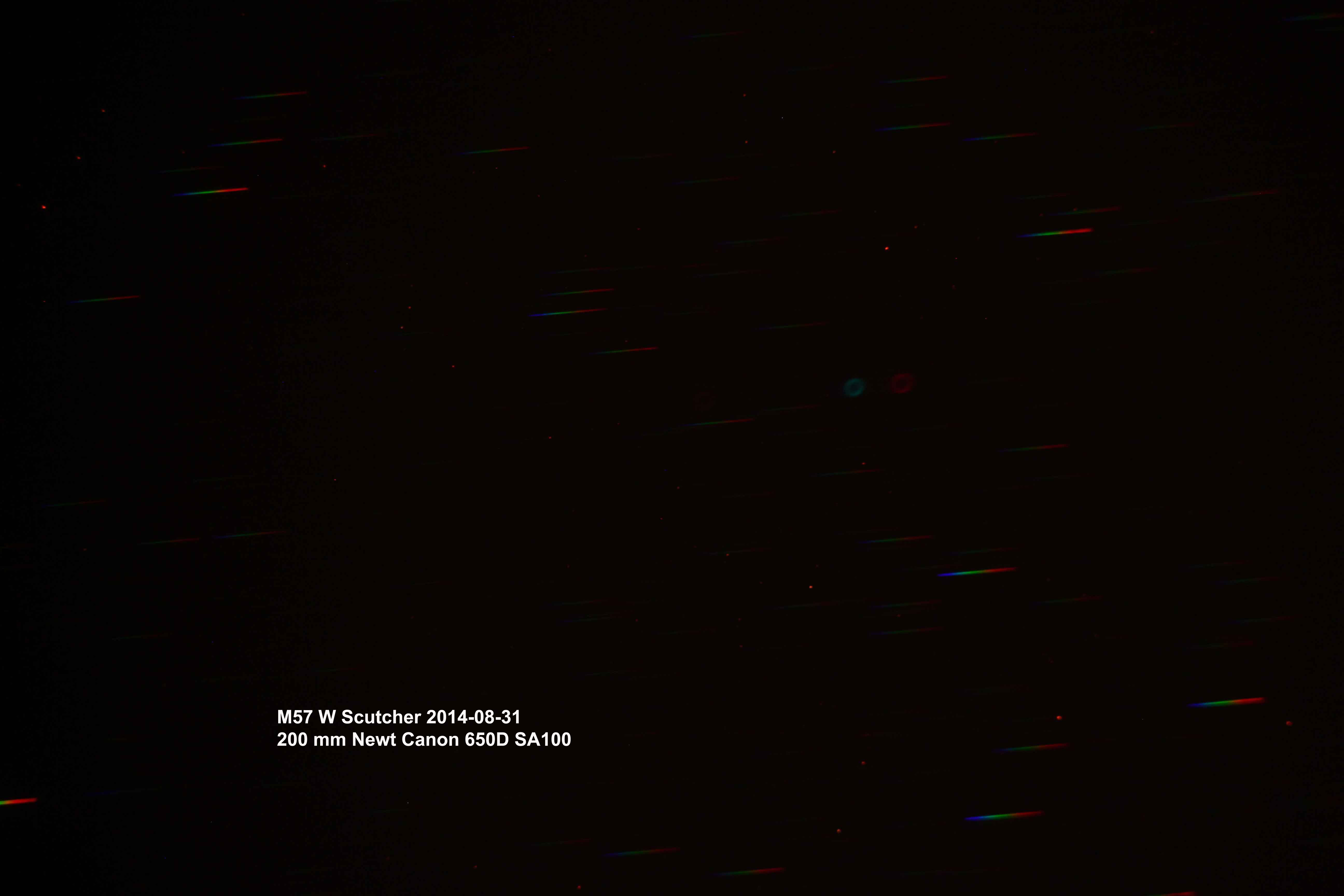

A bit delayed here are some snapshot spectra of NGC 6543 and M57 to celebrate the important anniversary. They were taken early on the morning of 31st August.
The pictures were taken with a Star Analyser 100 attached to a modified (filter removed) Canon 650D attached to a 200 mm Newtonian reflector.
Update. Now with pictures actually attached. (Thanks, Jacques Montier!)
All the best
Bill Scutcher
All the best
Bill Scutcher

Hello William,
Didn't you forget the attached spectrum ?
