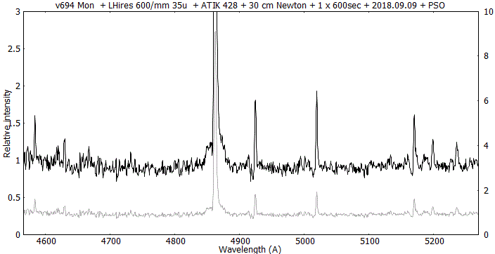

Opening the new season for v694 Mon: a fresh, lucky 1x10 minuter at the lowest level I can shoot v694 Mon from this morning - the P-Cyg profile has mostly vanished (a very rare state), uncovering a blue wing:
- Fresh 1 x 10 minuter
- v694mon_20180909_139.gif (14.71 KiB) Viewed 15418 times
Had to wait like 30 minute to rise above a tree, and had to move the next 10-minuter to trash because of too much sunlight contamination and poor guiding against rising sun.
The two wings confirmable visually on the raw image, and the removed background is a bit contaminated by the Sun's H-beta absorption (that is narrower than the wings).
I'd appreciate if somebody could confirm the existence of the blue wing, as once I've had hard times to prove such a validity for a professional.
