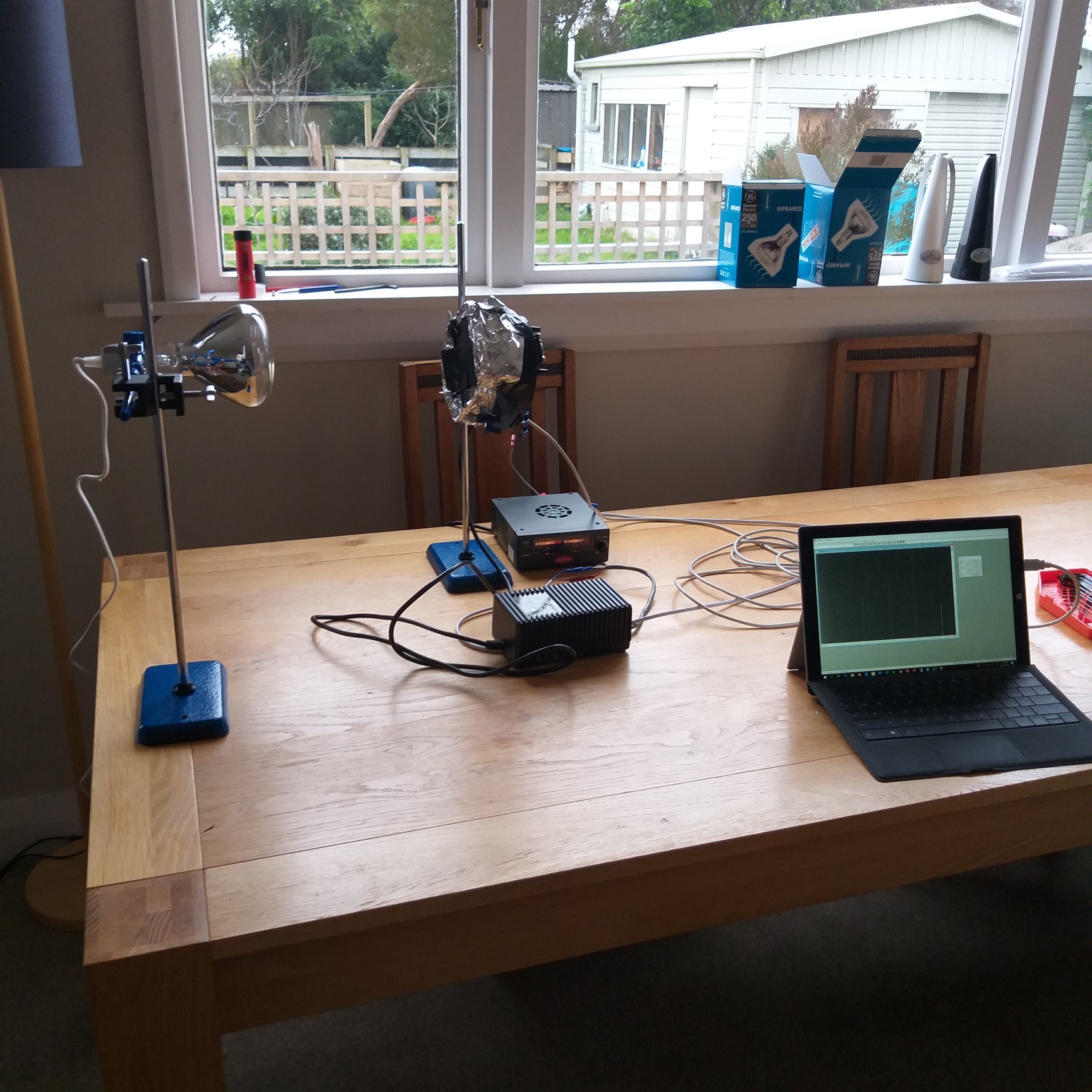

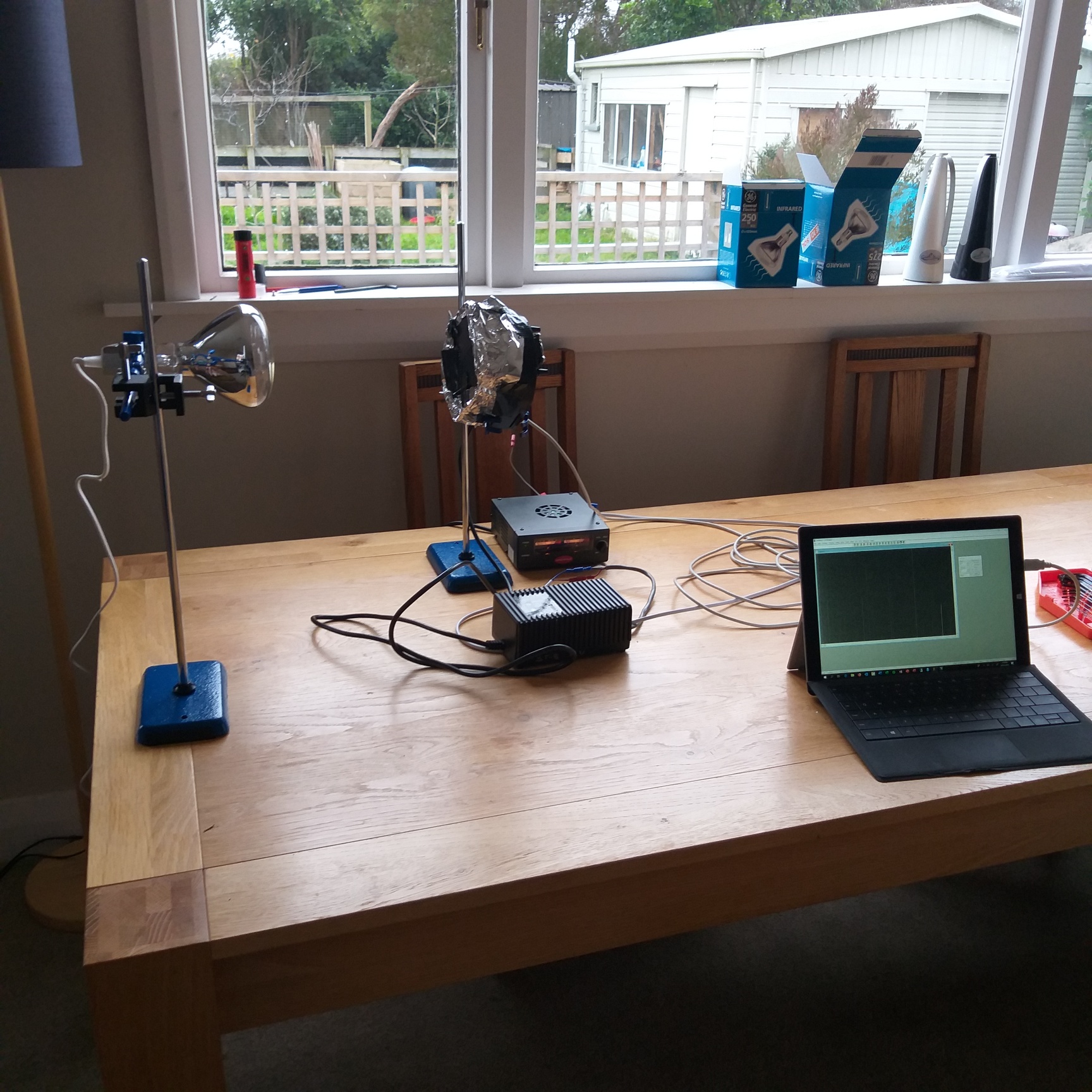

Hi Ibrahima,
I used a 275 watt infrared heat lamp at various distances from a CCD camera, which had the uvex cover over its aperture, and tinfoil around the edges to avoid leakage. Then I used an average of five measurements with and without the lamp on at 250mm increments between camera and the heat lamp, from 500 to 1500mm. The attached graph shows the excess counts at each distance when the lamp was on. It's not quite a square relationship because the radiation from the lamp is focussed into a beam by the lamp, which has a silvered rear.
Once you get to distances over about 1m the excess counts due to the lamp are down to under 40 adu.
My conclusion was that since there is highly unlikely to be an IR emitter within a couple of orders of magnitude of the power of the heat lamp near my setup when in use, at this level of transmission IR leakage is unlikely to be an issue. Though if I thought there was a problem I would make a tinfoil cover for the UVEX.

Hi Tom.
Thanks for the test and feedback. The results you obtain are very encouraging. I guess that you have used small exposure time for your measurements.
Would the ADU excess limit (35 ADU in your test) be larger if you consider long exposure times (300 sec or 600 sec) as we usually do in spectro? Or is it possible that, from a distance of 1.25m to the spectro, the ADU excess is only due to the thermal behaviour proper to the camera?
