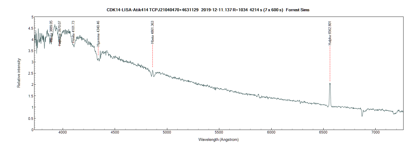

The bright WZ Sge-type dwarf nova TCPJ21040470+4631129 was discovered on July 12, 2019. There have been several rebrighenings and a second super outburst. See Atel# 12947, Atel#13009 for more details. A number of our ARAS group have been participating in the investigation by taking spectra and/ or photometry.
Dr. Vitaly Neustroev, an astrophysicist at University of Oulu in Finland has kindly asked for new spectra and BVRI photometry on this target as part of a continuing investigation. He reports that after having gone faint, this target is bright again with a magnitude of approximately 10.8 on 20191209.93. It is not certain whether this current event is a rebrightening or a super outburst. This event phase could end within days so quick followup is highly necessary.
So it should be a good target for Alpy, LISA and I would think Echelle spectrographs. Please submit spectrum to the ARAS database.
Per Eric W. Weissstein (http://scienceworld.wolfram.com/astrono ... fNova.html ) Dwarf Novae are a class of nova and cataclysmic variable that have multiple observed eruptions ranging in brightness from 2 to 5 magnitudes. Outburst intervals for each object are quasi-periodic, but within the DN family, intervals can range from days to decades. The lifetime of an outburst is typically from 2 to 20 days and is related to the outburst interval. DN outbursts are usually attributed to the release of gravitational energy resulting from an instability in the accretion disk or by sudden mass-transfers through the disk.
Please note that the artifact in my spectrum at about 4358Å is not real but probably HgI light pollution that I have not figured out yet how to remove from the spectrum.
Here is a spectrum I took last night with a Shelyak LISA.
Thank you.
Woody Sims
