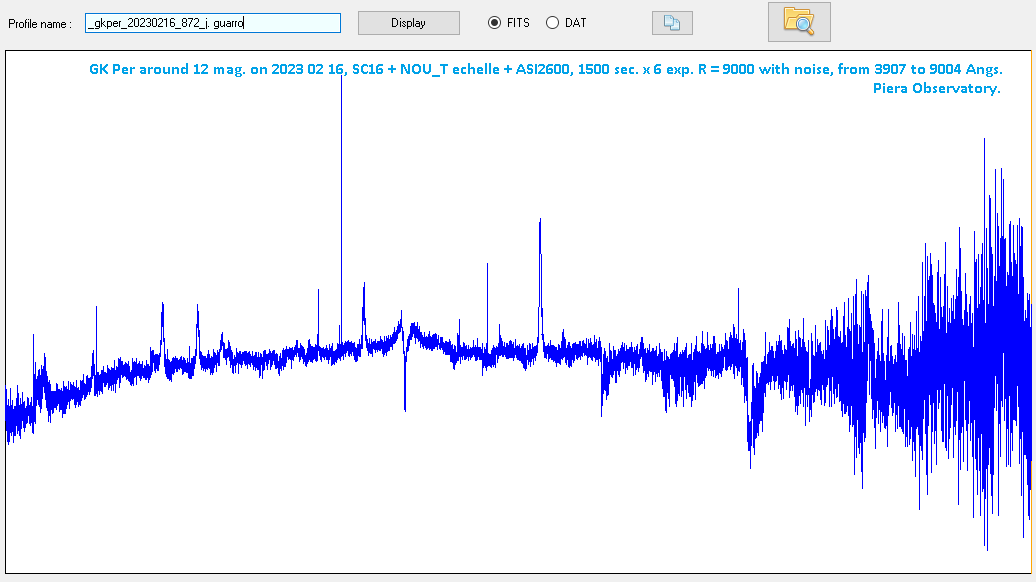

GK Per is in the boundary of my equipment detection, but it's possible that despite the noise the graphic would still be useful.
Cheers, Joan Guarro.
GK PER 20230216.png (33.08 KiB) Viewed 27521 times

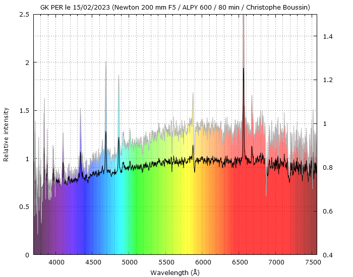

I obtained a new spectrum of GK Per with my Alpy 600 on 15 February at 20:28 UT (resolution of 520, JJ = 2459991.3942) with an acquisition time of 80 min (8 x 600s) :
GK Per on February 15th, 2023

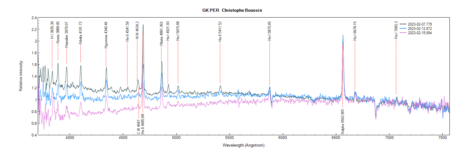

GK Per on February 7th, 12th and 15th, 2023 (identification of some lines from PlotSpectra)

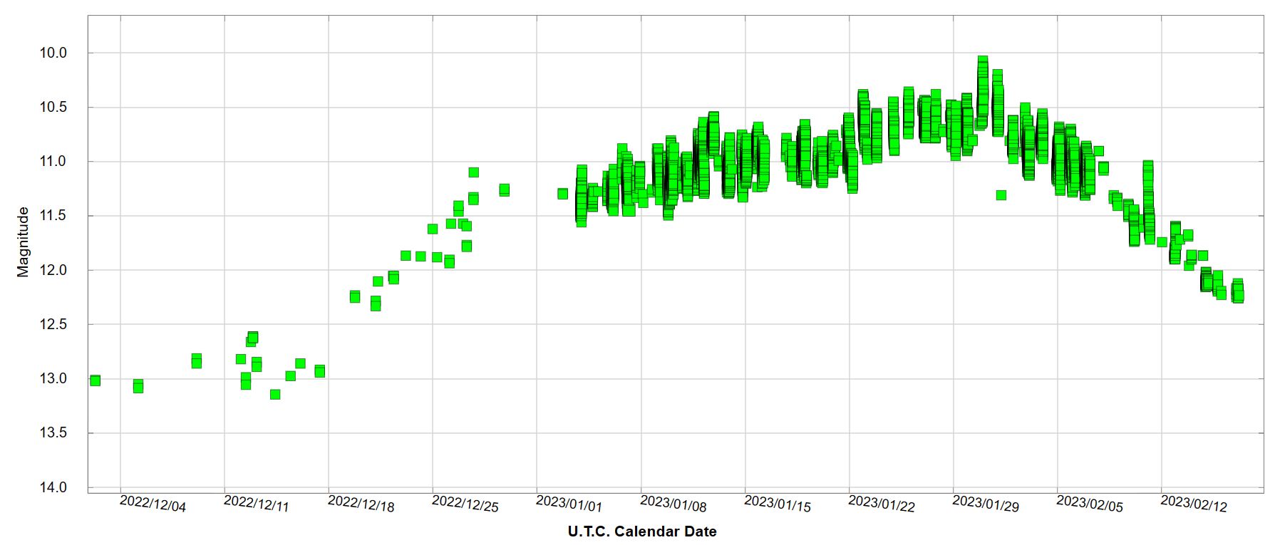

The evolution of the spectrum profile is compatible with the light curve :
Light curve of GK Per (Johnson V : green squares) (AAVSO)

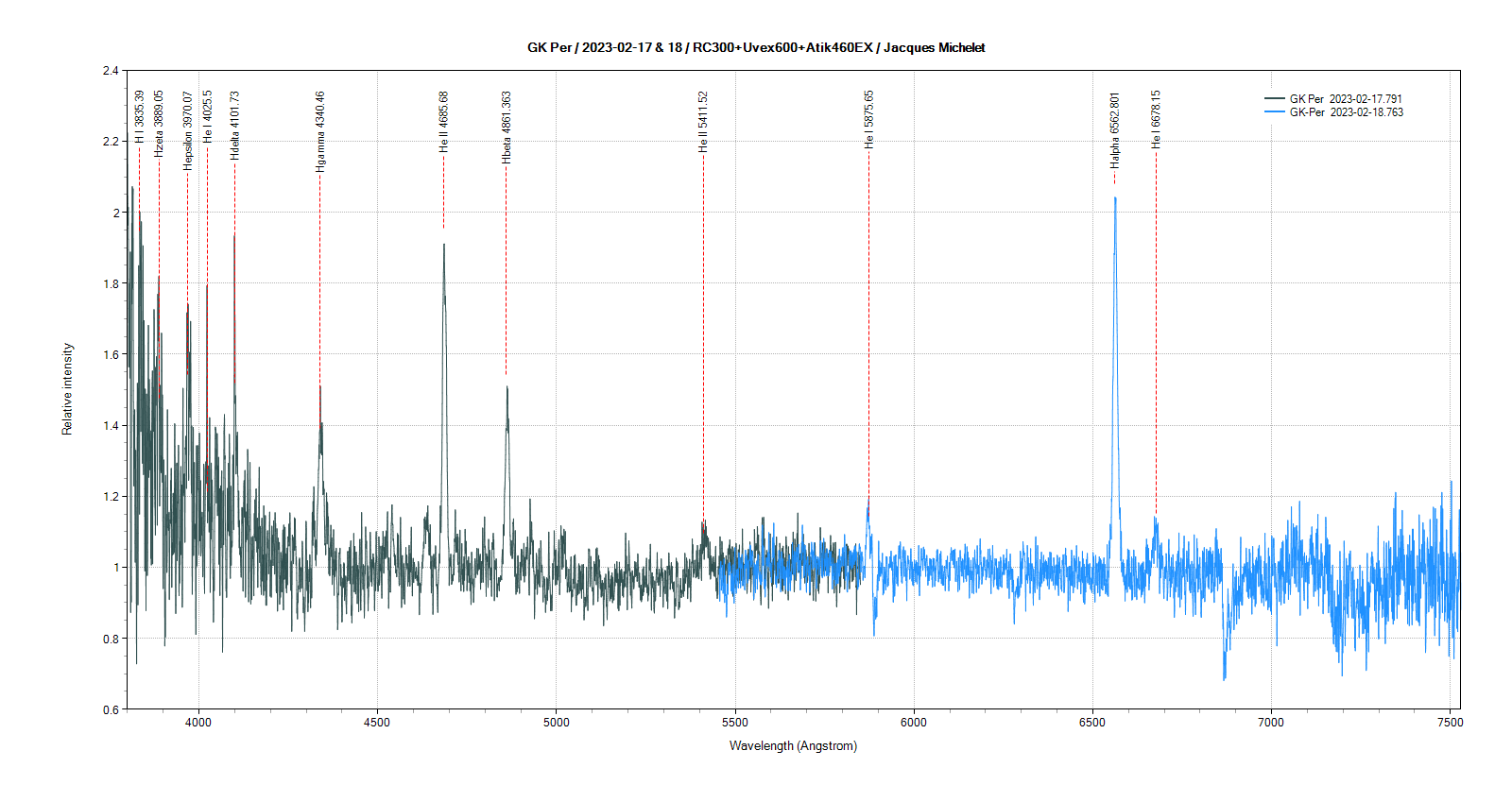

Another spectrum made in 2 parts, and in 2 consecutive days (I could not make it in one night, mist and clouds)
Regards,
