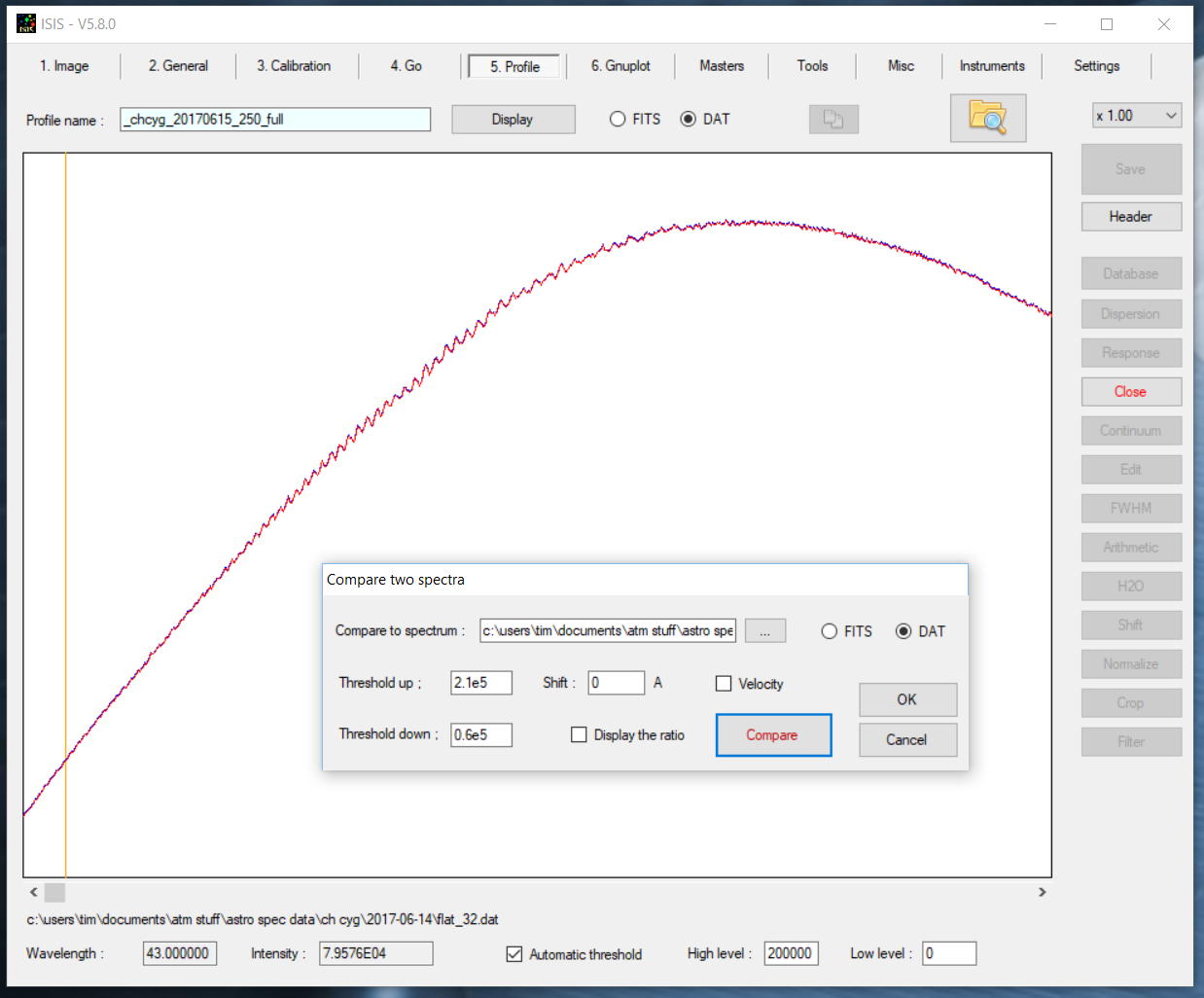

Hi Tim, I was looking at your flat blaze plots and at one level they are as I would expect. If the flat is indeed flat across the order (which it will be more or less) then you would expect more noise to show at the peak and drop off as the attenuation from the falling efficiency kicks in. You would also expect sampling a wider aperture to smooth it out. What does the noise look like after the blaze is removed?
However, your noise is not symmetric about the peek of the blaze being stronger on the blue wing. Is this the same across all orders or just the one shown?
It made me think it could be either PRNU or possibly fringes. Another possibility is that the trace of the order is not so accurate on the blue side.

Using a wide slit with ISIS (eShel mode) to make flat-field is not usual in fact (ISIS search to subtract the inter-order background). The problem can come from that.
How you exploit MaximDL for extract geometrical distorted flat traces.
Can you display a picture of the flat-fied or provide one. A spectral lamp image would also be appreciated (you use one, model?).

With MaximDL I have been looking at the flat_##.fit image compared to the flat_##.dat profile that ISIS generates not the raw distorted flat image.
I do not think the problem is the inter-order background subtraction.
Here is the profile in the cross dispersion direction for flat _32.fit. The inter-order region is quite wide and very near zero so ISIS has done a good job of removing the inter-order background.
and here is a profile generated in MaximDL - it is smooth, no ripple.
With the eShel mode I always get ripple no matter what binning I use all the way from 8 (the minimum allowed) to 20. Larger than 20 and the orders either side start to get included.
Here is the ISIS plot for a binning of 10 and 18 compared. They are identical.
However if I process the flat_32.fit image in ISIS as though it were a regular spectral image and generate a profile I get smooth profiles just like the Maxim profile.
This is the case with a "sky" subtraction zone set in the inter-order region or without "sky" subtraction.
I believe there must be a problem with the eShel processing. Could it be with the optimum binning routine? Unlike with regular spectra there is no option to turn this off in eShel mode.
At the moment I can't think of anything else that might explain the ripple.
I find the ripple quite concerning because it does not appear to be in the data. This may be happening to the star spectra as well as to the flats but just not visible for most spectra due to low S/N.

Hi Tim,
I think ISIS problem fixed.
The difficulty arises from the fact that ISIS can not find exact center of orders trace. ISIS eShel function is designed to work with optical fibers, i.e. narrow order. You are using a wide slit along the spacial axis and ISIS is here struggling.
It is easy to simulate your default from the command line (Tools tab). You can use your flat_32.fit image. Enter the command:
l_opt flat_32 p 25 33
(25 - 33) are the binning coordinate along Y-axis.
Display the p.fit generated profile. You can observe the ripple.
L_OPT is the function used for eShel processing, but the problem is the same is you use a simple binning:
l_add flat_32 p 25 34
If the binning zone is centered on the trace, all is ok:
l_add flat_32 p 32 38
or better, is you include all the trace signal (similar to your maximDL test):
l_add flat_32 p 28 46
This edge problem on the trace comes from the interpolation algorithm when geometric correction is applied (banding correction), here a spline interpolation (cardinal spline) that does not work perfectly in your case. It is easy for me to provide you a ISIS version with bilinear interpolation, less sophisticated, but which will produce less artefact.
But before, it is important to verify that ISIS does not correctly find the trace of the orders. I recommend that you look the check.fit and check2.fit images and control the overlay of the trace found by calculation and the actual trace (select "Rotation test" before). Details are here:
http://www.astrosurf.com/buil/isis/eshe ... chelle.htm
Try also to modify the "Order detection threshold".
Give me the result, the solution is close!
Tim Lester
Posts: 168
Location: Arnprior Ontario
Post by Tim Lester »
Christian,
Thanks a lot for your help so far! We are close.
I had initially used the check,1,2.fit images to make sure ISIS was finding the orders correctly - it was.
I repeated this and confirmed that ISIS is finding the center of the orders perfectly and fitting a very good line. I did this for a variety of detection thresholds, always with excellent results.
In any case the straightened order images (flat_##.fit) that ISIS produces are all perfectly centred in y. This must be confirmation.
I do not think the problem lies with ISIS not correctly determining the center of the orders. It seams to be doing a very good job.
However,
When I process with a binning of 12 then flat_32.dat shows ripple. A binning of 12 is more than enough to capture the whole order in the y direction.
(Note that I had accidentally uploaded a double size image for flat_32.fit - sorry! The link: https://1drv.ms/f/s!AvXqhKI5kEGRlhO4W57pp4yk6pWN
now has the correct flat_32.fit image. I have also uploaded a tung_check overlay.)
The center of the order 32 profile in the y direction is 18.
IF I process flat_32.fit with the command: l_opt flat_32 p 12 24 (a binning of 12 centered on 18) then I get the identical rippled profile (perfect match).
BUT if I process with the command: l_add flat_32 p 12 24 I get a well matched profile but with NO ripple.
Surely this means that the optimized binning is causing the problem and not the interpolation method.
