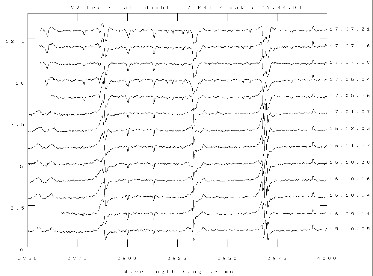

Finally, managed to reduce Alp Ori (taken last year), by norming to 1, then subtract 1 (0 average), then multiply by 1/6 (0.1666), added +1, then used this spectrum (shifting by correlated velocities) to divide all the normal spectra. Tried to use a larger ratio than 1/6, but met with less straight continuum (all used ref.star 7 cep, even Alp Ori itself corrected).
Having Alp Ori reduced, generated now this graph (contninuum rectified to 1 with a lengthy selection of tiny regions) using iRAF/specplot:
Again, all spectra are normed to 1, having step 1 in between.
EWs of TiII 3900, 3913 increased from 0.1 to 0.5 with a very high variance (0.15), unable to determine the gradient. Better to look at the above graph how the lines widening.
Also made +2 weekly shots in the meantime (and, I won't be able observe for 2-3 weeks from now).
At least, some trends can be read, by theory - inserting shorter periods are helpful to see variations, I believe CaII doublet + H5, H6 are varying on a very short timescale (few days).
Of course, there are lots of details that could be done differently, and have measurements of M component radial shifts (40 km/s common difference - with a +/- 7 km/s variance) to do the reduction at the lowest error. Only the fixed chosen constant of 0.1666 that is a very rough guess (based on material from 2015) and would be very tricky to measure per-spectra.
