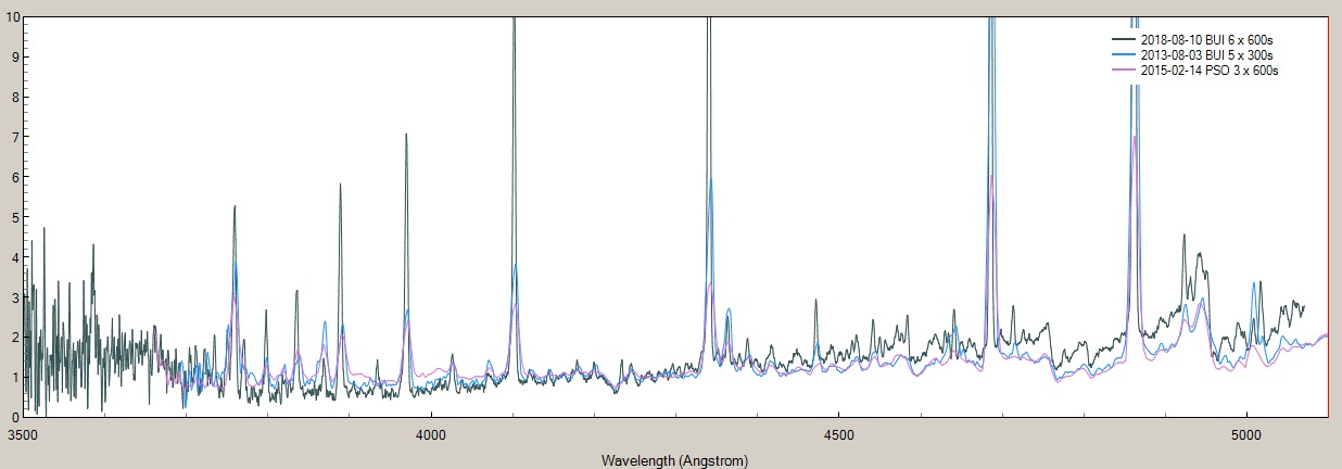

A recent spectrum of symbiotic variable star CI Cyg : zoom on blue/near UV region by using UVEX2 prototype (R=1200) :
For lambda < 3680 A, the flat nebular continuum is well detected. Up to 3680 A we observe the red continuum from the cool giant.
I confirm high-ionization forbidden line detection of the Fe VII at 3586 A (far UV for amateurs in fact !). Also the weak Fe VI at 3905.
These lines seem associated to a colliding winds between hot component and the red giant. These lines are emitted by the outer atmosphere of the red giant, illuminated by the hot component. The corresponding electronic temperature is 10^5 K or larger.

By changing the ASI183MM camera by a ASI1600MM I can not explore the spectrum down to 3400 A and detect the impressive forbidden Ne V at 3426 A
We explore here unknown spectral region for amateurs.
The ASI183MM model severe cutoff is just below 3500 A... for future observation (next UVEX proptotype) the use of CCD camera is a necessity (ATIK460/414 sensitivity is proved down to 3200 A). The actuel designed interface of UVEX2 is not compatible with Atik CCCD camera... :-(

C'est une très bonne démarche Pierre ce type de comparaison.
Mais on n'est pas vraiment dans le même catégorie d'instrument (Alpy600 couvre par exemple plus aisément la partie visible, mais avec une résolution inférieure- surtout que tu compare ici avec une version "boostée" de UVEX avec un réseau de 1200 t/mm).
Mais clairement, en dessous de 3800-3900 nm, Alpy ne peut plus donner d'information valable.

Hello Pierre and Christian,
I believe the comparison is not fair.
Firstly, Alpy 600 does work down to 3700A (not 3800-3900A) with Newtons:
Note that I had a 10" Newton with an Orion G3 camera (8.6 micron pixel size) that time, and had wrong practice focusing the Alpy correctly especially in the blue.
But, the continuum till 3670A have always been had the right curvature (of course Alpy degrarded resolution, and need careful processing to avoid filtration here).
For Vega, I can detect signal down to 3550A... (signal cut seem to star at 3700A)
Also must take precautions at flat taking (I believe reflections are coming up below 3700A, and ref.star must also be at good quality in this region, and must be treated precisely).
Pierre,
- the C8 (and higher) to have optimal usage with Alpy, you most certainly have added a focal reducer. I see it for all Cxx instruments + Alpy users, they have a hard end only at 3800A or so (see database - newtons work down to 3700A with just more or less noise, depending on effort...)
Some of such reducers already reported problems below 4200A earlier.
- the 5 min exposure is low for no reason. For the Alpy (when the core element is firmed correctly), can maintain calibration for hours... (unlike LHires where 5 minute is reasonable) It is *ALLOWED* to let the H-alpha burn in, till you notify the database owner anyhow. I prefer zeroing H-alpha out (ISIS -> Edit tab) to really prevent its use. When weather allows, just go up to 20 minute when shooting faint object. However, reaching 3700A with the Alpy I saw working only with Newtons (see database).
Christian,
Congratulations for the UVEX2 !
Yes, I was also suggested by a professional to use Alt/Az for full spectrum use (and did start on yahoo such a discussion thread in the past already).
When I mentioned my setup has short focal length (300/1200 Newton: only 1200), I was also told I can try to operate in the zenith. This is essentially what I'm doing for ARAS symbiotics since then, to make sure ref.star calibration works, and for simplicity.
To operate at lower levels and get the ref.star calibration correct, maybe the wide slit is the right solution for EQ mounts, as already noted by others.
When you optimize the guiding for throughput with the narrow slit, I suspect the guiding won't be fully reproducible by practice (guide optics not errorless - random reflections come up when star is getting off the slit). It was nice to get the UVEX2 to work at f/4 rather than f/8 RC, then the athmo. aberration also gets halved, and yet useable when operating in Zenith.
